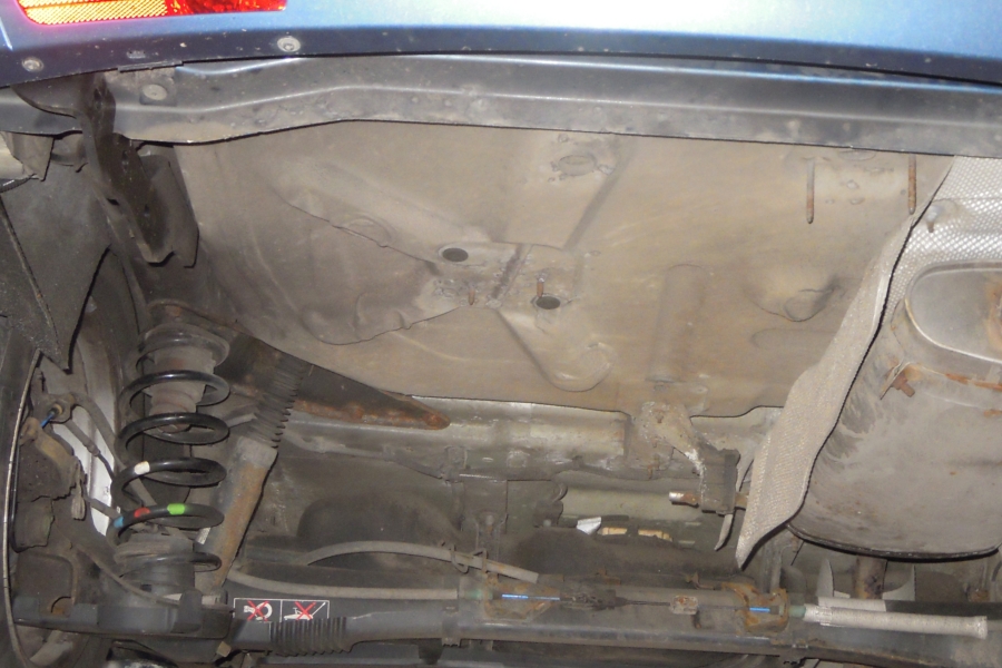

To my surprise, and delight, I discovered that our car already had the mounting studs in place.

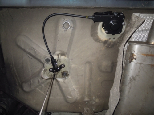

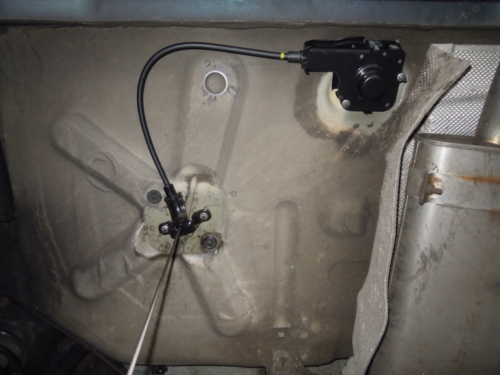

Installation was simply a matter of cleaning off the paint and underseal from the first 30-40mm of thread and fastening the mechanism in place with the 4 nuts in the kit. It pays to wind a plain M6 nut up and down the threads with a generous amount of penetrating fluid until it can be turned with the
fingers otherwise the nuts provided can easily be cross-threaded!
Own Copyright - Old-Guy
I had to bend the rear-box heat-shield for easy access to one nut, but it bends back into shape easily enough - this may keep some of the crud off the 'winch'.

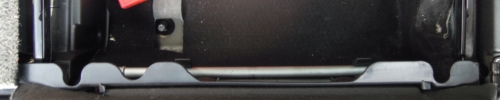

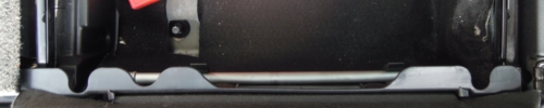

The extension won't fit in the foam 'tool-box' under the O/S middle footwell, but I discovered storage clips for it in the O/S row 3 seat stowage well.

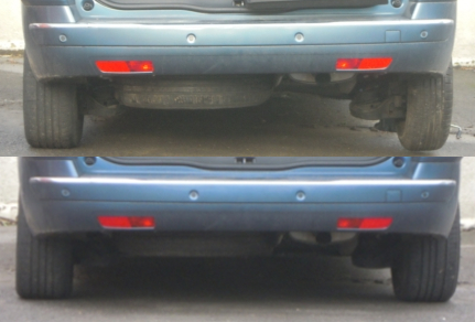

As a temporary measure I have a Xantia spare (185/65R15 on 5.5J steel rim) slung underneath - its rolling diameter is a little smaller than the Picasso's 215/55R16 with a spare Xantia Jack in a bag in the boot. The Xantia jack fits the jacking points perfectly, but I suspect it wouldn't go under the car if a tyre is completely flat. As the 'correct' jack is so expensive (the prices above are typical eBay) and there's no guarantee it will fit the storage, I'll look for a 'universal' jack that fits the jacking points without damaging the under-seal or paint.
The Xantia spare hangs no lower than the rear suspension cross-piece, but does slightly compromise the ramp-angle so a little care is need with monster speed bumps, car-park and ferry ramps. This composite picture shows (top) the Xantia spare on the O/S/R (still jacked on that side) with the standard wheel stowed in the spare position, and (below) my 'normal' arrangement with Xantia spare stowed. Without any wheel stowed in the spare position, the tailpipe is the lowest point at the rear.
The Xantia tyre is 185/65R15 and the standard Picasso 215/55R16 so the standard wheel further reduces the ground clearance by 30mm.
