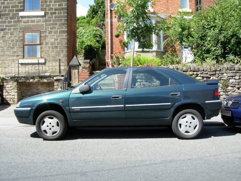

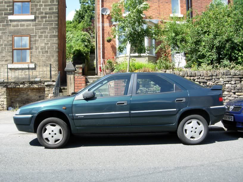

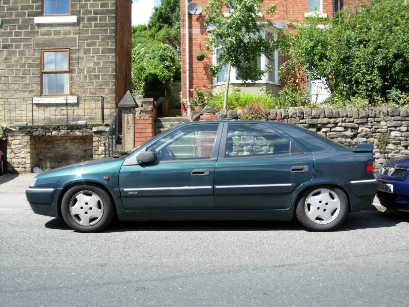

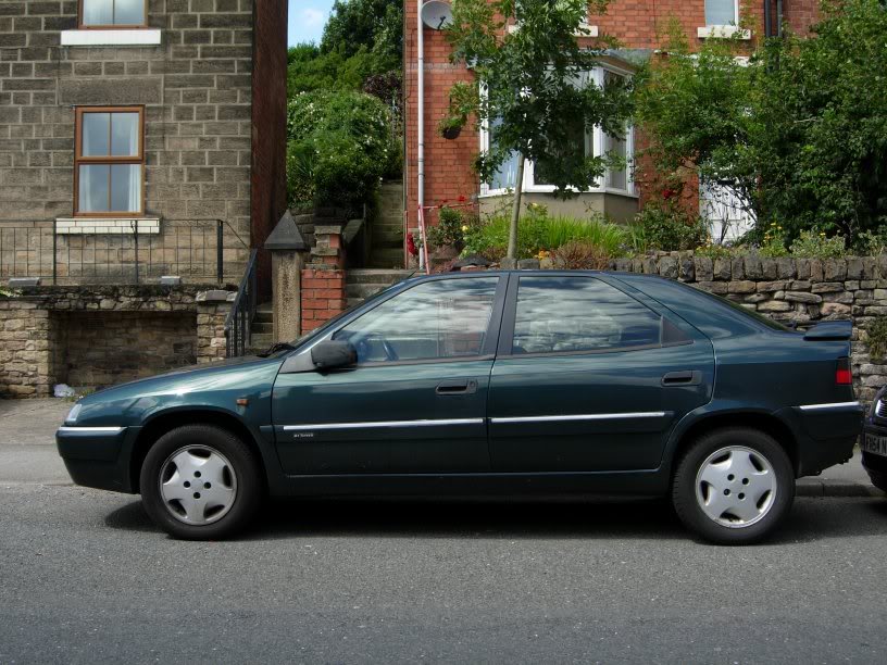

I've stuck some pictures in here, could anyone tell me if it looks right for each setting:
service low:
normal:
high:
service high:

It does look a little high on the second picture - is that supposed to be Normal height?
The third and fourth pictures look identical heights - are they supposed to be High and Highest settings?
What I noticed with my car is that I couldn't achieve "Normal" height when the front height corrector arm disconnected itself. If I was in Low and asked for Normal, the front would stay low. If I was in Highest and asked for Normal it would sink to High and go no lower. After sitting overnight over sinking a bit, the ride was closer to Normal.

Looks a bit tall to me in the normal pic and I'm sure mine sinks lower than that in the low pic, high looks about right though. On mine there is no noticable difference between the two high settings either.

Your car is too high in the normal setting as most folks above say. It is a bit too high at the front and far too high at the rear. You should be able to see pretty well all of the tyre at the rear but not all that fresh air above it!

The second picture - normal height - is definately wrong, but only at the back. I think some people are getting tricked by the different lighting of the second picture compared to the rest which is making part of the wheel arch above the front wheel almost invisible, (black) making it seem like there is too much gap between the wheel and the guard.duckmonkey wrote:I recently starting comparing the ride height on my car to other Xantias that I've seen about and I've now convinced myself than mine is too high when at normal height. Also there doesn't seem to be any difference between high and service-high, at least there is no noticable movement when switching between.
When I boost the gamma of that photo so the wheel arch is visible the front height looks exactly right to me (by eye) but the back height is definately way too high, probably by about 40-50mm, which will definately cause poor ride at the rear. Rule of thumb for the rear is that the guard should be in line with the edge of the tyre.

The difference between the two highest settings is quite subtle.
Intermediate height (which you have labeled high) is most of the way up and just gently touching the limit stop snubbers - you should still be able to press it down a bit but it will be quite stiff. This is for fording flooded roads at very low speeds.
Maximum height (which you have labeled service high) just opens the height correctors fully and puts full pressure into the suspension - in this case it will be completely rigid and bounce on the tyres. (Never drive like this even at extremely slow speeds)
It's somewhat normal for there to be no change going in the direction of maximum down to intermediate height.

A rough rule of thumb is that, when the car is on level ground and is in the normal position (with the engine running), you can get three fingers between the front wheel and arch, and one finger between the rear wheel and arch. It is not unusual for there to be no apparent difference in height from high and service high.
