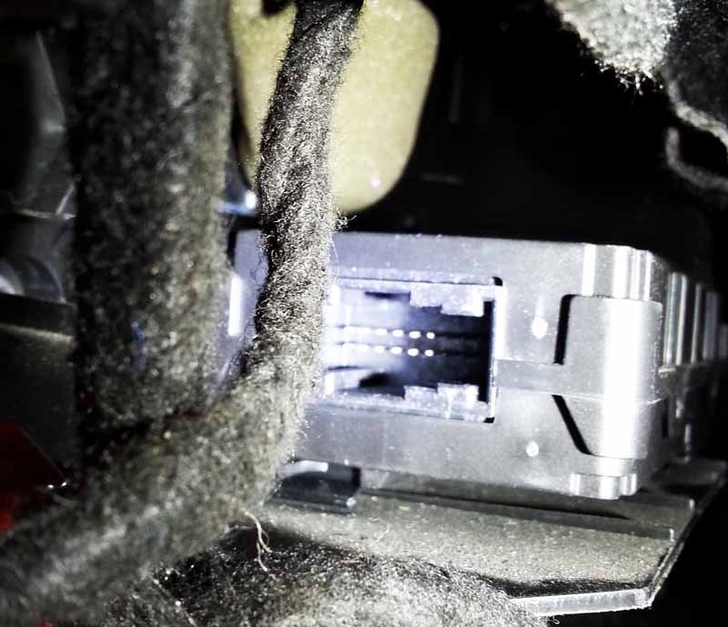

Sry about the quality of the second photo.....
I have to go in again (no feed to indicator?) so if you need I can try again

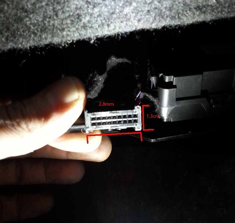

The first one is a good lead ... what about the connector dimensions, with that I could be certain to order the exact connector I need (there are some variants, very similar to each other) ...

I will measure it for you

We're talking about the connector, right? ...Stickyfinger wrote:I will measure it for you

yep we are.....the "other" would just embarrass you

2.8 should be cm

I'll check with the connectors that might be available, if their base looks like in the photos, I'll take a chance and get one, hopefully with enough extra existing wires to connect the ECU to the car and see if it actually works (if it doesn't, no point in ordering the TPMS antenna, right?) ...

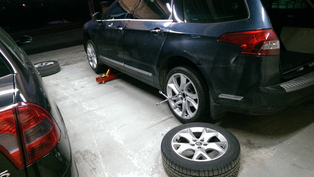

Now we're making some progress .. the security bolts are off, new ones fitted in ... didn't have to pay a thing ... the weather is quite nice today, and I'm looking forward to fitting the 19" on the car by the end of the day
vborovic
- Locked user account
- Posts: 1750
- Joined: 31 Oct 2013, 17:07
- x 40
Re: C5 X7 ambient lighting (and some other bits and pieces)

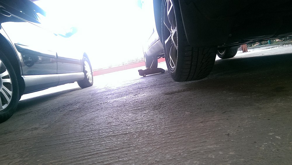

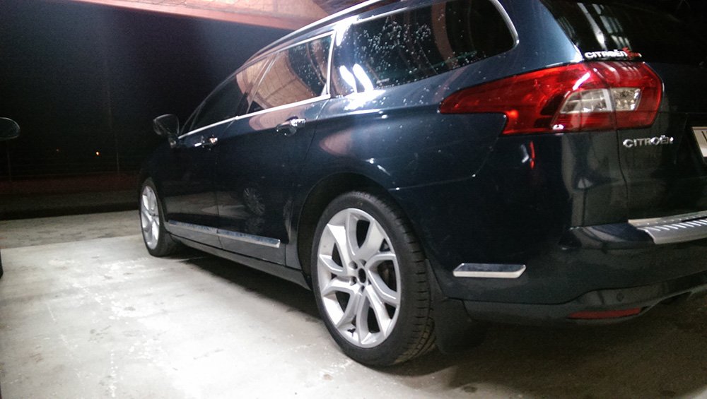

The 19" are up ... managed to jack the car on one side high enough to be able to replace both wheels on one side. The center caps are missing, but they're on their way. Before doing a test drive, I've changed the ABS/ESP ECU settings to the newly fitted tyre size, just to be on the safe side (and yes, teleconfiguration works properly on my DiagBox V7.82 - I just lost the display language to english - it was croatian before 7.76 I think - but that doesn't bother me).
The test drive went OK, and here are my findings after 10 miles (taking the daily road to work, that I know like the back of my hand):
- the steering wheel is heavier (logical), and I like it better this way
- the road noise is different, sounds a bit dampened, but the noise level would be on par with the previous 17" Nokians
- the car feels stiffer, but the comfort isn't lacking in any way (if this makes sense to you)
- the road bumps now create a more dampened thud, compared to the sound the previous wheels made (less noise though)
- the horizontal damage on the road (including potholes, shafts, ridges etc.) is less pronounced with the 19" - this definitely was a pleasant surprise
Overall, so far, I'd say the ride quality is even better than it was before, since the 19" absorb the horizontal problems with less stress ... the car feels sportier (personal preference will be the judge of this) ... I don't feel I lost anything on the Citroen comfort (remember: non-hydractive in my case) ... now, why is this so, is it the sheer wheel size, the Michelin PA3's or a combination of both ... I don't honestly know ...
For those few that are wondering, about the weight gain ... the old wheels measured 22,3 kg each ... the new wheels are 24,5 each ... not bad IMO ...
