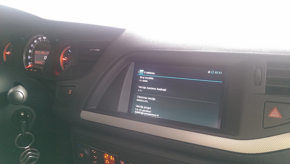

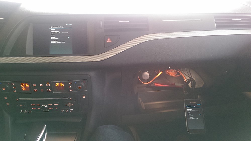

Now we're getting somewhere ... I've purchased a second Galaxy S (used), but this time not the Plus model (i9000, rather than the i9001) ... and the tv-out works (with the Nokia video cable, no modifications necessary), and it even came with the CyanogenMod 10.2 installed (Android version 4.3.1.) ... now, back to the initial issue ... it would be great if:
- the phone would turn on automatically (if shut down) when the power comes to the charger (although not crucial)
- I could set the OTG cable, to have it both charging the phone and have the touch-screen panel connected via USB (I've read somewhere that only USB 2.x devices are supported with the OTG, so that potentially won't work)
Some initial photos are below ... I'm planning to have the phone fixed in the passenger glovebox, so that I can get both good GPS reception and an accurate GPS readings.
