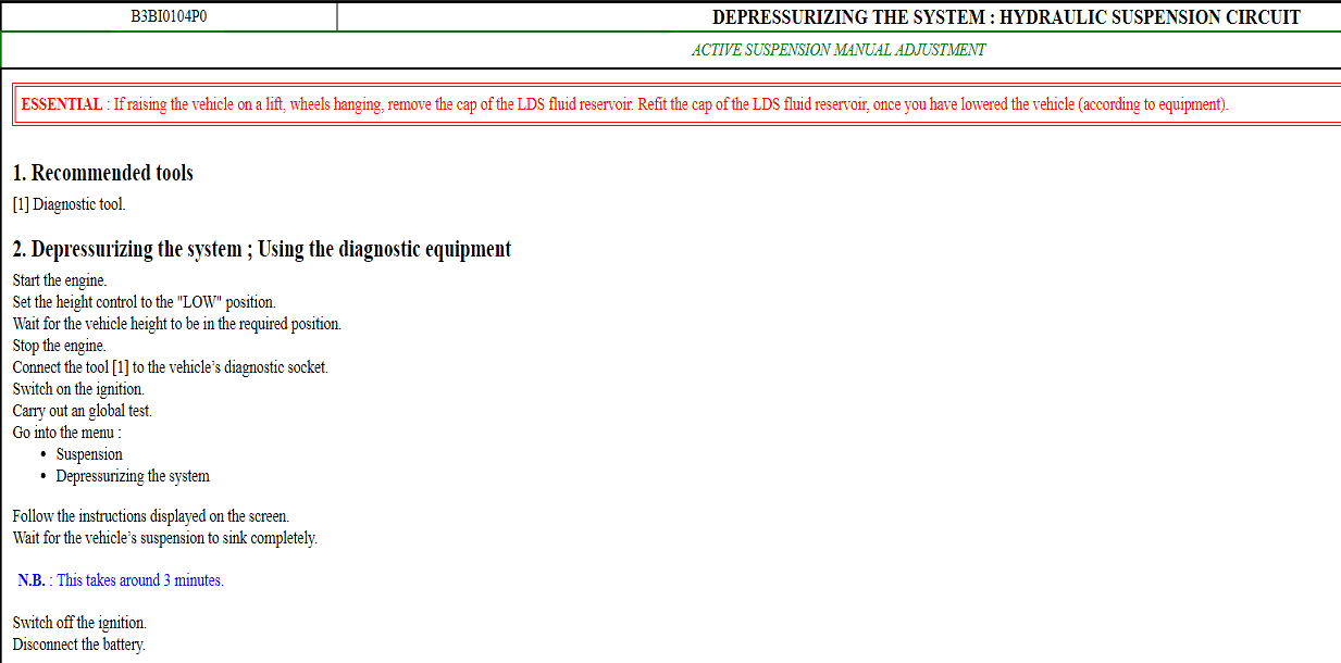

De-pressurising the Hydraulic System
Recommended tools:
Lexia Diagnostic Tool with Diagbox
Depressurizing the system; Using the diagnostic equipment
Suspension
Depressurising the system
Follow the instructions displayed on the screen.
Wait for the vehicle’s suspension to sink completely.
N.B.: This takes around 3 minutes.
ESSENTIAL: Any LDS fluid recovered must not be re-used.
N.B.: The suspension can be depressurised on each axle individually Collect the LDS fluid so as to keep the working area clean. Respect the environment.
Re-tighten both bleed screws after the system has fully de-pressurised.

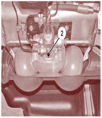

Draining / Filling / Bleeding the Hydraulic Suspension Circuit
Draining
Open the cap of the fluid reservoir LDS.
Remove:
Refilling

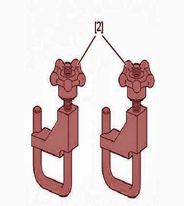

Couple the hose (2) on the LDS fluid reservoir.
Refit the clip (1).
Remove the tool [2].
Refit:

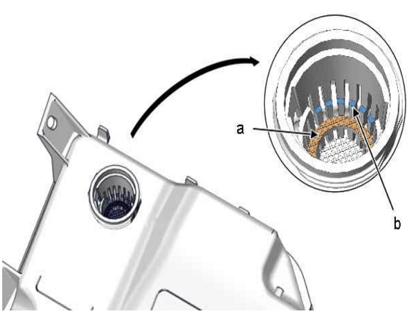

N.B.: Checking of the LDS fluid level is done with the vehicle in the forced low position (hydraulic suspension circuit de-pressurised).
"b" LDS fluid maximum level.
"a" LDS fluid minimum level.
Open the cap (3) of the fluid reservoir LDS.
If necessary add LDS fluid up to the maximum level "b".
Recommended tools:
- Start the engine.
- Set the height control to the "LOW" position.
- Wait for the vehicle height to be in the required position.
- Stop the engine.
- Connect the tool [1] to the vehicle’s diagnostic socket.
- Switch on the ignition.
- Carry out an global test.
Suspension
- Switch off the ignition.
- Disconnect the battery.

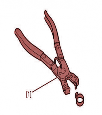

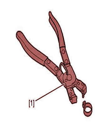

| Circlip Pliers CLIC 4121-T. | Hose Clamps 4153-T. |

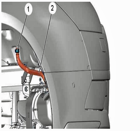

Draining
- Start the engine.
- Lower the vehicle to the low position.
- Stop the engine.
- Raise the vehicle and support on axle stands, wheels free.
Remove:
- The front right wheel
- The front right mud guard
Refit the clip (1).

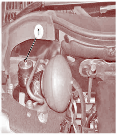

CAUTION: A container of LDS fluid that has been opened should be resealed and kept in a clean place. A container of LDS fluid should be used up within two weeks of being opened. After this, any LDS fluid that has not been used must be disposed of.

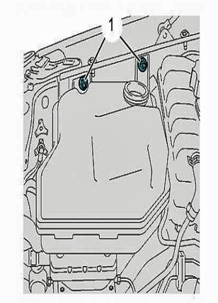

Removing & Refitting Hydraulic Reservoir
After the Hydraulic System has been drained:
CAUTION: Recovered LDS fluid must not be reused.

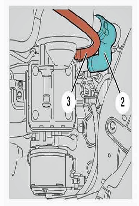

| Remove the nuts (1). | Tilt the LDS fluid reservoir onto its side. Uncouple:
CAUTION: Replace the "clic" clips that you have removed with new "clic" clips.
Offer up: The LDS fluid reservoir.
Couple up:
- The pipe (3)
- The pipe (2)
CAUTION: Use LDS fluid (New).
Fill & Bleed the Hydraulic Circuit (see Procedure above)
Reconnect the battery, following rel;evant part of the Battery Reconnection Procedure.
