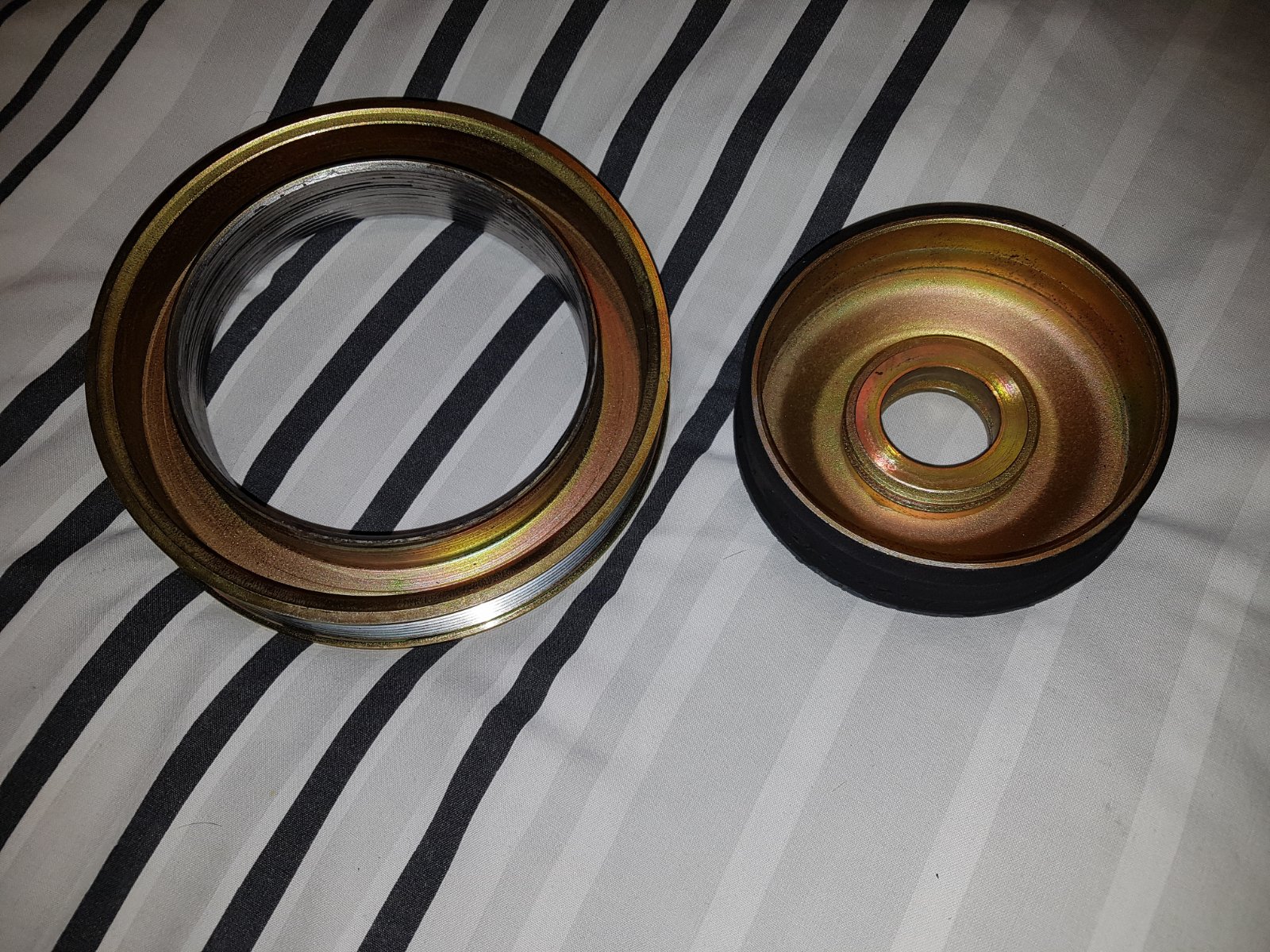

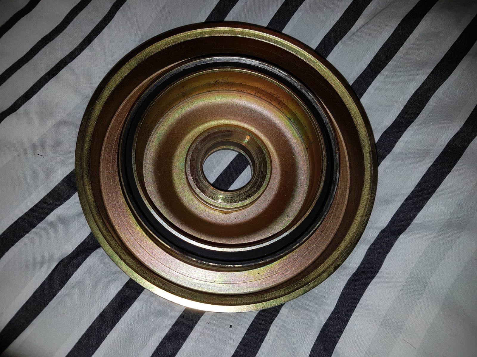

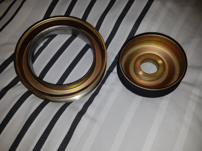

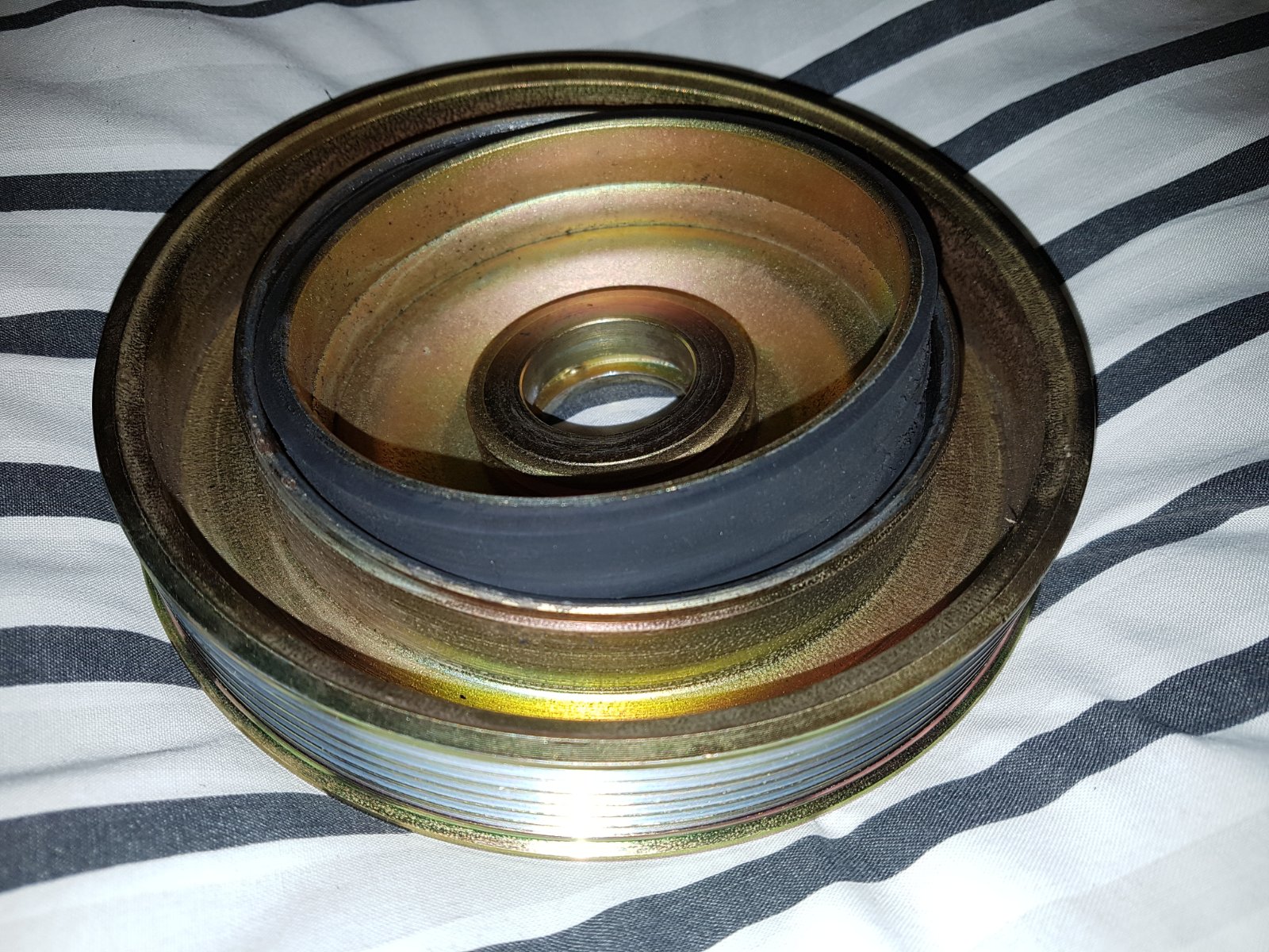

Yesterday I drove the car to work and the noise became a lot worse and my nerves were shot. There was a distinctive rattling noise under acceleration and I was getting a lot of funny looks from passers by whenever I came to a stop. When I finally got to work and eventually pried my hands from the steering wheel and got out of the car I realized just the extent of how bad the noise had become (It was horrendous) I opened the bonnet and took a look at the suspected area around the pulleys and noticed the 2 week old crank pulley had a little bit of play and by a little I mean loads. It looked like a buckled bicycle wheel and hey presto there was my issue.
The car was towed back to the garage where the original work had been done and I must say it looked at home on the back of a recovery truck
They confirmed that the crank pulley had broken up and replaced it with the original one that was fault free and the car came back home tonight.
Although the garage confirmed the pulley had broken up and failed I'm a little skeptical as to how they came to that conclusion. I'll post some pics of the "broken" pulley and let you guys be the decider.
Many thanks to everyone with their input it's greatly appreciated
