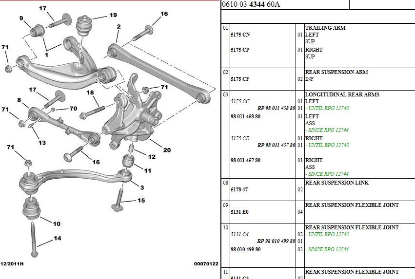

Re: C5 X7 suspension problem
Do the "MoT" testing stations use "Shaker ramps" for inspections in Australia ?......multi link suspension is prone to failing bushes being hard to spot....
![Image]()
I am unsure where there is any adjustment on the set-up
Thanks Stickyweed, the exploded diagram doesn't seem to have any adjustment on it. So that leaves stuffed bush(s) or one sphere. I shall check for leaks (from the sphere that is, not from the bushes).
From the diagram it does look like a worn bush would be the most likely suspect.
