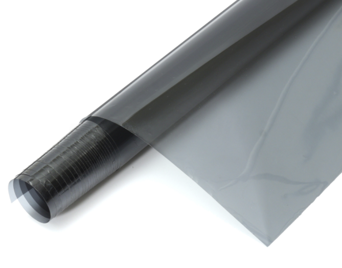

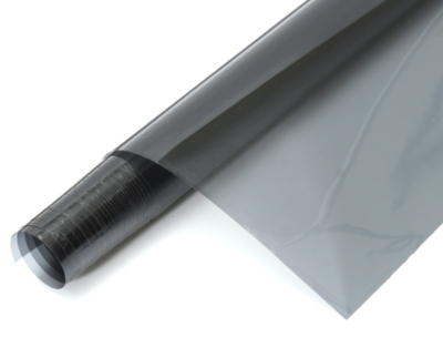

No, they are all different - even within the same model range and also depends on the year of production. You can't just put one in from another model.
In your case, the electrochrome internal mirror was only introduced on the C3 Picasso models from late November 2012 to 2014 according to the specifications and is part number 8154 89.
Given that it was not an option until this time, it is HIGHLY unlikely for there to be any control wiring for the unit on your 2009 model - as it was not even optional. It's not just power, don't forget that the mirrors automatically lighten when reverse gear is selected, so it will likely require a CAN connection commanded from the BSI. My setup for example has a ribbon cable interface to handle that and other functions of equipment in the roof console. You also need to have the correct BSI and software level - so again highly unlikely it will available on your model for that year.
Looks like you'll have to stick to a pair of these

Or I could get any other electrochromic mirror which fits neatly in the ball joint and run 12 V from the cigarette lighter (or dome light) to it for the dimming functions and call it a day.
- x 6947
Retrofit Electrochrome Mirror to C3 Picasso
That would be a bit overkill IMO. The higher fuse rating for the cigar lighter would not be suitable for the electrochrome function and the wiring would be messy; the lighting function for the front interior lamp control unit and front courtesy light is handled directly by the BSI - so that might have unintended consequences mucking about with that. But if you are that determined to have a tinted interior mirror...
