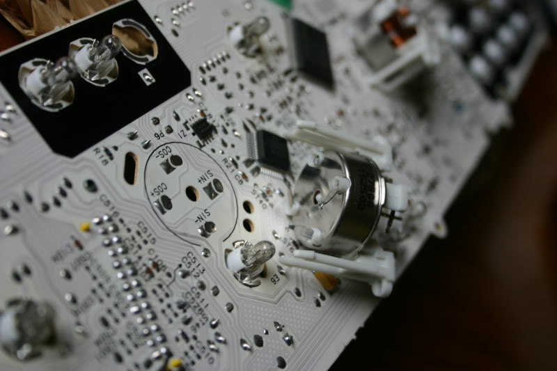

No, but chances are it's just dirt on the spring 'fingers' that connect the stepper motor to the printed circuit board at the back of the instrument pod.
It's getting common on S2 Xantias now. Does a good thump on the dash help?

I was trying to solve the dreaded sticky speedo. After reading all the posts here I thought it would have been a simple solder job. But no, My speedo had to be different.
The stepper motor connects to the pcb assembly through 4 sprung contacts and these are held in tension, on to the board contacts, with 2 pairs of plastic clips.
Ok I thought, so no soldering, thats a plus,
I'll remove the speedo needle and bend the spring contacts to aid the connection and hopefully stop the sticky needle.

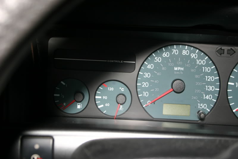

I managed to set the rev counter needle, the fuel guage needle to their correct positions but the no matter what I do to the temp guage, when the ignition's on, it just hangs vertically down.
Any ideas how I can solve the vertical Temp needle and adjust the speedo needle so its reading correctly? or at least as incorrectly as it used to read!!

Where does the temperature needle rest with the ignition off Chris?
c.morewood
- Posts: 1058
- Joined: 05 Nov 2004, 14:38
- x 55
Re: Speedo problems
Thats it Jim.. in the photo.. it'll rise with the ignition on to show temperature.. whether its true or not only a thermometer will prove.. just wish it wouldn't drop like that with ignition off.
