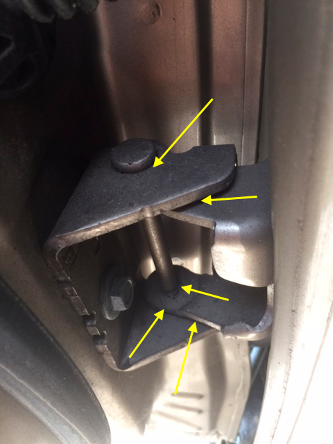

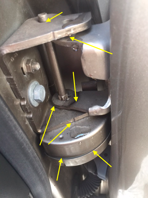

Pete, I use silicone spray. Make sure you get a good dose of it where indicated - but importantly on the top cassette mechanism as shown. It's important to try and get some spray inside the cassette where the 2 halves join. I';m sure water gets in there and causes the creaking - so don't be tight with the spray in this part
Then 'work' the doors by gently opening and closing and repeating. The silicon spray works a treat - but I don't recommend WD40 in this case.
