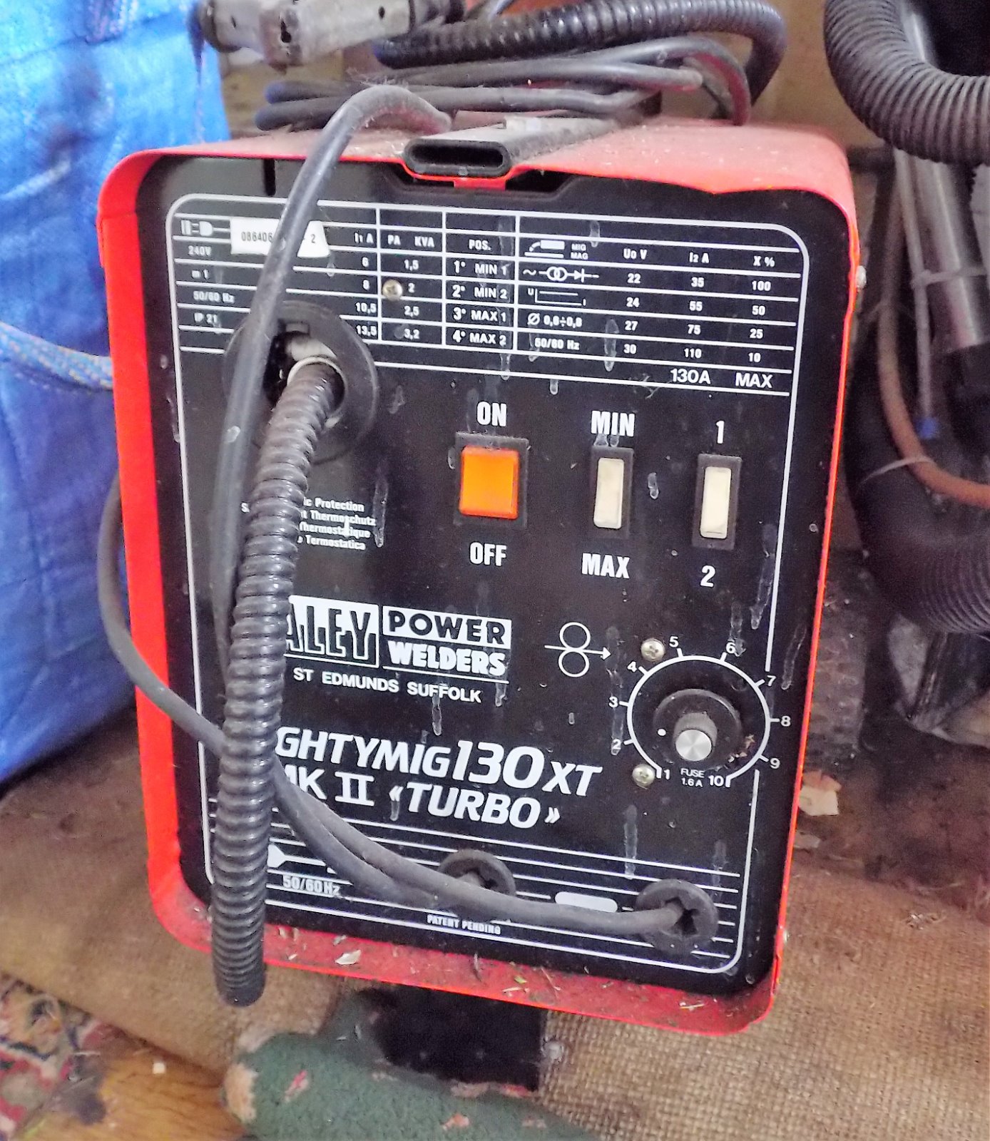

I've got this sitting unused in my workshop for at least the last two years, it can go for £25 if someone wants it and can arrange collection.

I'd be snapping that fella's hand off in Towcester if anyone else wants a welder and can get the Clarke in Richard's post anywhere near that starting price. I paid more than 3x that for my similar machine about 3 years ago, which I think was 'about right'.
...never worked out what the purpose of the handle on the top is supposed to be and took it off long ago (its safe). Anyone know?

Set the gas rate - turn the reg to about 5, put the torch near your ear and gently pull the trigger to start the gas, you should just about be able to hear it. Turn up the reg till you can.
Feed the wire in - put the spool on, and the wire between the rollers (with the correct size roller set for the wire) and into the torch cable. Stretch out the torch, remove the shroud and tip (unscrews) then pull the trigger and allow the machine to feed the wire in till it comes out. Fit a new tip (they wear, and give unreliable contact!), and shroud. Snip the wire off to about 1" long.
Test the roller load - in theory you should be able to put your finger over the end and hold the wire with the trigger depressed, this helps stop the machine balling the wire up between the rollers and the liner if it gets stuck for some reason. Back off the spring load till it feeds normally but slips when you want.
Set the power - will need some experiment - that machine has 4 positions Min 1 / 2 and Max 1 / 2 same as mine, and I find they roughly equate to 1-4mm thickness material, going up one setting when doing a lap or corner joint weld.
Set the wire speed - on mine somewhere between 5 and 9, related to the power setting.
Set up a test piece to lay a bead down on a straight piece of metal, clamp the earth on, set the torch at about 60deg to weld in a forehand manner, then see what it will do. I always use 2 hands, easier that way!
If the power is too high it will just melt; if too low, the weld will sit on the top with no penetration.
If the wire speed is too high it will be a bit intermittent, and tend to push your hand back off the work; if too low it will sputter ( and probably weld the wire to the tip!). It should give a nice continuous crackle - often likened to bacon frying.
Experiment different weld speeds; you should be able to see the pool develop, and then push it along to get the fusion.
