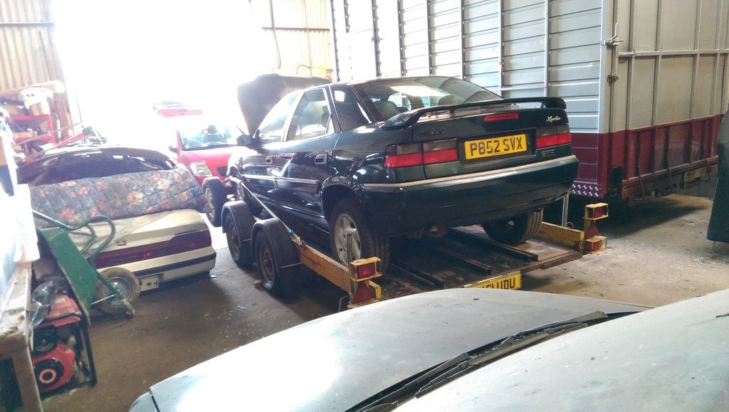

A week later, I went back #-o :oops: :rofl2:

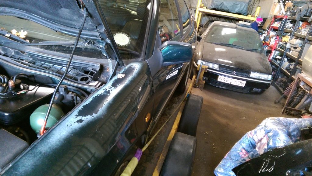

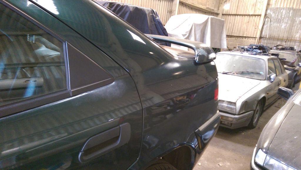

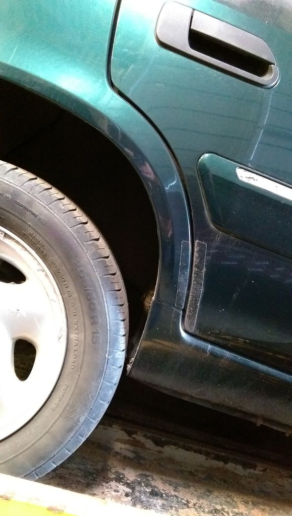

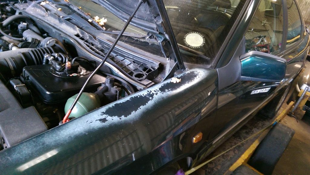

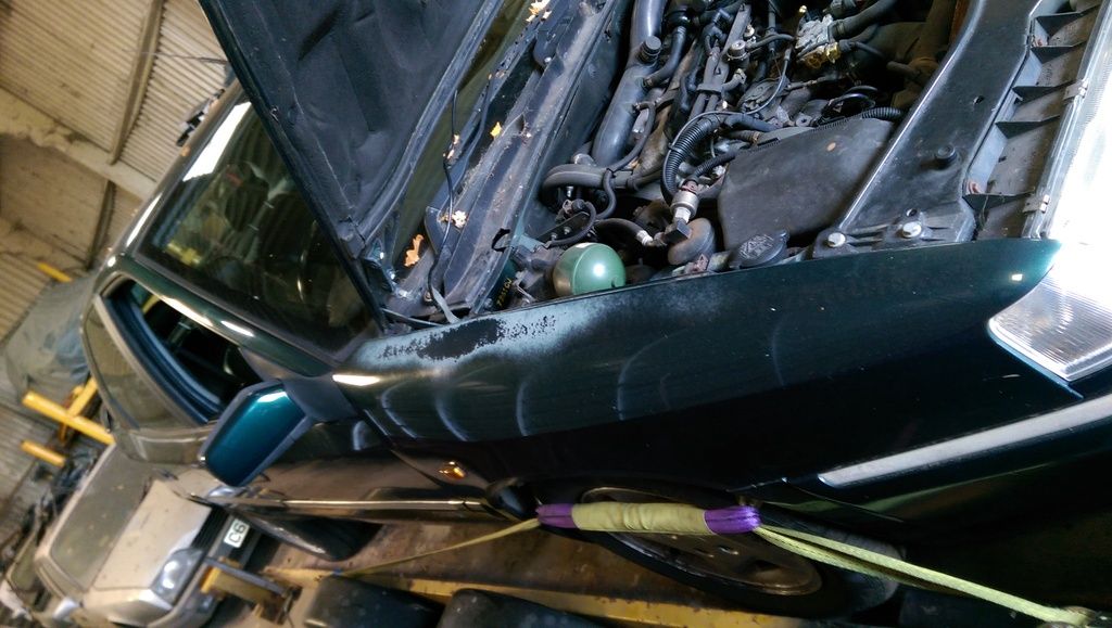

Lacquer peel all over
But not a smidge of rust;

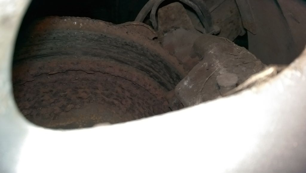

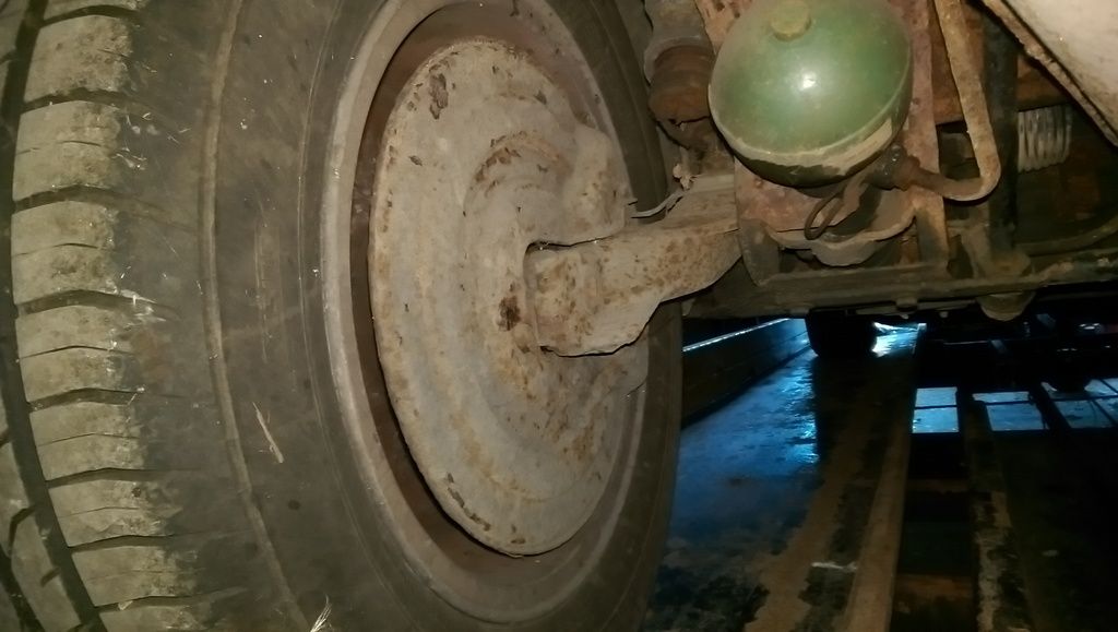

How's this for shagged brakes?;

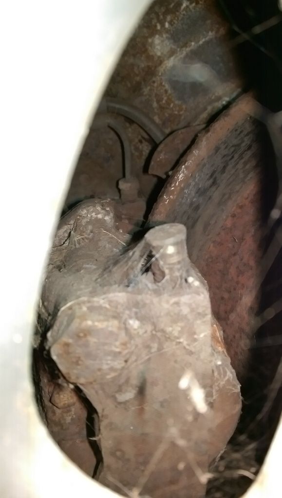

At least this side still has the backing plate;
Minor weep, nothing too serious, all spheres look recent.

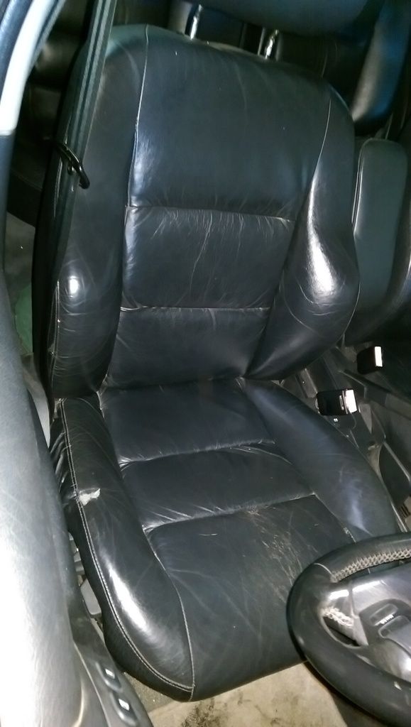

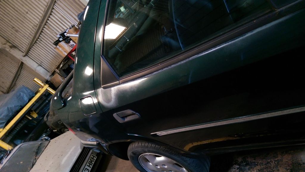

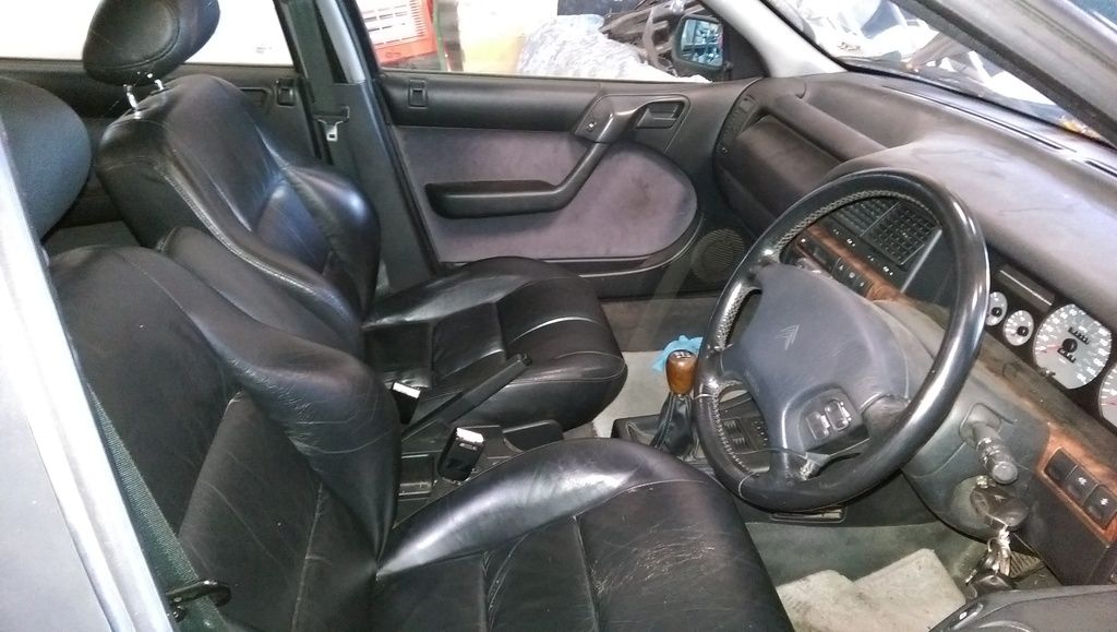

Full leather, small hole in the driver's side, rest of it is in great condition though;

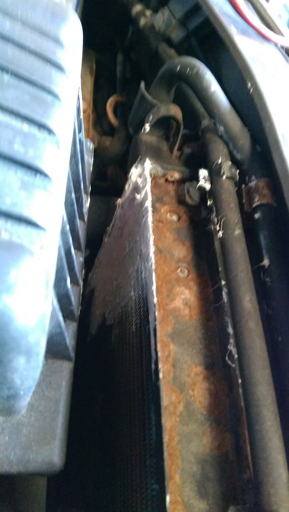

Nice looking radiator repair :lol:
Image(not leaking from here though - maybe because it's pissing out elsewhere so badly that it never builds up enough pressure :lol: )

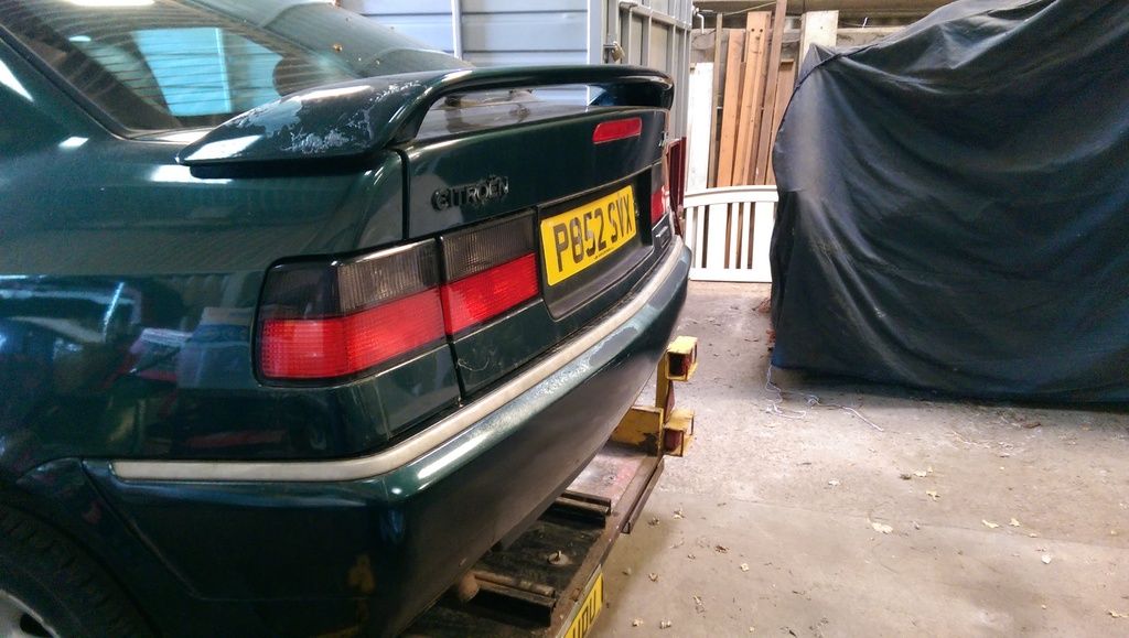

Pair of Activa together :hug:

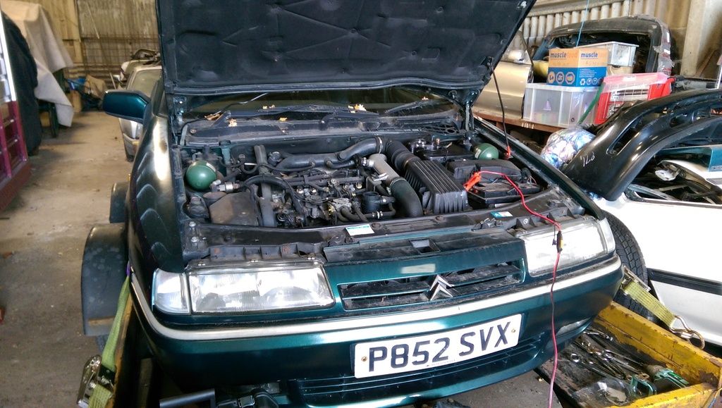

Incidentally...
This one takes minutes before the suspension starts to react (rise). After switch off, it stays up for a decent length of time (don't know how long but more than 12hours) then the front drops, but the rear stays up.
Likely cause being??? Front anti-sink sphere? Or..?

Flat spheres and possibly a knackered pump most likely Iain ;)
How long is the regulator tick interval once all is settled down?
There is no front anti-sink sphere but there is an Activa accumulator under the battery tray that goes flat/ruptures and causes lots of fun... It looks like an anti-sink sphere and that may be where the confusion comes in...
Being hidden, it tends to be forgotten about and ignored...

I thought the pump may be knackered. Impossible to hear the regulator cut in/out frequency, on account of the thing running with no exhaust :rofl2:
Once up though, it drives fine without the steering going heavy, which suggested to me that the pump and accumulator were fine, but something in the front suspension may just be leaking by causing it to take ages to fill initially???
I'm unlikely to spend much time on investigating it any time soon tbh, but am curious to understand what/why...
