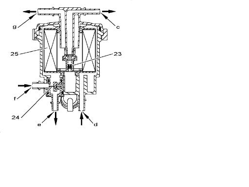

Heres a thought HELPERS!
The fuel Filter unit has got a LOW PRESSURE Circuit regulator in it... Would that be causing an issue??
The low pressure cuircuit has to be correct for the Engine Pump to draw from to pressure up the High Pressure. Would a pressure issue there cause a high pressure issue?
I swapped filter elements, but I never swapped filter houses???
Direction of the fuel flow (as per arrows).
(23) low pressure regulator.
(24) thermostatic sensor.
(25) filter element.
C:return to fuel tank.
D:heated fuel inlet (coolant outlet housing).
E:fuel outlet (to coolant outlet housing).
F:fuel inlet.
G:fuel outlet (to high pressure fuel pump).
The low pressure regulator controls the pressure of the fuel in the low pressure circuit.
Circuit pressure:ð 2,5 bar.

well i covered this paul as my old filter housing it was missing and it caused no probs so it wont hurt to remove it as a test :) im also thinking that fuel regulator ufo thing in the fuel line??

remove 23 it just unclips

I have got the CORRECT pressure figures that the low pressure curcuit should be reading etc.
How would I go about connecting a Pressure guage to it to see what its reading...

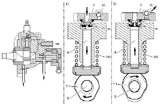

2 - Deactivator of the 3rd piston of the high pressure fuel pump (1208-6)(1208-6)
2.1 - Role.
Role of the deactivator of the 3rd piston of the high pressure fuel pump :
To reduce the power absorbed by the high pressure pump if the vehicle is used at low load.
To limit the high pressure quickly in the event of a problem.
E:using 3 pistons.
F:using 2 pistons.
(4) high pressure piston.
(5) deactivator of the 3rd piston of the high pressure fuel pump.
(7) fuel suction valve.
(8) delivery ball valve.
(9) suction valve return spring.
(12) push rod.
Components of the deactivator of the 3rd piston of the high pressure fuel pump :
An electromagnet.
A push rod which moves under the action of the magnetic field created by the electromagnet.
When the 3rd piston deactivator is not energised :
The fuel suction valve (7) is held against its seat by the spring (9).
The cylinder is closed.
The action of the pump shaft cam leads to a pressure being created.
The fuel pressure lifts the delivery valve (8).
The fuel is directed towards the high pressure outlet of the pump.
When the 3rd piston deactivator is energised :
The push rod (12) raises the suction valve (7) from its seat.
The cylinder is open:No pressure is created.
The fuel is directed towards the low pressure part of the high pressure pump.

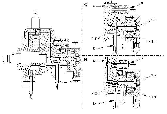

2.3 - Electrical features.
Control:injection ECU.
Type:"all or nothing" control through earth.
When the 3rd piston deactivator is energised:the pump operates on 2 pistons.
When the 3rd piston deactivator is not energised:the pump operates on 3 pistons.
G:high pressure regulator not energised.
H:high pressure regulator energised.
A:high pressure fuel outlet (to the common injection rail).
B:return to fuel tank.
E:high pressure fuel circuit.
(13) spring.
(14) electric coil.
(15) magnetic core.
(16) ball.
The fuel high pressure is regulated by modifying the rating of the high pressure fuel regulator.
The high pressure fuel regulator consists of 2 pressure control circuits :
The electrical circuit which acts directly on the high pressure which controls the electromagnet of the high pressure fuel regulator (injection ECU).
The mechanical circuit which provides a minimum pressure and dampens pulses.
3.3 - Mechanical operation.
The high pressure fuel circuit is subject to pressure variations.
The fuel high pressure increases when a pump piston delivers.
The fuel high pressure decreases when a diesel injector is opened.
The movement of the ball dampens pressure variations.
3.4 - Electrical operation.
When the high pressure fuel regulator is not energised :
The fuel high pressure opposes the mechanical action of the spring (13).
The regulator opens for a high pressure which is greater than the spring pressure (ð 100 bar).
The fuel released by the high pressure regulator returns to tank through the outlet "b".
NOTE : Engine off for 30 seconds, there is no residual pressure in the high pressure fuel circuit.
Pressure rise control phases :
The injection ECU supplies the high pressure fuel regulator with an OCR current.
The coil of the high pressure fuel regulator drives the magnetic core (magnetic force).
The force applied to the ball is the sum of the spring force (13) and the magnetic force of the core.
The cut-out value of the high pressure regulator increases.
Pressure reduction control phases :
The injection ECU reduces the OCR supplied to the coil of the high pressure fuel regulator.
The force applied to the ball reduces.
The cut-off valve of the high pressure regulator decreases.
NOTE : OCR : Open Cycle Ratio.
3.5 - Electrical features.
When the high pressure fuel regulator is not energised:the pressure is limited to ð 100 bar.
Control:injection ECU (earth).
Variable voltage control (OCR) :
Maximum voltage (maximum OCR)=Maximum pressure.
Minimum voltage (minimum OCR)=Minimum pressure.
