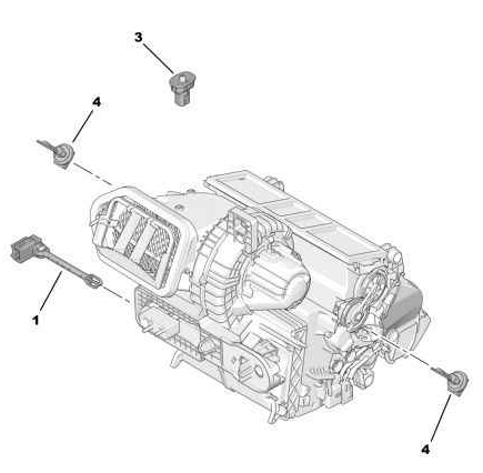

The X7 (on our models) does have an Air Temperature Probe Elis - one for each side on Bi-Zone System.
1) Evaporator Sensor
3) Sunlight Sensor
4) Air Temperature Probe
There are only 2 systems - Mono or Bi-Zone.
The Air Quality sensor monitors contaminants and shuts of outside air when reversing or when in traffic and exhaust fumes are detected for example, and also when screen washers are activated.
3) Sunlight Sensor

Re: C5 X7 True 'Climate Control' ?
I see, are the air temperature probes located in the cabin or in the stream of air to be blown out of the vents? It's the latter then I'm not sure how it can be a true climate control system.
Blowing 20 degree air for example into a cabin won't cool it to 20 degrees due to the heat leaking in from elsewhere. Thats why some cars have a sensor in the cabin away from the draught of the vents to decide what temperature air needs to be blown in.
The C6 has exactly the same as the diagram above Elis.
I've just had another look at the diagrams and 8024 and 8028 are the left and right passenger compartment air thermistors, so that would indicate they are able to monitor the left and right 'compartment' temperatures.
