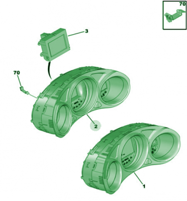

There are 2 types of instrument cluster. You have the type marked as item (2) below that allows for the matrix (3) to be replaced.
6155JA was the original Matrix Part Number which needs configuring and has now been updated with Part: 1613424380 which is the newer model. It costs £450.73 from Citroen as of today inc. VAT.
1606616780 is the part number for the Clips, item (70) (£6.07 inc. VAT).
As it turns out the configurable part is no longer available.
I will put together a quick illustrated guide for removing the display shortly with a link.
