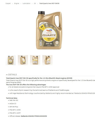

Thanks Marc - can you advise which oils meet the spec I need? I'm paranoid about using the wrong type :(

Use the one in the picture I provided to you already ^ (click the image to magnify it). This is the oil grade specified against your vehicle, whereas the document I maintained on the Forum (July 2024) will likely have been updated again. So 05W30.

Yes, that meets the specification stated FPW9.55535/03.
