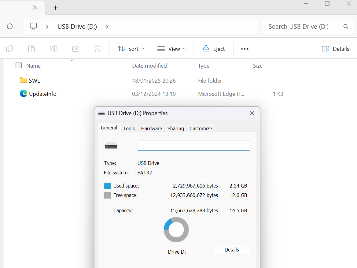

danlat1415 wrote: 19 Jan 2025, 19:15 What error are you getting when running the update I've provided above?
The contents (1 file and a folder) should be placed on the root of a USB that's formatted to FAT32.
No errors. Just nothing happened. Exactly as before. The only difference between your archive and what I tried to install before is MediaHeader\MediaVersion.ini
but no matter what file was used the results is the same.

mgs wrote: 20 Jan 2025, 23:00
If you're not getting any errors - and simply nothing happens, that would appear to be an issue with your USB drive not being read by the car. You should always get a notification on the display when any USB is inserted, regardless of what it on it. If you're not getting anything at all, then that means it's not reading the USB.
Make sure it's formatted to FAT32, or try another USB drive.
There are 3 or 4 files different to the MyCitron server version if I recall correctly.
It is a universal certificate version so should work on any vehicle without the need for manual certificate or VIN verification.
If it is modified in any way then it won't work as it prevents it from being universal.
As described, simply download the ZIP file, extract the contents direct to a blank USB that's been formatted to FAT32 (must be FAT32) and in the root directory of the USB - DO NOT MODIFY IT IN ANY WAY.
Plug the USB into vehicle, and if your USB is ready it will usually say no media files found (as it checks for song files first).
Then after you've clicked off that, a few more seconds it will give the update alert and ask if you want to continue, then another warning screen telling you to turn eco off and do not drive the vehicle when firmware updates.
It takes 15-20 minutes for the update to complete.
