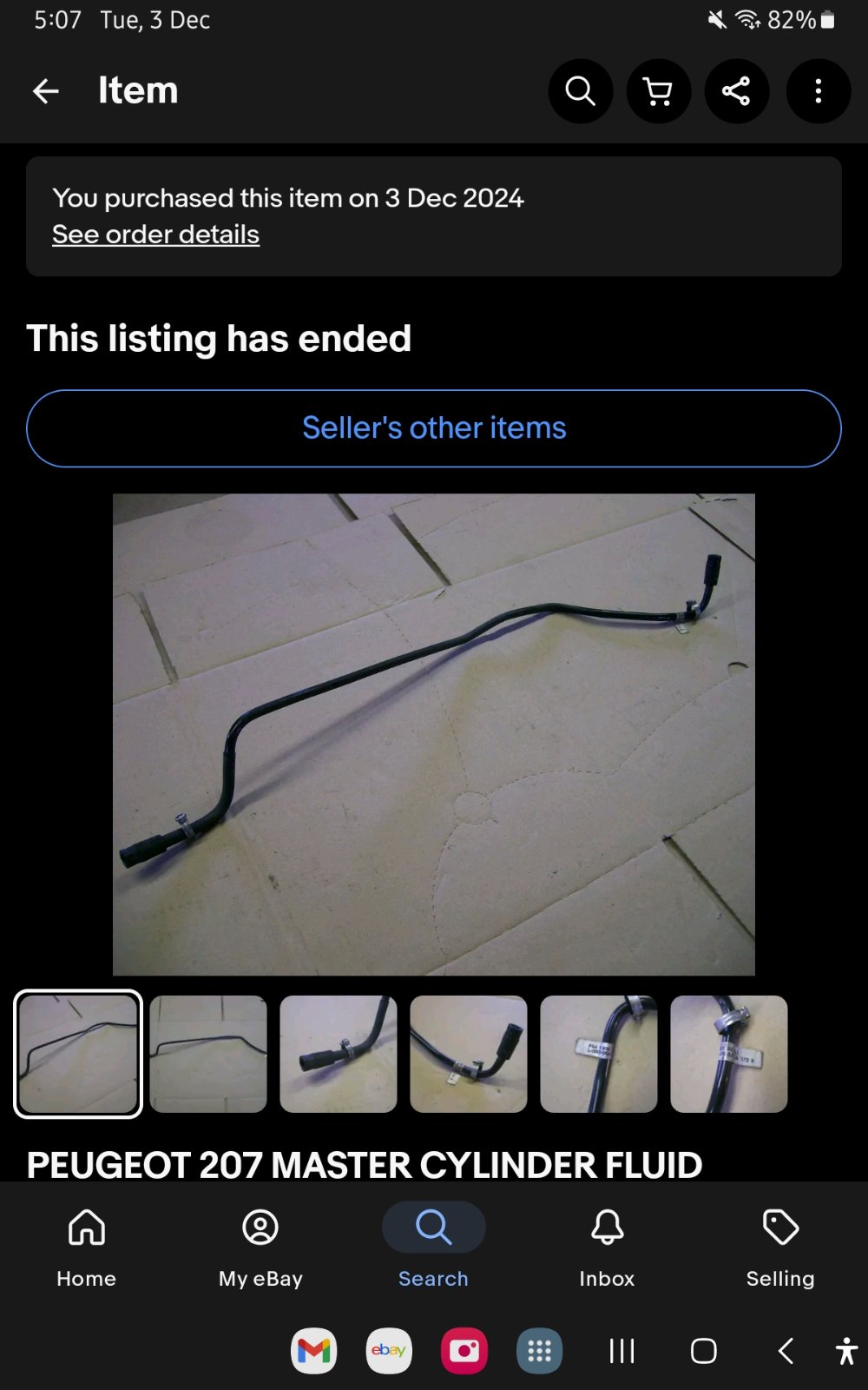

So i Made an offer for a tenner & 10 mins later its mine , was £15, its not the grey weird one but thinking outside of the box this will be much better , the fitments are tighter too. The shape looks very simliar so yes
Bangernomics ! Here we go.
Theres some selling these on ebay for over £100 !
