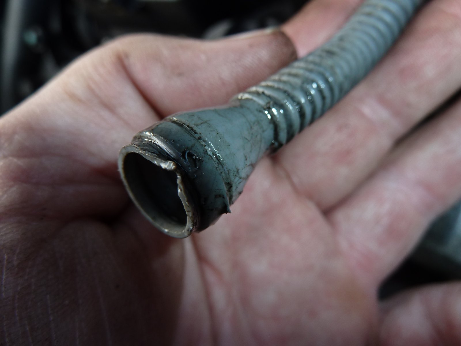

So wiper scuttle panel off, air box out , BINGO , Master cylinder supply pipe
Was leaking at the master cylinder connection point. So i pulled this off , no effort at all & ive poked it into the fluid filler bowl so it dont leak.
So this is drawing in air everytime the clutch is being used ,possible car movement & vibration wont help a week spot either.

This is a possible cause
Husky.

The fluid feed pipe end didnt look to healthy to be honest.
Husky.

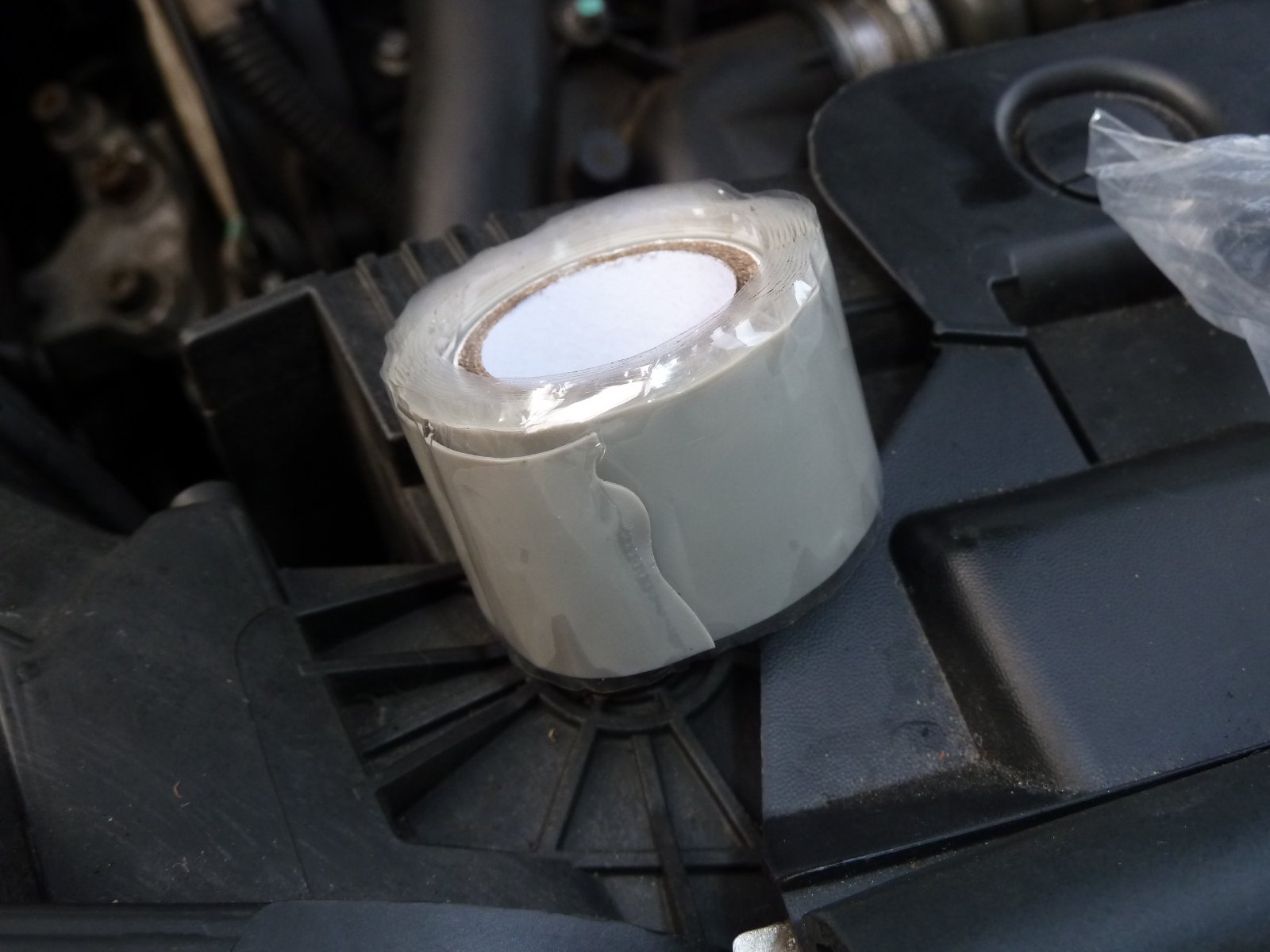

A bodge fix with these...
Husky.
