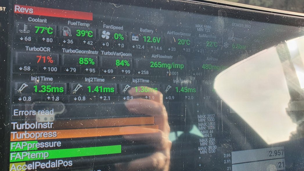

Well, time goes by and i still looking to discover what may be doing that initial roughness. Not pleasant to drive in a slow way. However, some new light appeared to me today over this subject: As Turbo OCR goes around 70% plus in lower rpm the engine is smoother, Only when its at around 60% or less it is rough. What does control turboOCR?
Another interesting discovery is that sometimes when electronic handbrake is applied, ocr sits around 60% at idle and once i take it off, OCR goes to 70%, It changes also Voltage as seen by OBD from 12.5 (ish) to 14.6 (ish) with handbrake off or on... Battery could be signaling weakness?
yoseff
Posts: 155
Joined: 29 Nov 2010, 01:34
x 18
Re: MAF sensor readings
Unread post by yoseff »
Need to solve that... It's driving me crazy and damaging the dual mass flywheel with the power surges.
It seems to be related to OCR being at a percentage that should not be.
Turbo is doing a bit more pressure than it should and hence the nervousness. I can see that pressure is bit higher than engine ask for. What can be doing that? One of the valves behind the engine?
At the moment vacuum reserve is bypassed, as there was a leak on it. I'm looking for a vacuum reserve box from another car to adapt, as in this engine it is in the intake manifold and don't want to change it. Could the lack of that reserve contribute to it?
Could be a perfect car. It's getting better in many ways. Front spheres were re gassed (the 3) to correct pressure, changed 2 central ones behind, one was blown , engine went out to change all those parts that could leak anti freeze from the engine, head gasket was done, lots of stuff done recently, but this detail is just taking the pleasure of riding the sofa on wheels... :(
Maf readings seem not correct either at idle. Got another Maf, but still bit on the high side. Will clean it well today to see if it goes from the 12g to something near 5-7g at idle. But on second thoughts, it can actually be the extra work of turbo that is pulling more air at idle, so not a Maf reading issue.
So, the big question is: What can affect turboOCR not going more towards 100 % at idle? Where should i look? One valve behind the engine was changed for a new original one. I think it was the first one near the smaller that controls EGR. But it was not me doing it, so not 200% sure if was that one. EGR provoking the issue is already ruled out.
Could someone please show me some light?
