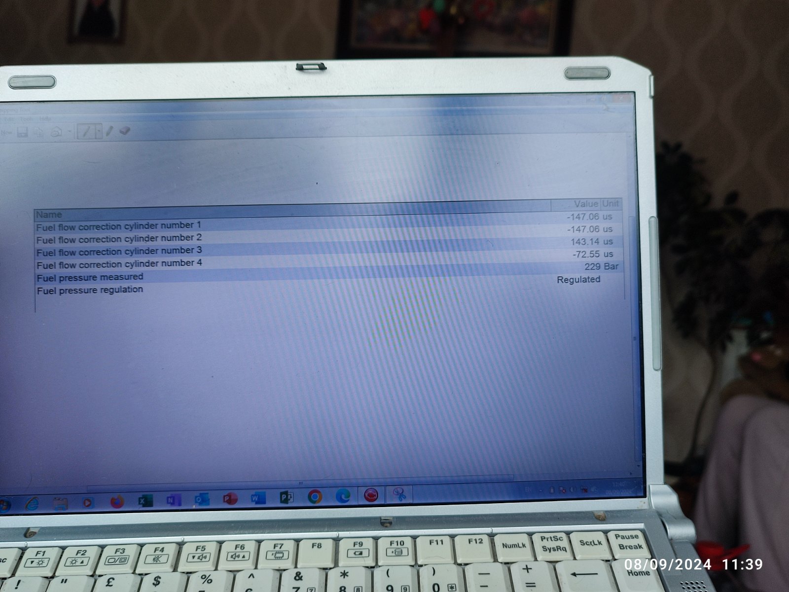

I ran a diagnostic test and she is throwing up silly numbers for injectors. -147 on 1 and 2 +143on 3 and 67 and moving on number 4. The first three seem to be closed by the ECU to compensate for for cylinder 3 injector. I think I need to get them tested. If this is correct I have one good injector out of 9😕.
Darren

If you look back at the first thread you can see that this is the same number for 3 when I first started down this road
Darren

I've been thinking about what I found yesterday and I think it is diesel coming out of the turbo not oil. I think it's pumping diesel into cylinder 3 constantly. The clouds of white smoke are so bad I can't run diagnostics properly because the fumes are so bad I couldn't breathe properly . They were burning my eyes as well. I'm chesty today after it.
There has been a couple of injectors in that port and they have all read the same value 143.14. does this indicate I have a bad driver

darbuck wrote: 08 Sep 2024, 11:43 I've been thinking about what I found yesterday and I think it is diesel coming out of the turbo not oil. I think it's pumping diesel into cylinder 3 constantly. The clouds of white smoke are so bad I can't run diagnostics properly because the fumes are so bad I couldn't breathe properly . They were burning my eyes as well. I'm chesty today after it.
I don't know about RHR engine which I think you have referred to yours as in the past but 229 bar fuel pressure seems a little low. My RHZ runs at 306 bar but unfortunately I don't currently have a Lexia to use so cannot go and plug it in.
1) Have you cleared all fault codes from the ECU and done a re-read? If not, please do so and provide an up-to-date read.
