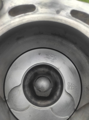

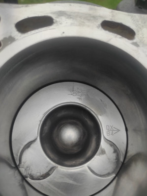

Hi lads and ladies, I have a few more pics of my engine rebuild, I forgot to photograph the head gasket itself. I discovered three of my tappets (hydraulic lifters) are no good so have to wait on new ones to arrive to finish it off. Nearly there now.

Great pictures, looks spotless
Couple of questions:
Did you treat yourself to an engine stand? (I remember they seemed to have gone up on price considerably since I bought one for £37) you've more patience that I have if scrabbling about at ground level!
How did you test/find out your hydraulic lifters were duff? I didn't test mine at all, just squeezed them in a jam jar of new engine oil (and each ejected a little "cloud" of filthy black oil into the clear new stuff= made me feel better even if no actual benefit!)

Thanks Matt, no not this time, too expensive. I will get one eventually for a few other projects I have planned for the future unlike this unplanned one. I am just taking my time with it.
Scotch brite pads on a screw gun so not so much patience needed and done on the driveway so done in the sun and throwing the ball for the dog
simple pleasures.
They are not supposed to be compressible by hand is my understanding of them, three of mine were very soft and on guess where cylinder 3.
There was something very strange going on in there.if you zoom in on the first cylinder pic you will see a circular indent on the piston on its outer edge where it was hitting something which I wasn't able to determine,
but I think if memory serves me there was something in it but I had originally thought it was from when I pulled the head so didn't think about it until I discovered the someone was at it before that much I do know. There was damage to the shroud of one of the head bolt seats but nothing to bad to fix thankfully.
