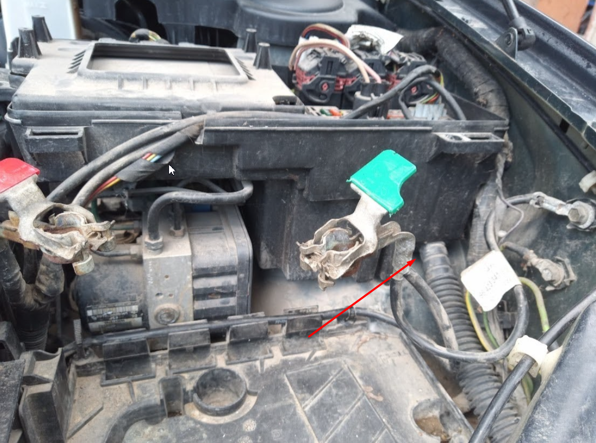

Finally a sunny weekend, so took off the front bumper.
The previous owner had a light front accident so wanted to check everything.
Questions:
What are these connectors:
#1. is from the headlamp
#2 the small one/ black, with 3 pins, another one similar can be found on the other side as well ??? so it can be only related to headlamps or... ? see bellow
#3 the one in the right 4 pins bit different from xenon motor and the wires are short ???
#4 the hose, I found where it should be connected by the end. #2, with 3 pins on both sides of the car That hose goes to the fuse/ecu box for cooling What are these for, I couldn't find what was there clipped?
I found a cheap pair of xenon headlamps, installed them (mine was halogen) and everything worked fine in terms of lightning, just plugged.
I didn't test the auto-leveling, and of cause it's not moving right-left.
The difference between the connectors, the xenon one has 3 more pins, not yet sure what are their for :
Questions:

Re: Just bought it, C5 '05, few questions
Be aware that some of the connectors MAY be for optional extras that were not specified when your vehicle was made, so you may (if you are not careful) end up chasing a few red herrings.
- Posts: 42019
- x 6917
The clips in picture 4 are to remove the air filter cover. They need pushing in to remove once the other clips have been undone.
Don't expect the Lighting to work properly, you really need headlamp wash system to be legal, headlamp ECU, BSI configuration, and the correct loom (which are different for models with and without Xenons). etc.
