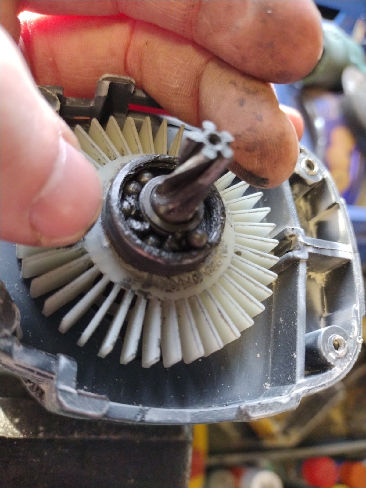

Does this away with my world the next job isn't "drill the floor" instead it is "try and make the SDS drill work again" it's been asking a little bit and seemed as though needed a general clean out. However the job has just grown...

Pretty much square on, you can see how eccentric it can run in its current condition!

Rather amazingly £1.71 including postage for a new 609Z (marking on the bearing. Is actually a 609ZZ)
https://www.ebay.co.uk/itm/176012819403

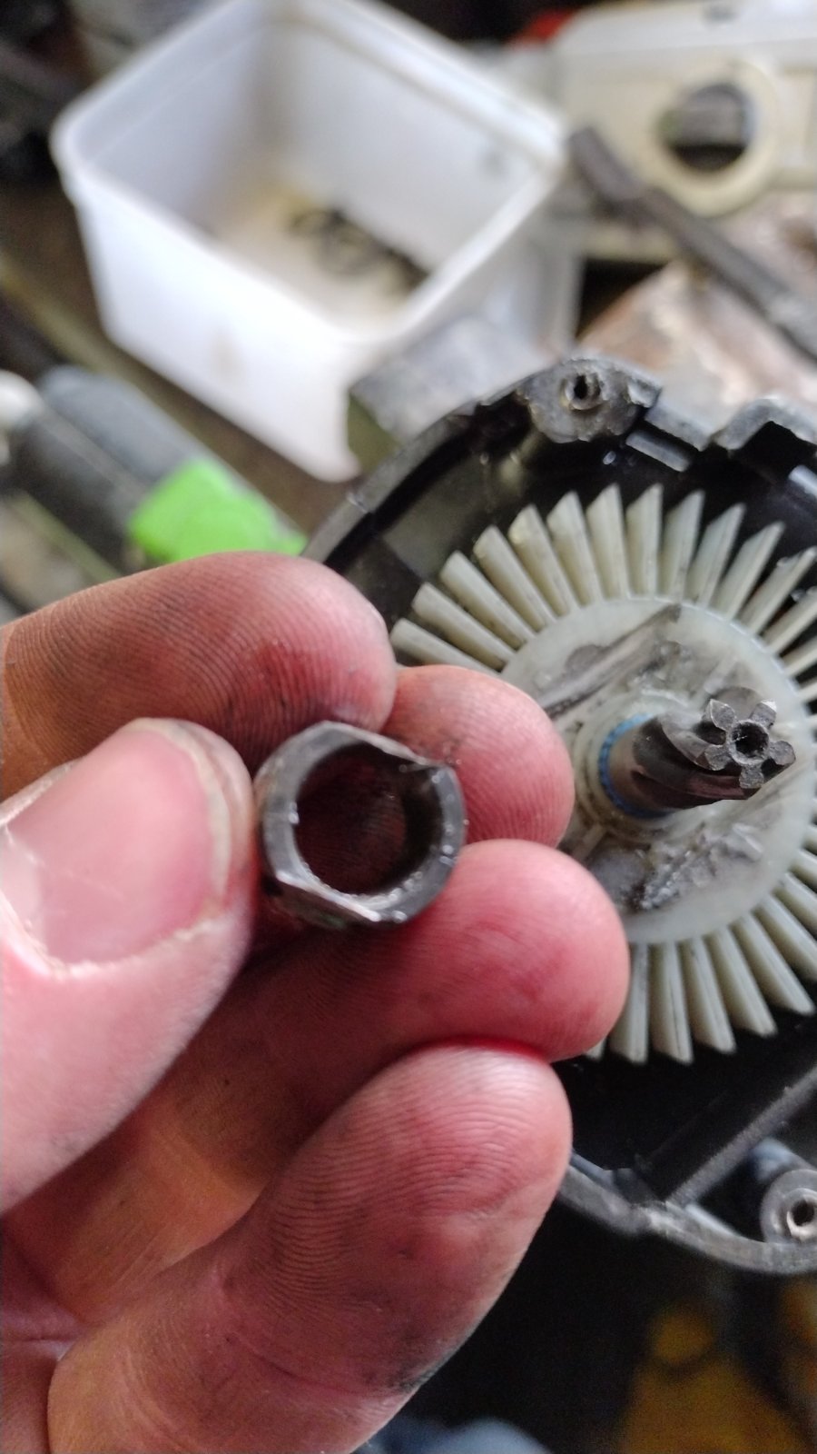

Will hold off splashing out such vast sums until I have got this off. Couple of flat screwdrivers either side isn't shifting it in the slightest. Grinder next

Just about to give up, but perseverance or stubbornness has shone through!

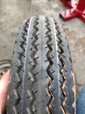

This is the slightly tired rim:
Which is donating it's zero miles tyre:
To the decent rim
