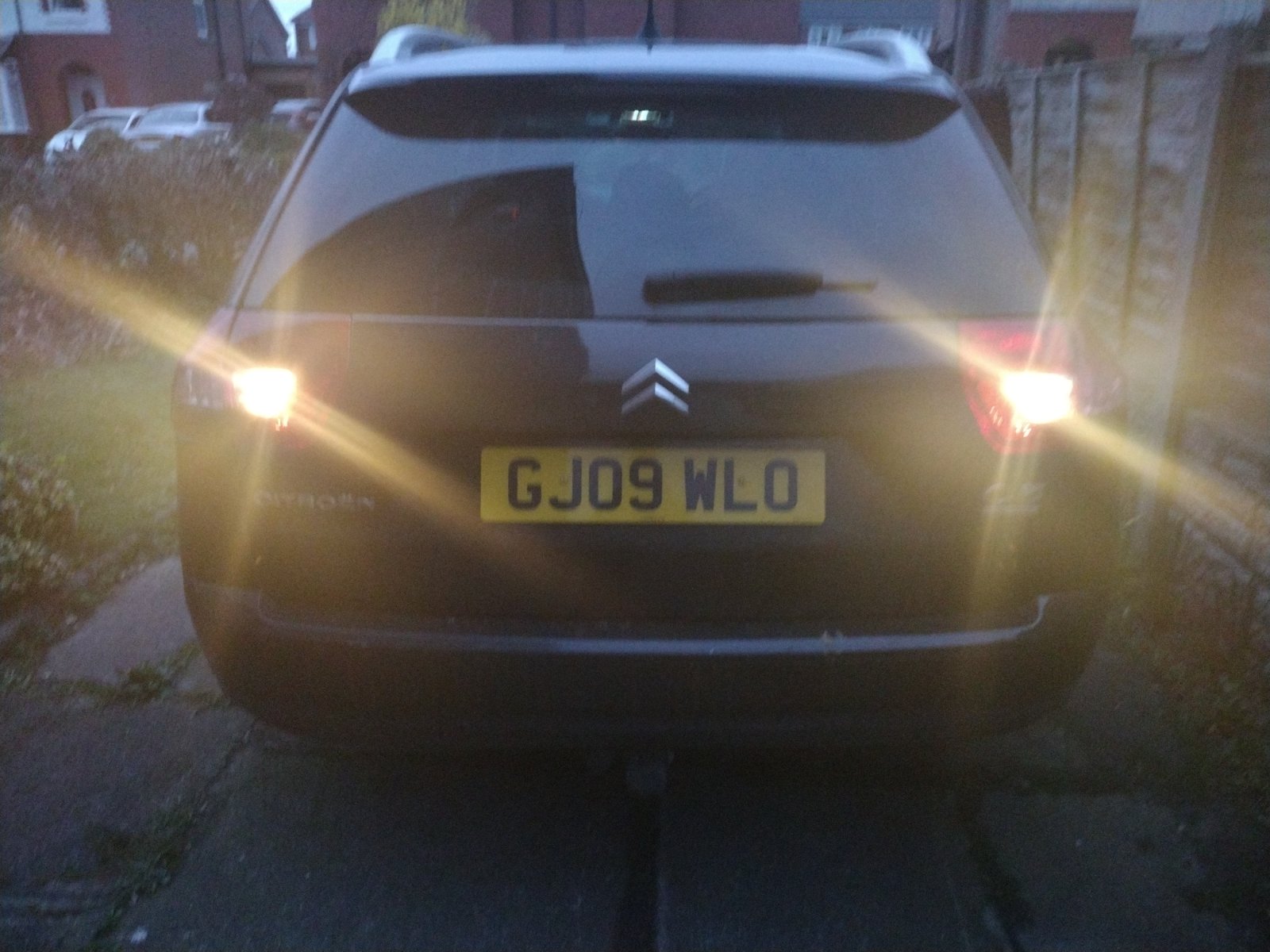

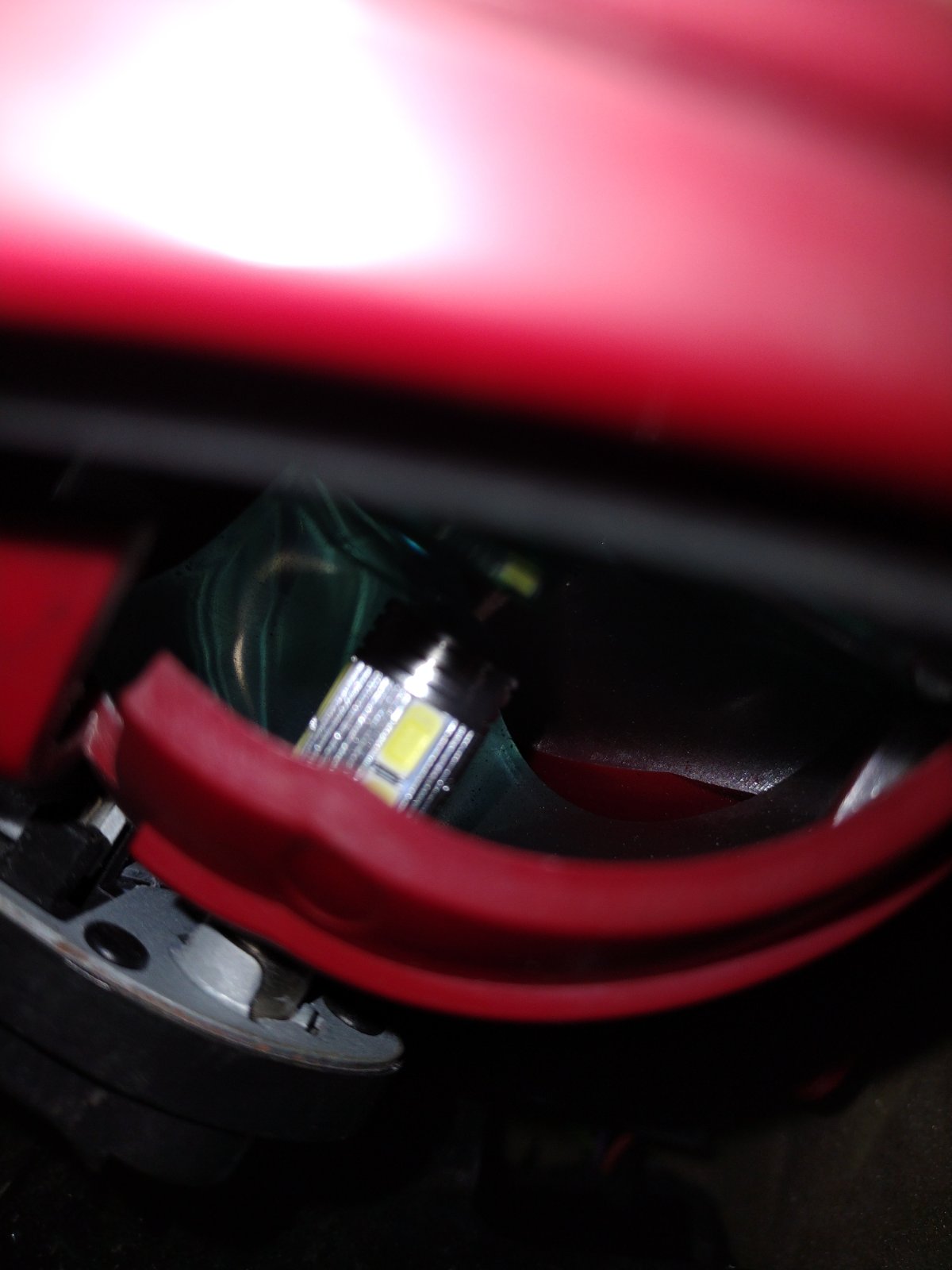

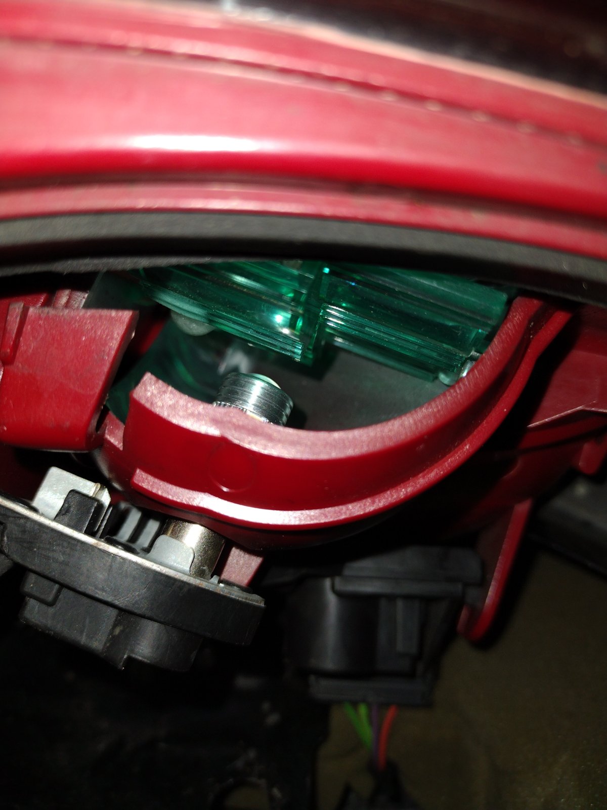

LED H21W off eBay arrived Thursday afternoon, so put them in last night
Before, which looks ok on a photo!
Fancy looking LED easy to spot against its old fashioned bulb companions
Much longer than H21W, but lots of clearance
Clearance
Clearance
No after picture as day light failing me. Doesn't look a great deal different, but to be honest I was most worried about it melting itself with the normal bulbs!

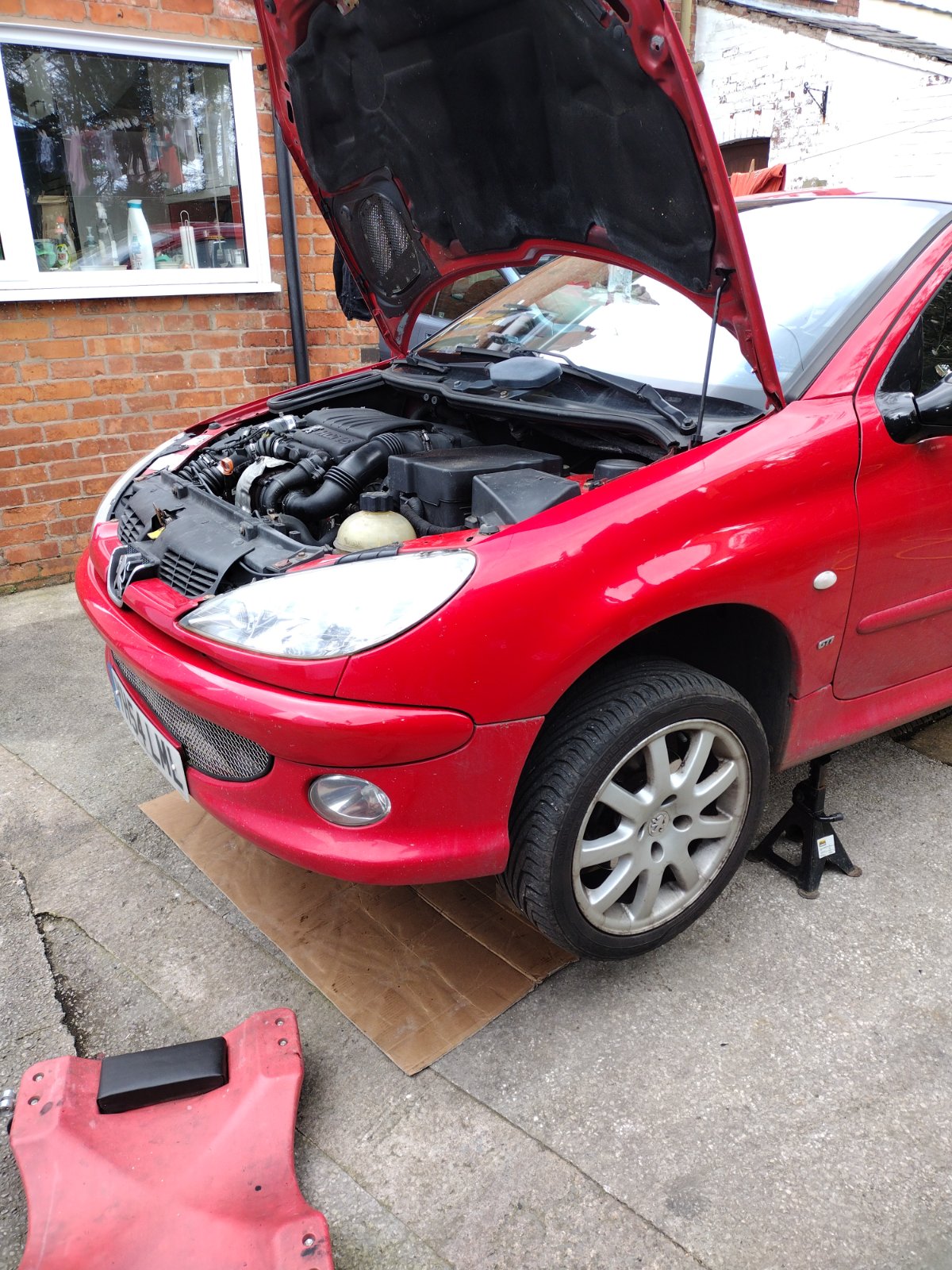

206's turn for a bit of TLC
Up at the front
Up at the front
Oil change, C2 spec 5w30 fully synthetic from GSF, Bosch oil filter "from stock"
Short change interval since last one slightly as thought would do it good and mostly as dropped the oil out last time on a Sunday afternoon and then discovered none of the four bottles of oil I've gathered were the correct C2 spec. So it's had a little go with some Mannol 5w30 fully synthetic cheap stuff (20 litre drum, worked out about £6 per oil change!) But concerned as not "low SAPS"
Can you spot what is unusual about this particular DV6 sump?
Other than I have painted it with some spare silver wheel paint!

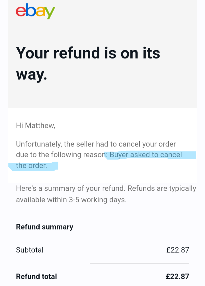

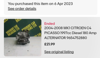

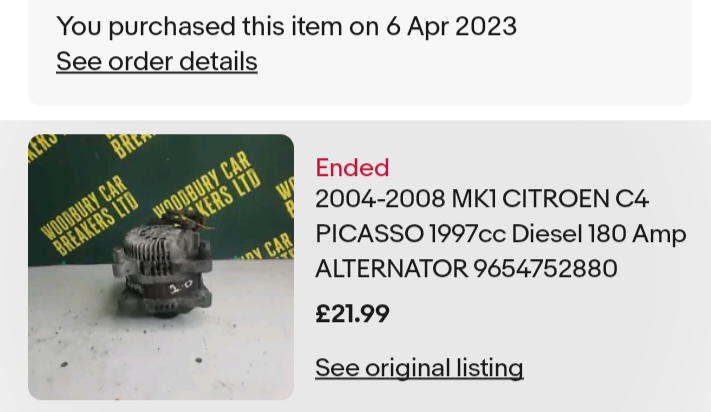

I thought I might get a second hand alternator ordered, if it was any better at maintaining the voltage, great, if not then I would try and flog it again to get my money back. Found a very cheap one in eBay and buy it now, jobs a good un.
First I'd heard of it, and I've done nothing of the sort!
Seems like I'm not going to be getting that one then. I've noticed sellers jumping on this reason for cancelling - presumably they don't get a black mark from eBay versus a more truthful "turns out we sold it locally" or turns out we priced it too cheap " or "we've lost it in the yard" or whatever the real reason is!! :evil: annoying, just glad I'm not stuck with car immobile waiting for this to turn up...

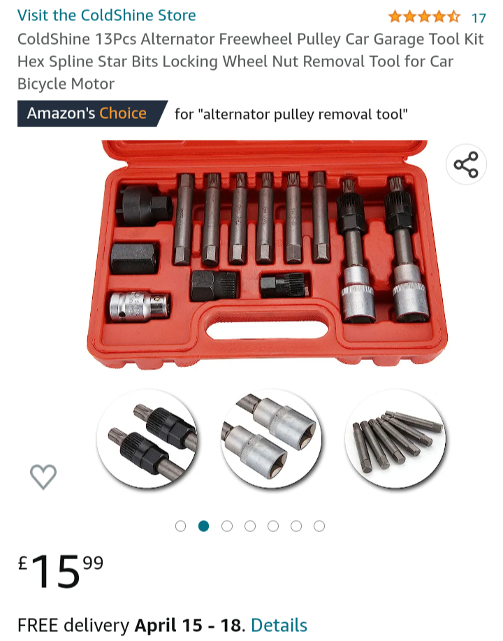

MattBLancs wrote: 06 Apr 2023, 16:37 ... but realised I'll need the "clutch pulley" tools in order to do that...
Amazon amazingly cheap tat is appealing
https://amzn.eu/d/8eTWf64
Less than £20 for a full set of tools (about £6 would get me one if the splined tools (minus the long reach Torx/Allen/whatever TBC bit to reach through the centre) coming from China off eBay.
Not yet clicked the button to get it ordered. Have nearly a full shelf of cheap tat in generally red plastic boxes! :-D
