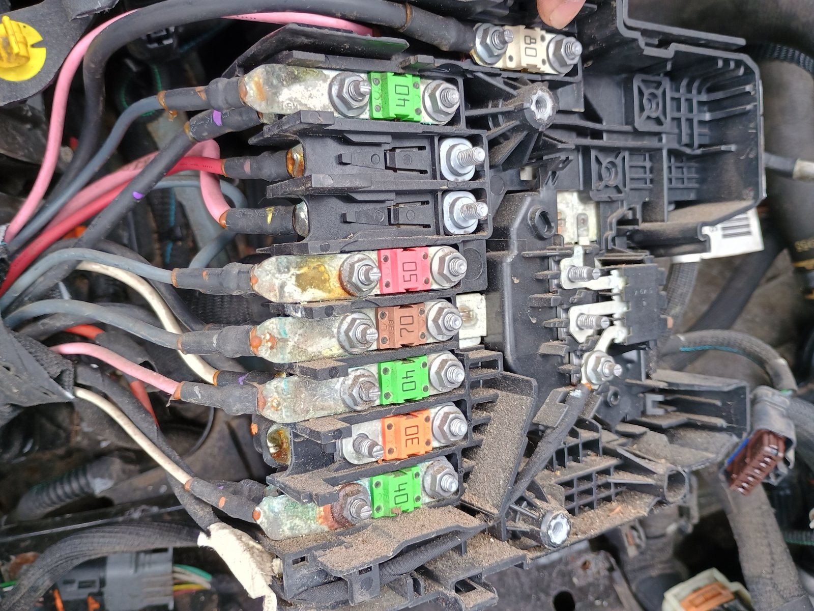

New item collected, a break in the weather so see if I can get this on the go...
And it says Valeo on the case of the unit.
Meter on continuity old fuses in the old unit appear to be intact.
Here comes the rain....
- Posts: 4054
- Joined: 25 Apr 2022, 09:03
- x 1839
Rain isn't giving up yet so a few more words whilst I cross my fingers it'll stop.
Battery on charge was showing 12.2 volts (not atrociously flat but worth topping up) also removed it from the car to get more room.
All the little M6 bolts removed are fairly crusty so into the phosphoric acid. When I get a break in the weather I will loosen off some of the terminals clean up each one with wire brush or wire wool, then back on the old unit loosely so as to keep the order/arrangement.
Relay within the centre of the unit appears to have two terminals that don't do anything!

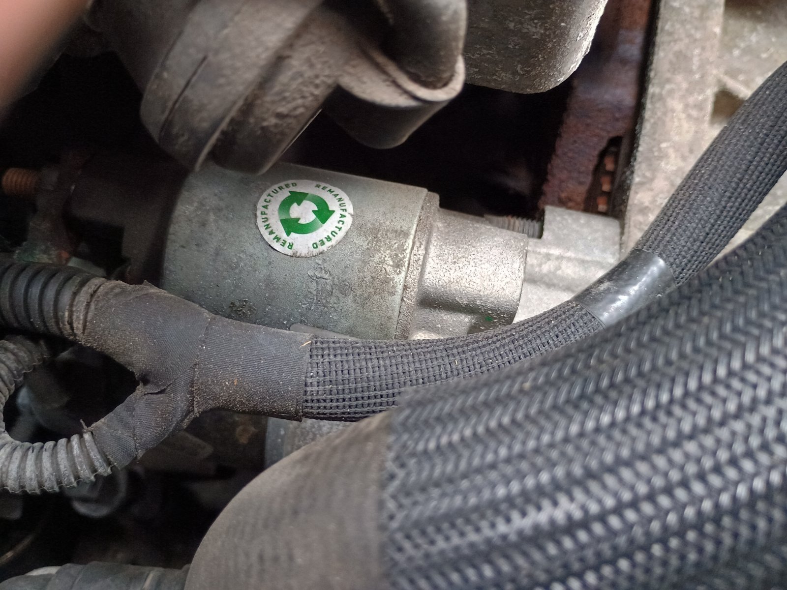

Starter motor has a remanufactured sticker. Service history consists only numerous dealer stamps so no clue when that motor was changed. As far as I can see there is no starter fuse: what I think is the heavy starter cable comes into the BPGA and doesn't appear to be fused.

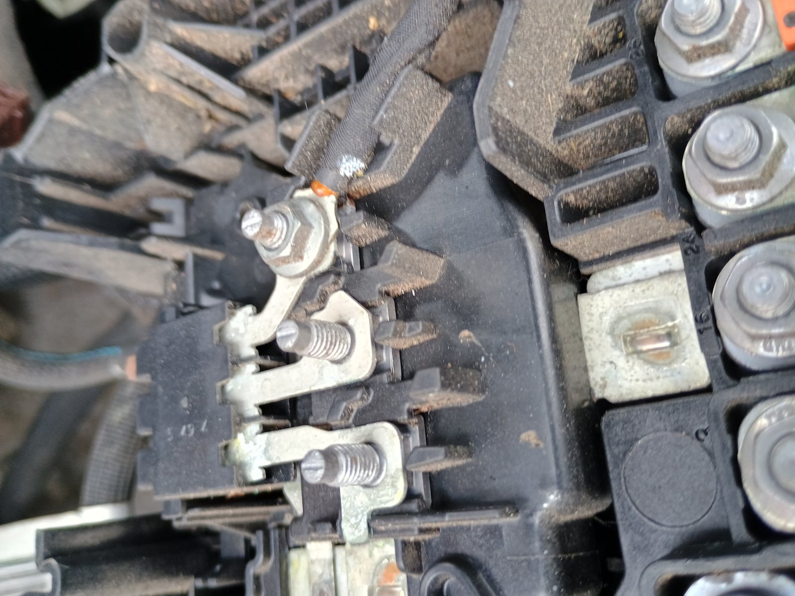

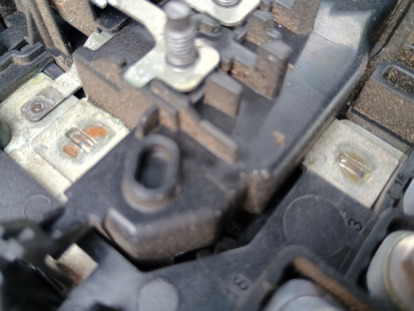

Images of old BPGA
No action but equally not too convinced I was doing the right action.
Tried wire between big starter motor cable and the (only visible) little pin on the motor.
Also tried battery positive to same small terminal.
Expected clunk of solenoid but nothing.
Also no significant spark when making connection (at battery end) - expected fairly heavy jolt as making connection. Nope.
Used a fairly low cross section piece of mains cable (to hopefully give some level of crude fuse!) but all in all undramatic.
Leading me to give up hopes of new joyriding career opportunity
And starter motor sticker
Had a go to hotwire it but clearly not enough of my youth was "misspent"

With another starter motor (formerly of C5, ruled out as rubbish, but wasn't!) different battery and some fresh motivation: I confirm that I should indeed have heard the solenoid clicking hot wiring as I was. Ie I was doing it correctly!!
Which suggests dead starter motor on the blue 308.
