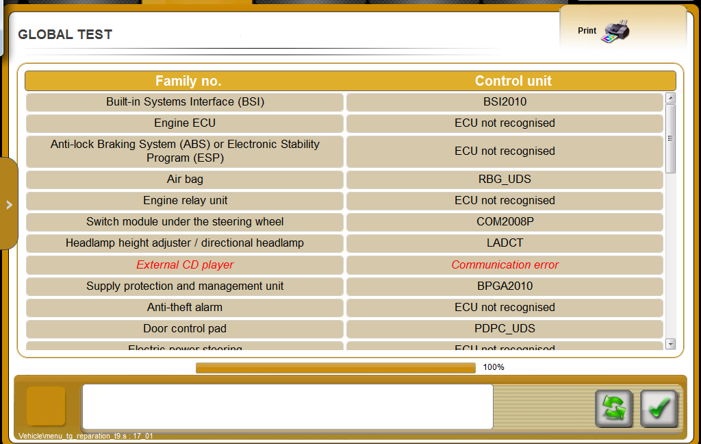

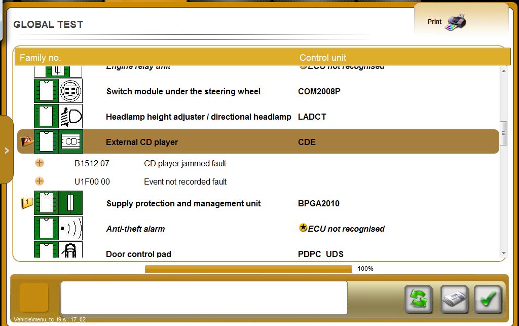

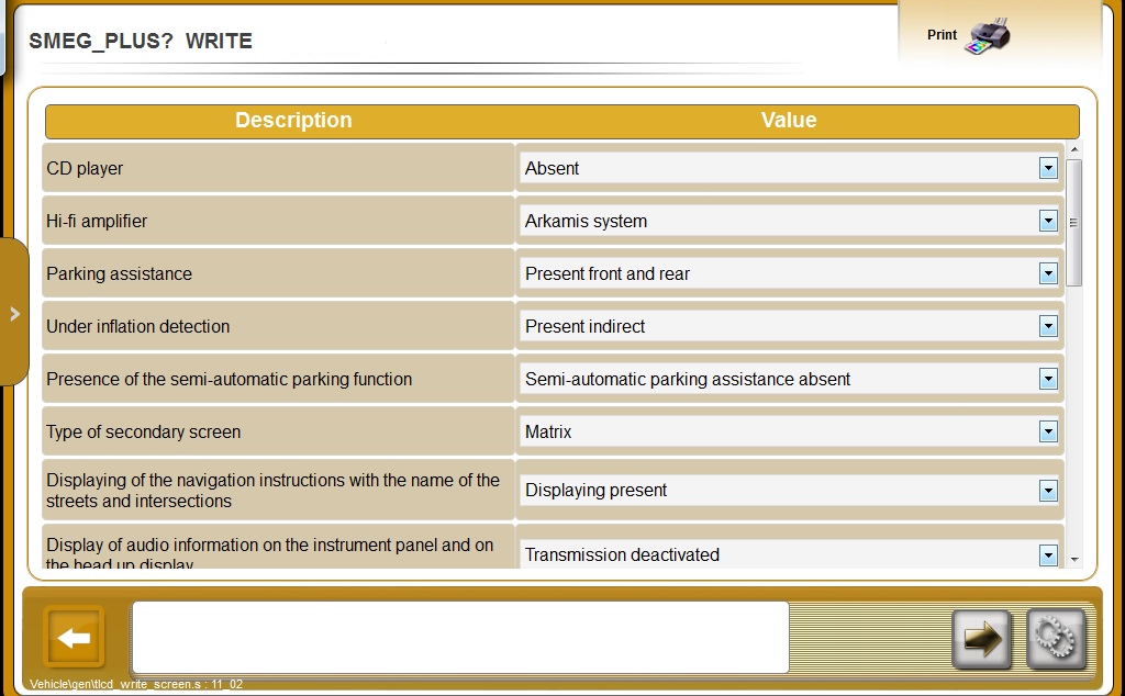

So I did the following:
Delivery of the vehicle,
Accessory,
External CD player

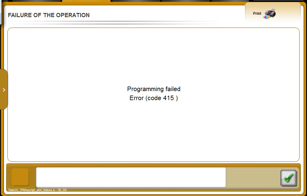

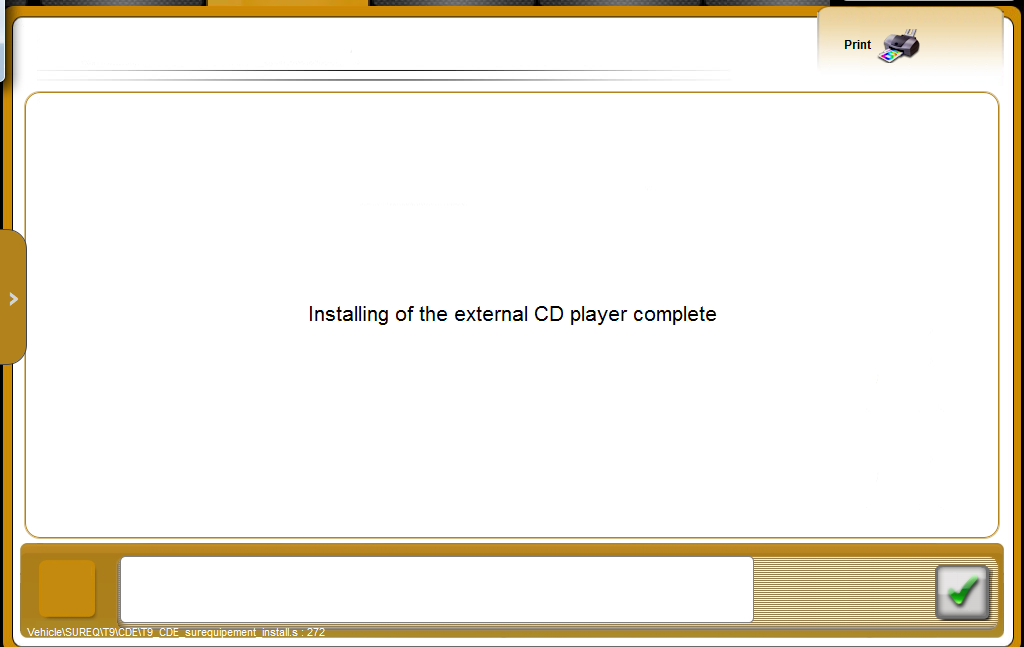

Installing of external CD player.
Chugged through various instructions. Had an error message. Then had installation of CD player complete.
Back to fault finding, CD player listed and shows two faults.
Cleared said faults.
Standard accurate tests.
Got it to eject the CD via diagbox.
Put CD back in again.
CD still not listed on the radio's choice of inputs.
Dashboard eject button still not working.
Hmm
Posts: 4029
Joined: 25 Apr 2022, 09:03
x 1834
Unread post by MattBLancs »

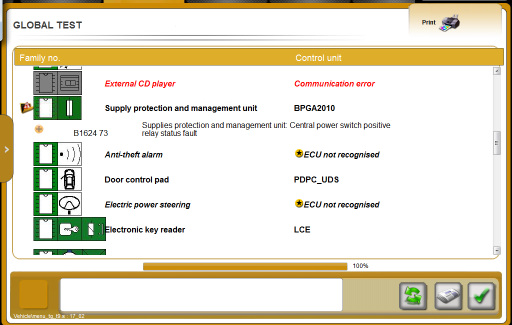

Back to fault finding.
External CD player says communication error!
Posts: 4029
x 1834

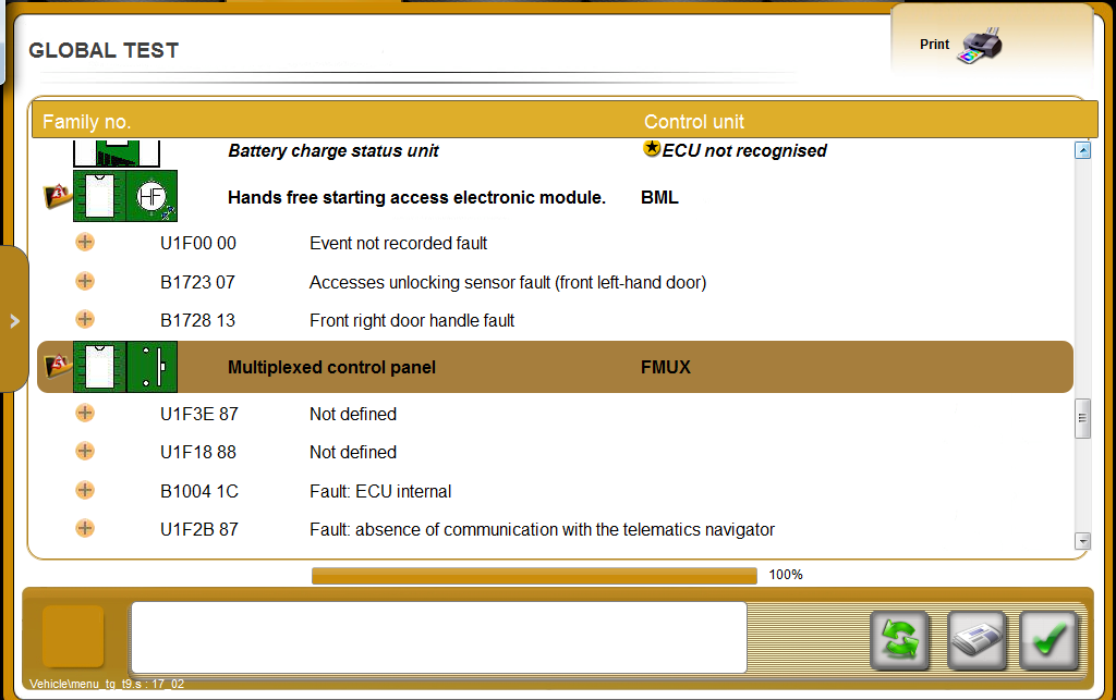

From that point on it has remained at "External CD player: communication error"

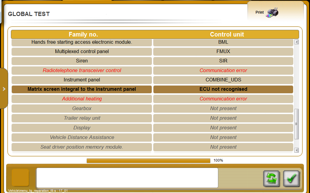

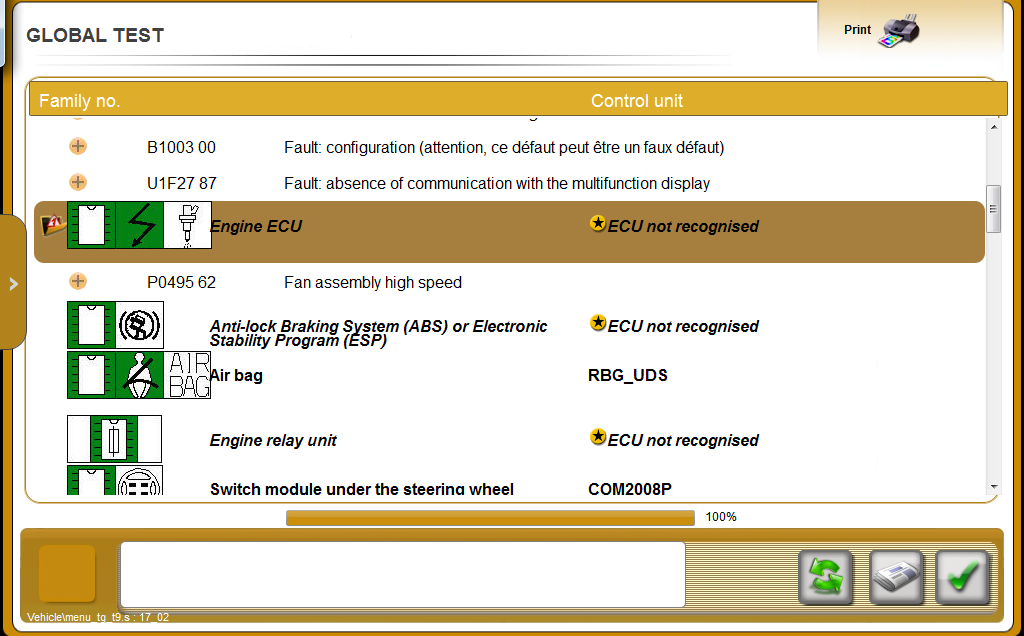

Various faults (logs up shortly) cleared. Some related to GPS antenna and the keyless start (which it confused me by calling it "hands-free starting" !!) remain, both of which I'm aware of.

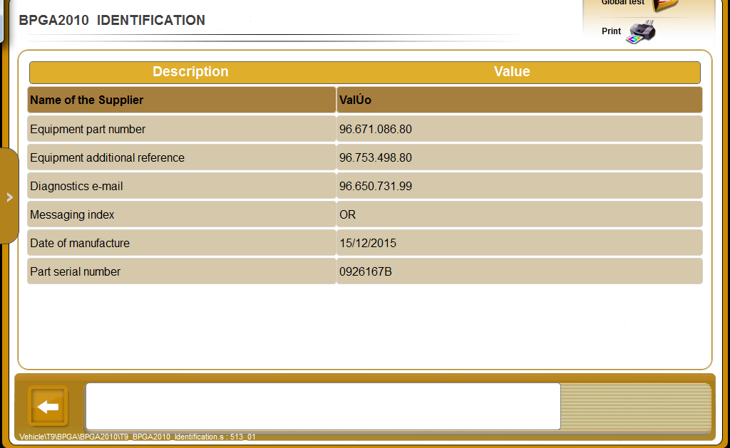

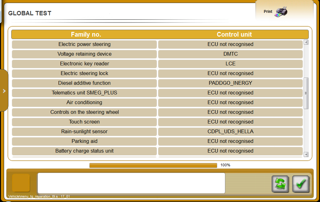

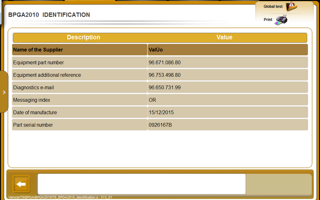

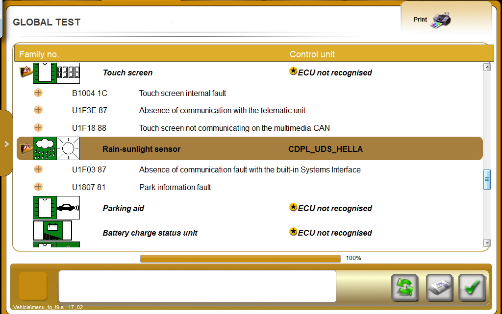

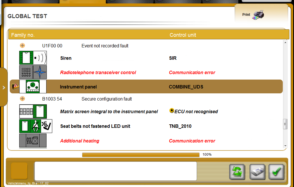

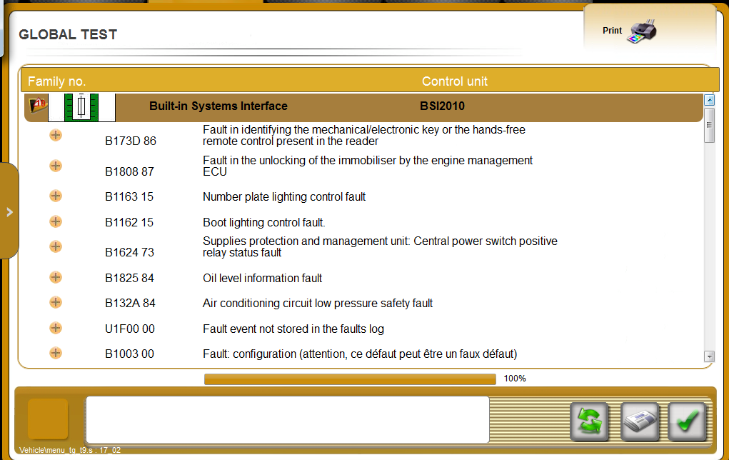

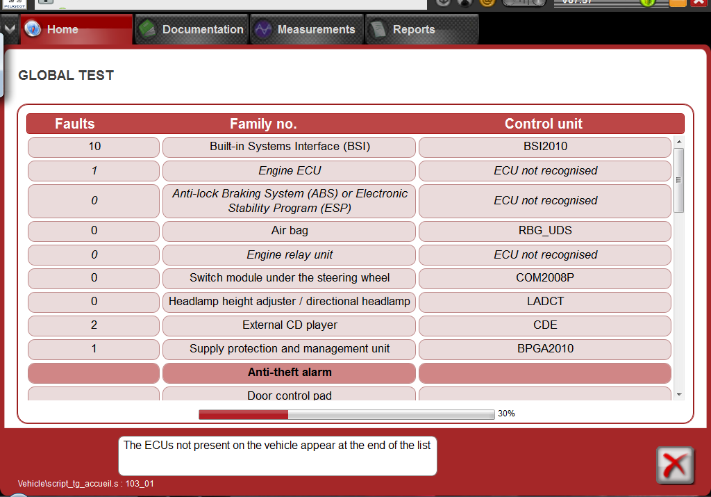

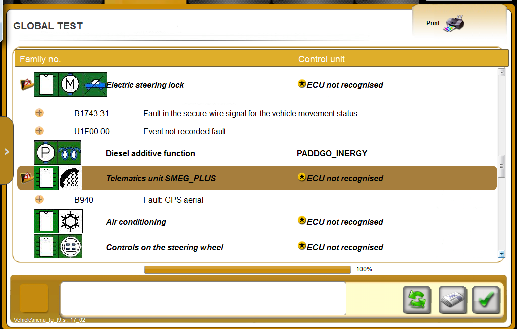

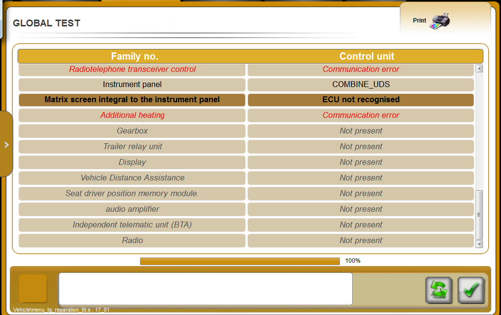

Very quick "data drop" of the diagbox print screens from yesterday, sorting out= to follow
blue 308 16.2.2025 cd changer installation after lots of connection attempts_060204~2.png

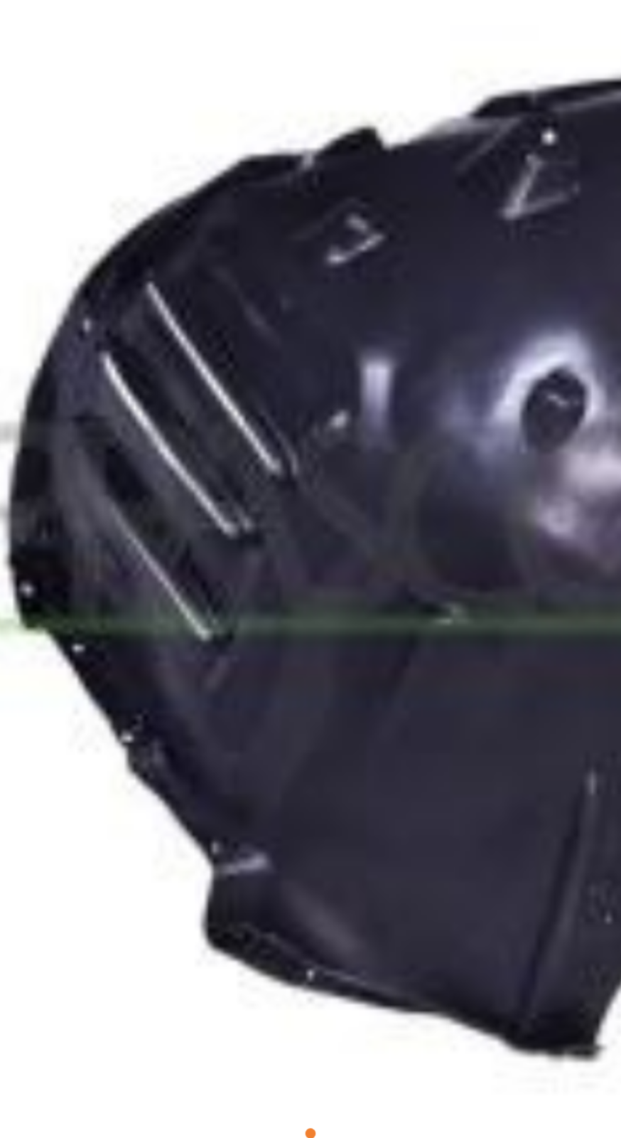

Previous discussion on the "wheel arch liner with vent" has today moved beyond the procrastination phase! I have been umming and ahhhing about this genuine £28.75 arch grille:
https://www.ebay.co.uk/itm/387636207335
Vs
Autodoc aftermarket arch liner with integral, rather crude slots, grille:
From Autodoc site
From Autodoc site
Which today's special offer has dropped it to £31.69 (plus p&p unless I bought other stuff)
https://m.autodoc.co.uk/prasco/14466067
Vs
A complete second hand arch and grille.
https://www.ebay.co.uk/itm/306068105737
This was up for £60. I put in a slightly cheeky Best Offer of £45 and to my surprise, rather than telling me to get lost; coming back with a counter offer; or (personally infuriating seller behaviour that I've come across before) just don't respond again all - instead it's been accepted.
Again, I'm pleased with that.
:-D
