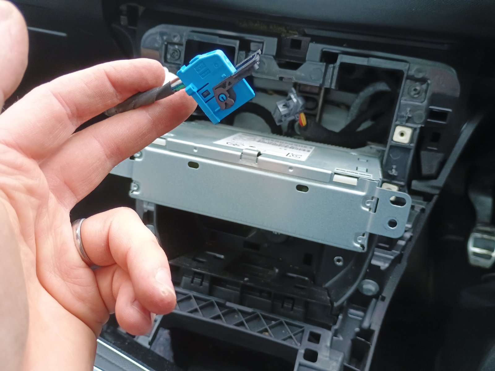

MattBLancs wrote: 05 Feb 2025, 06:46 No description but pretty clear video for the blue 308 radio removal
Currently looking at this YouTube video. Which seems to omit details like only unscrewing one screw on the right and there's a matching one on left!
Fortunately I then remembered Mark has kindly emailed me a set of instructions too.

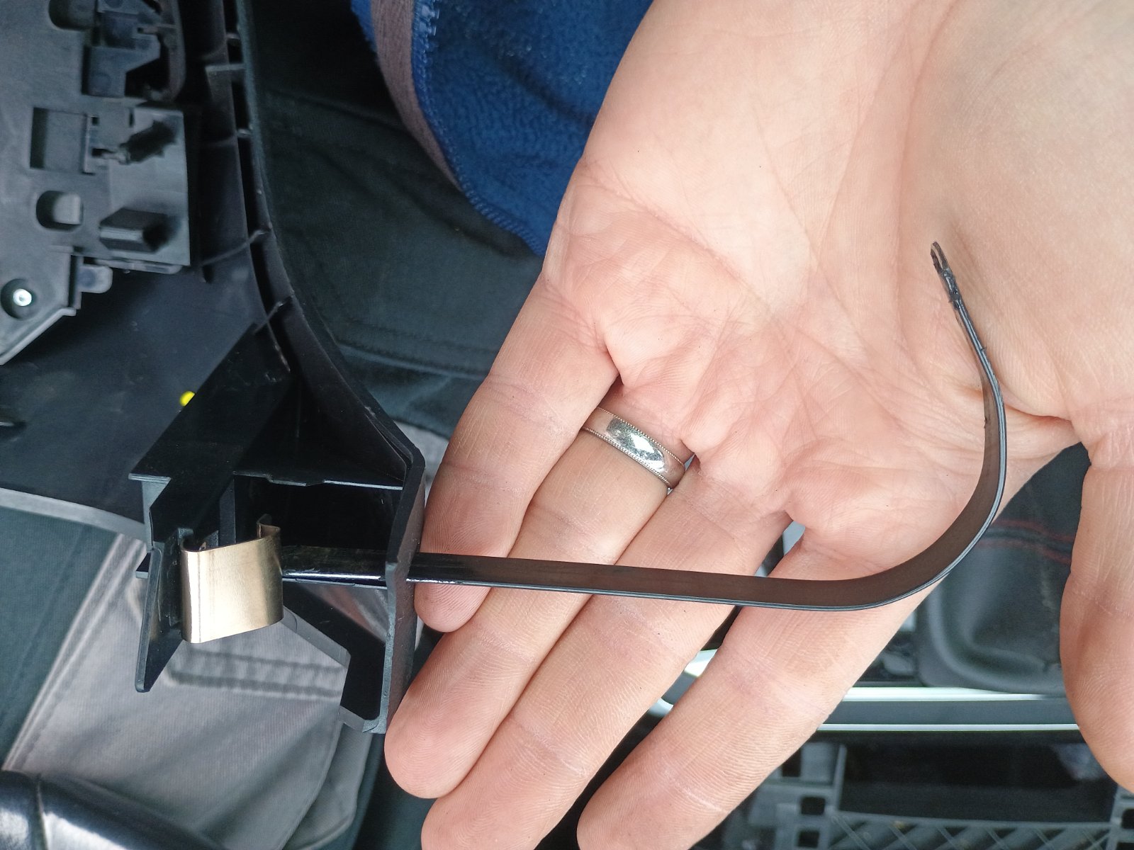

Special tool number one created: shown in action on the new trim piece
Raw materials kindly provided by Bosch as part of their wiper blade range :rofl2: (formerly a wiper blade obviously!)

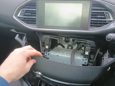

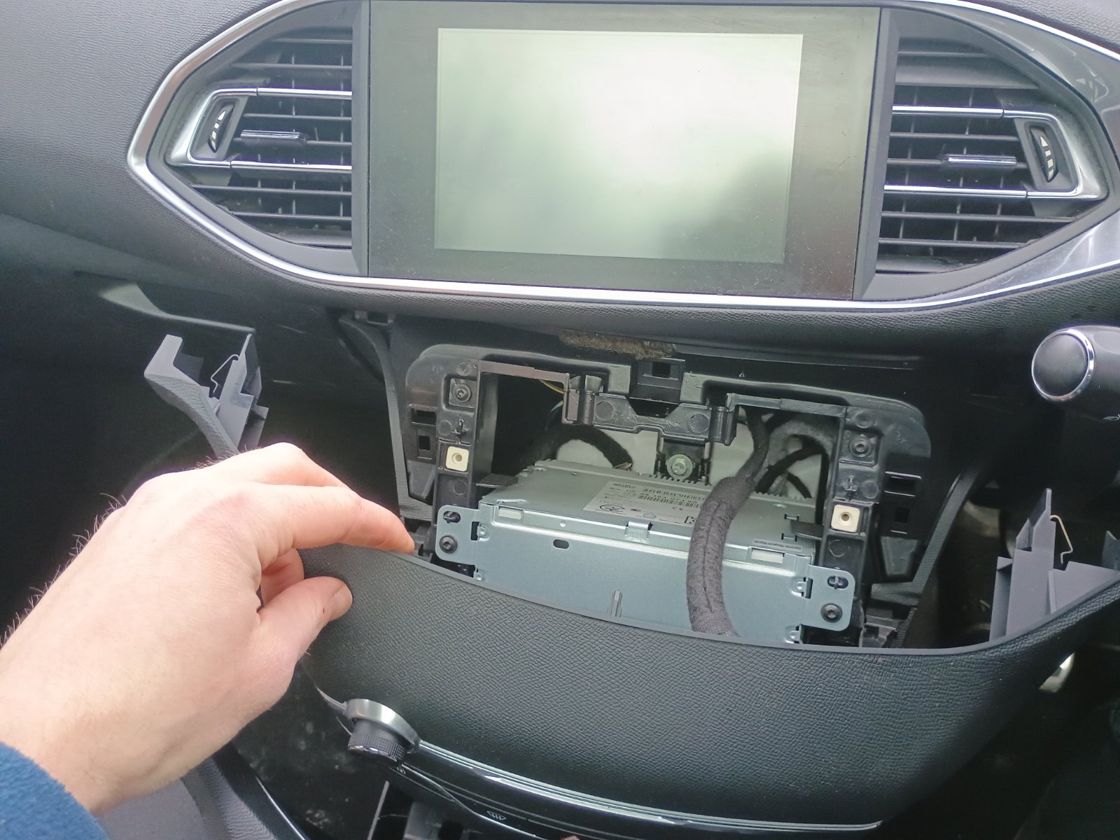

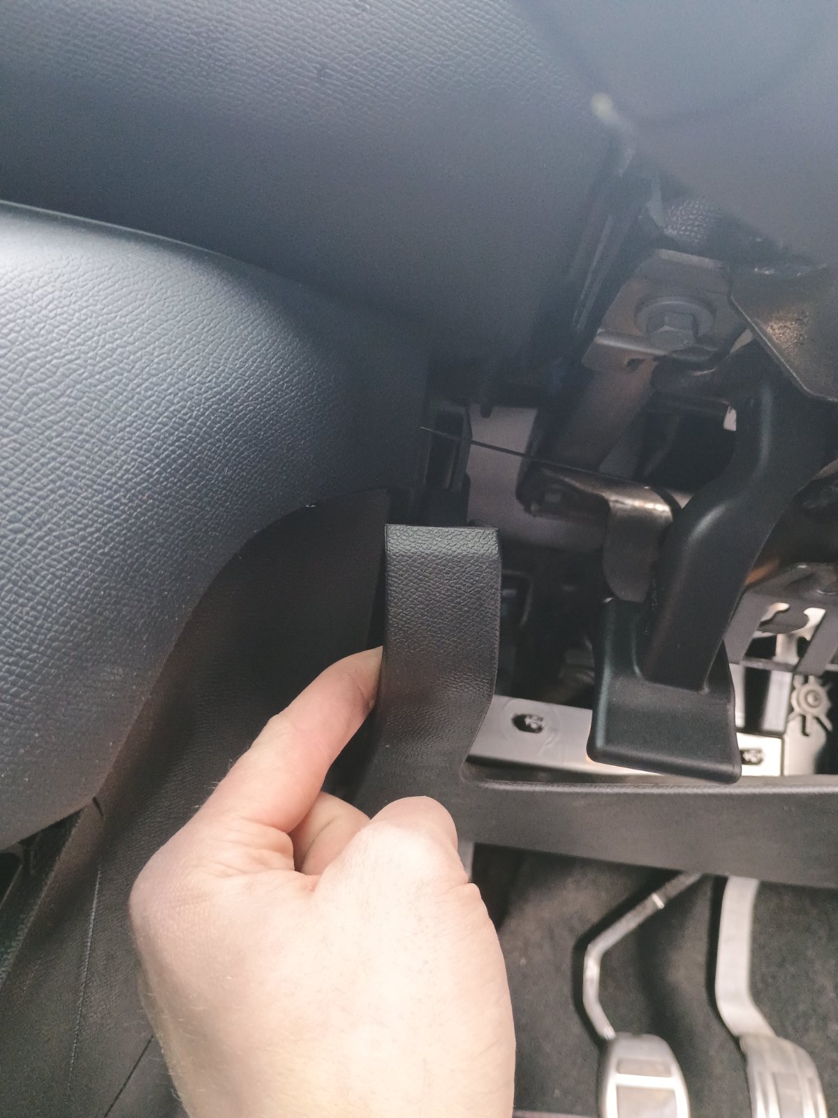

That was awkward!
The instructions are for the left hand drive which must be easier as only the steering column shroud is in the way of slot to access the fixing nearest to the wheel.
Other side is visible once the glove box is open - piece of cake!
Posts: 4054
Joined: 25 Apr 2022, 09:03
x 1839
Unread post by MattBLancs »
A CD player sized hole!

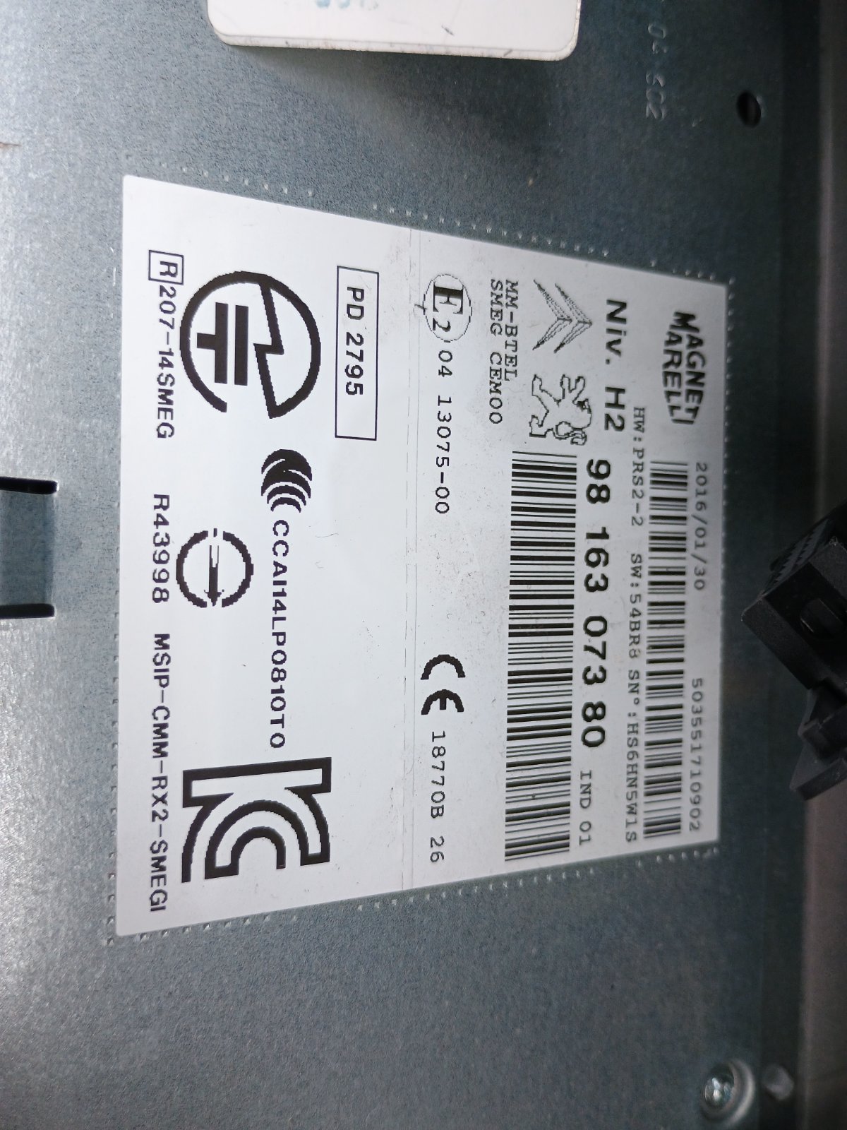

For future reference specifics of the current head unit
new cable plugged into the head unit connector as per my trial on the other 308.

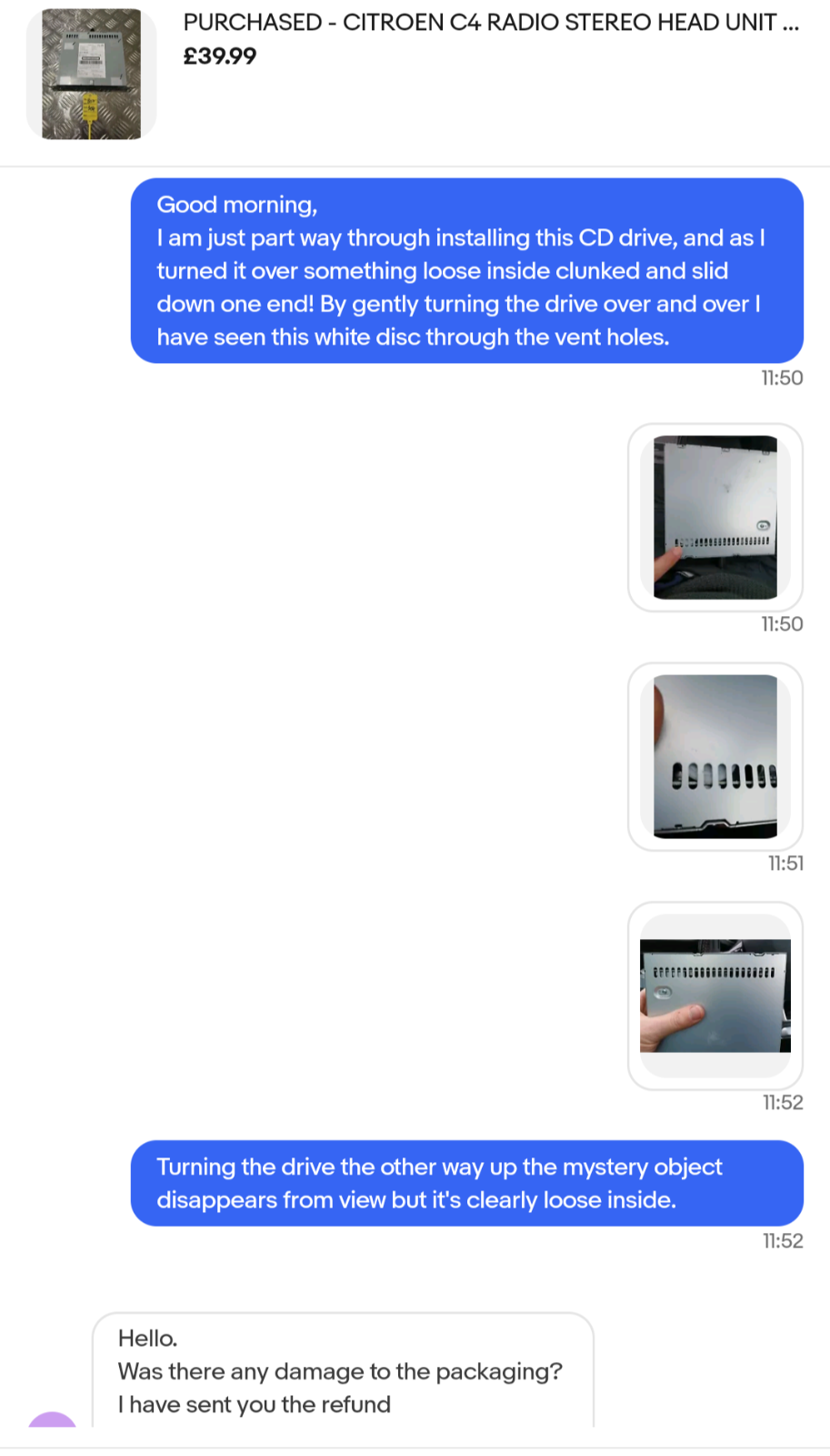

Well, it got interesting!
I'll let this print screen do the talking:
eBay chat with seller

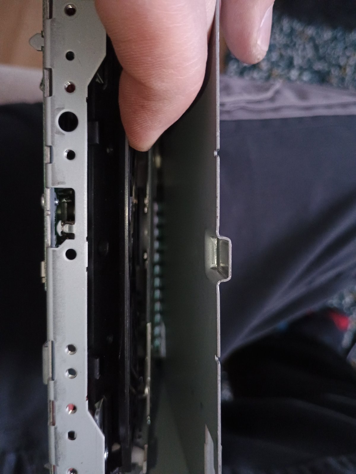

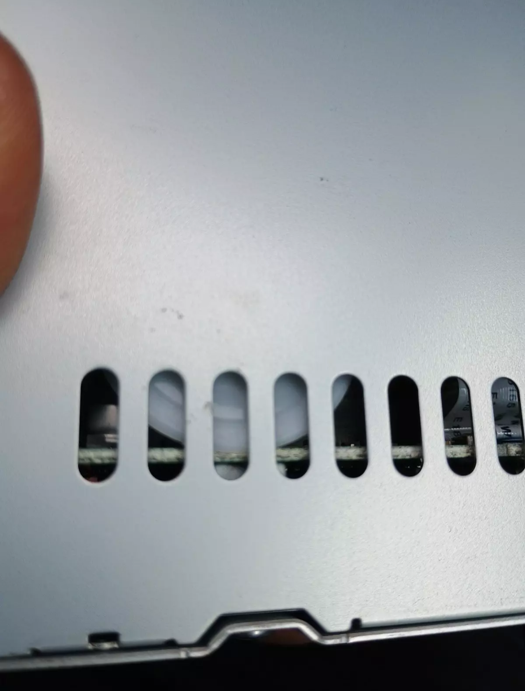

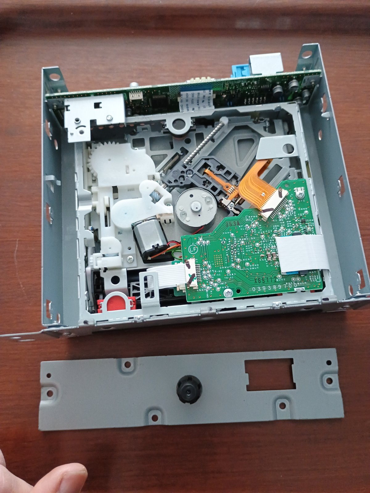

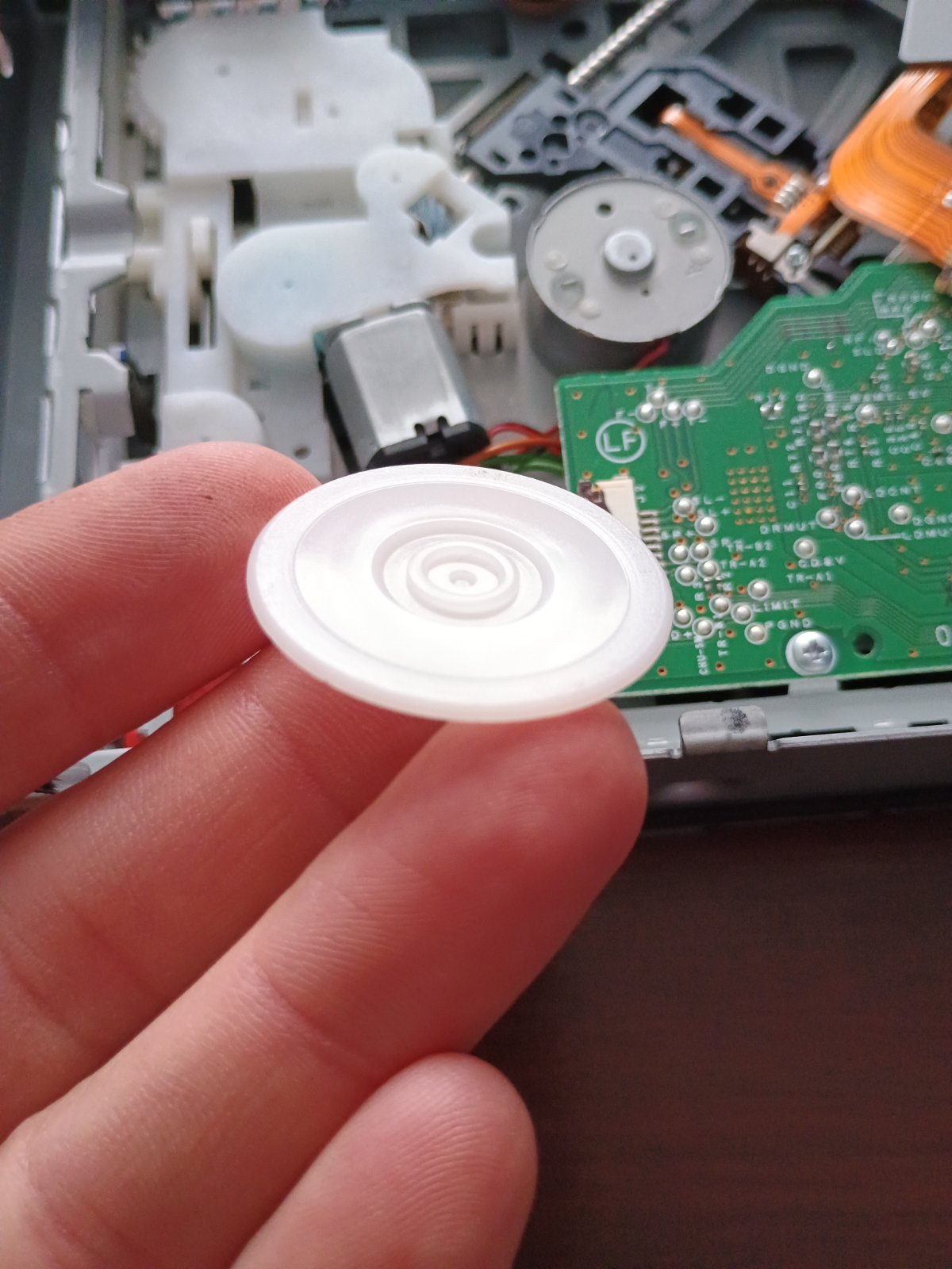

So, given it has now, much to my surprise! become a free CD drive, it's time for a spot of open heart surgery....
Inside the drive
Inside the drive

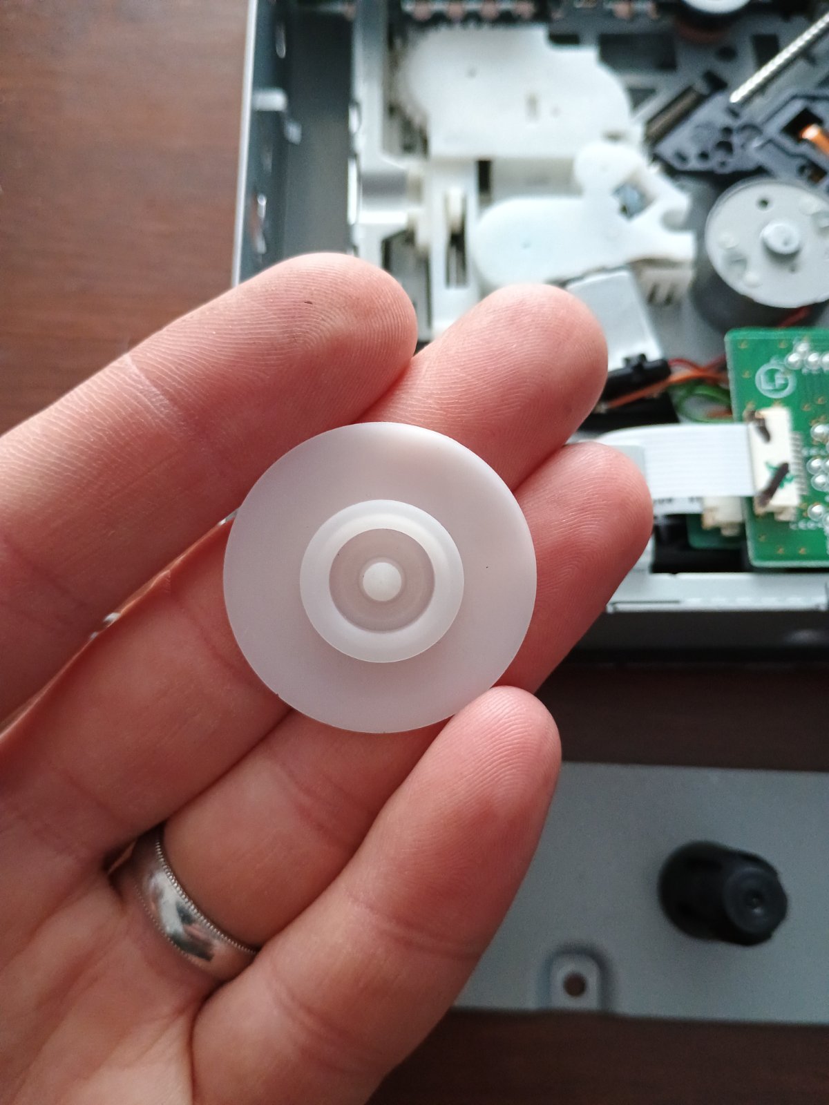

Mystery object
Mystery object
Ah, it's one of those, things, then!?
Other side
Other side
It sits fairly unconvincingly on top of the motor. Would need a blob of glue to remain there which doesn't seem right.
Posts: 4054
x 1839

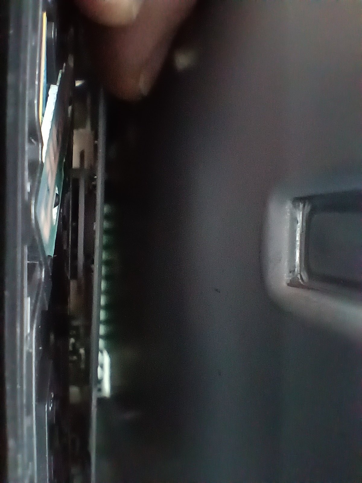

So, it sits above the CD and the motor pushes disk up against it. A shaped spring steel feature gets hold of it.
Can't get better access without moving a very stuck down ribbon cable, so "open heart" now switched to keyhole! Think we have a fix so reassembly next :)

Drive is back together, no rattling and no spare bits! :D

mickthemaverick wrote: 16 Feb 2025, 14:03 In the tone of Donald Sutherland in The Dirty Dozen "Very pretty indeed, but does it work?" :-D
Not yet, but promising -
Drive plugged in, a short whirrring noise (note: whirrring not scraping/grinding/graunching! Taking that as good news!!)
But not yet recognised by the car. Diagbox laptop on charge (and I am inside for "refuelling too!) so on with that next

Ok, good news: it's taken a CD.
Bad news, it doesn't yet want to give it back!
