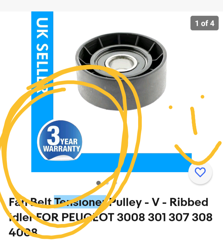

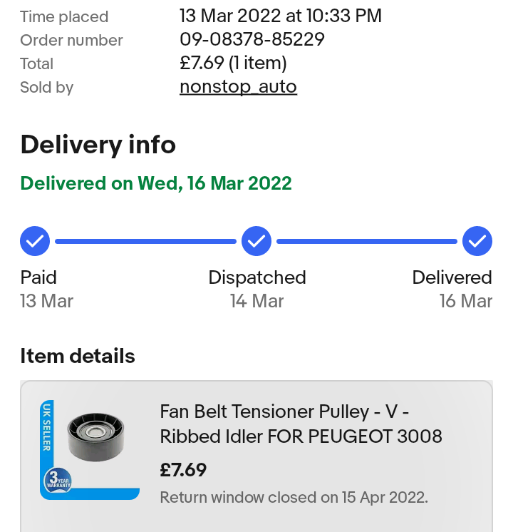

C5 it's had a bit of a "whirring bearing noise" of late, crept up on my really and much more noticeable outside the car (or with the window open)
Coming home tonight it seems to have very much stepped up a notch in volume, so suspect something handing it's notice in shortly!
Candidates as follows:
Auxiliary belt tensioner pulley bearing.
Pulley was noisy when I bought the car, new pulley fitted from eBay 13th march 2022. Rather sad if that's dead already but equally it was £7.69 Inc delivery so perhaps "buy cheap: buy twice" has kicked in there...
alternator bearings
Has just tripped over 147,000 miles on way home, perhaps the bearings in this have had enough. Previously my 306 had noisy alternator bearings (was still charging fine) maybe C5 has same? Second hand £22 alternator (from a 407) sat in garage ready to go (bought when I wondered if my headlight brightness varying with power steering pump load was normal - but not fitted at the time.
timing belt tensioner pulley bearings
Don't want to think about this option! Belt and pulleys about 13 months old, Autodoc, decent brand: Dayco kit, included water pump.
alternator bearings

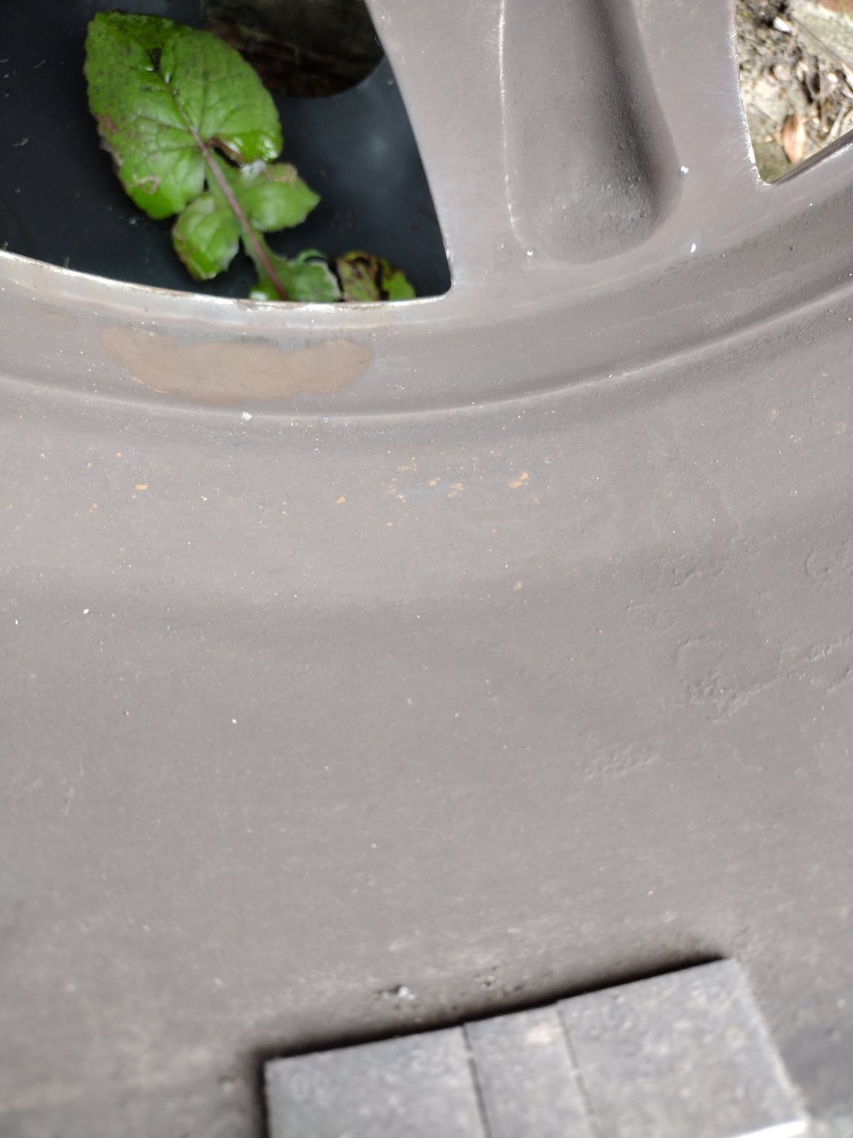

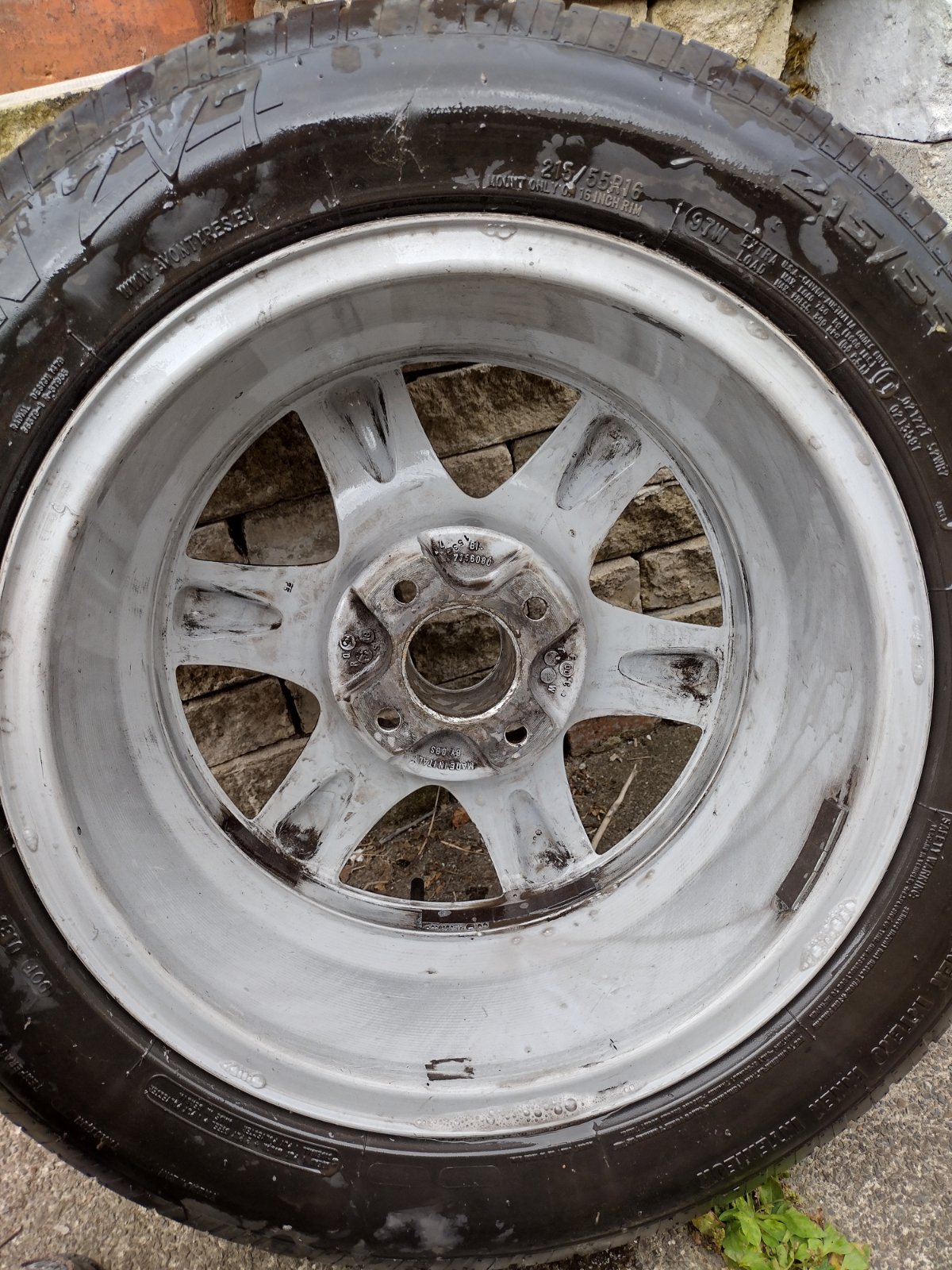

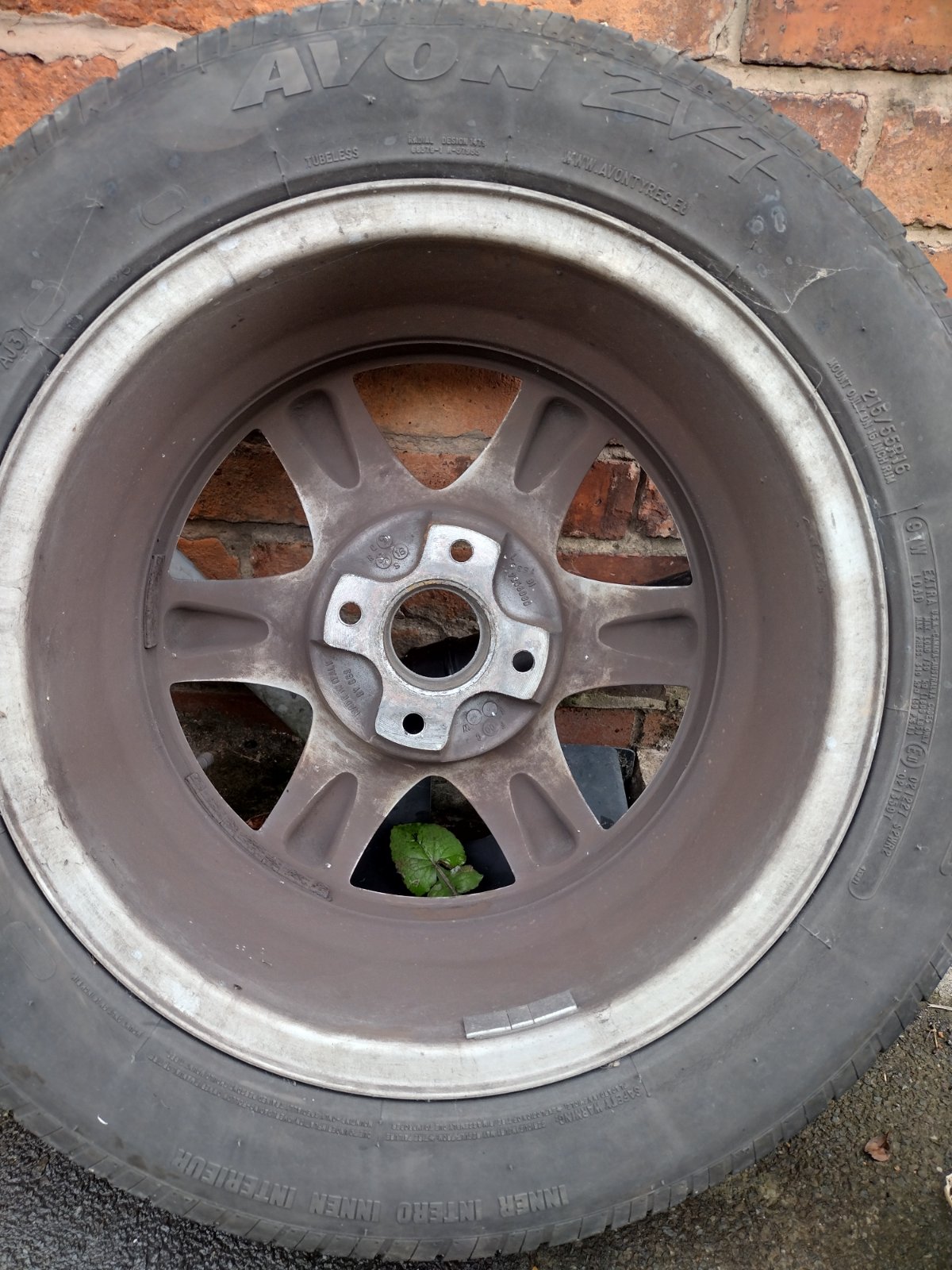

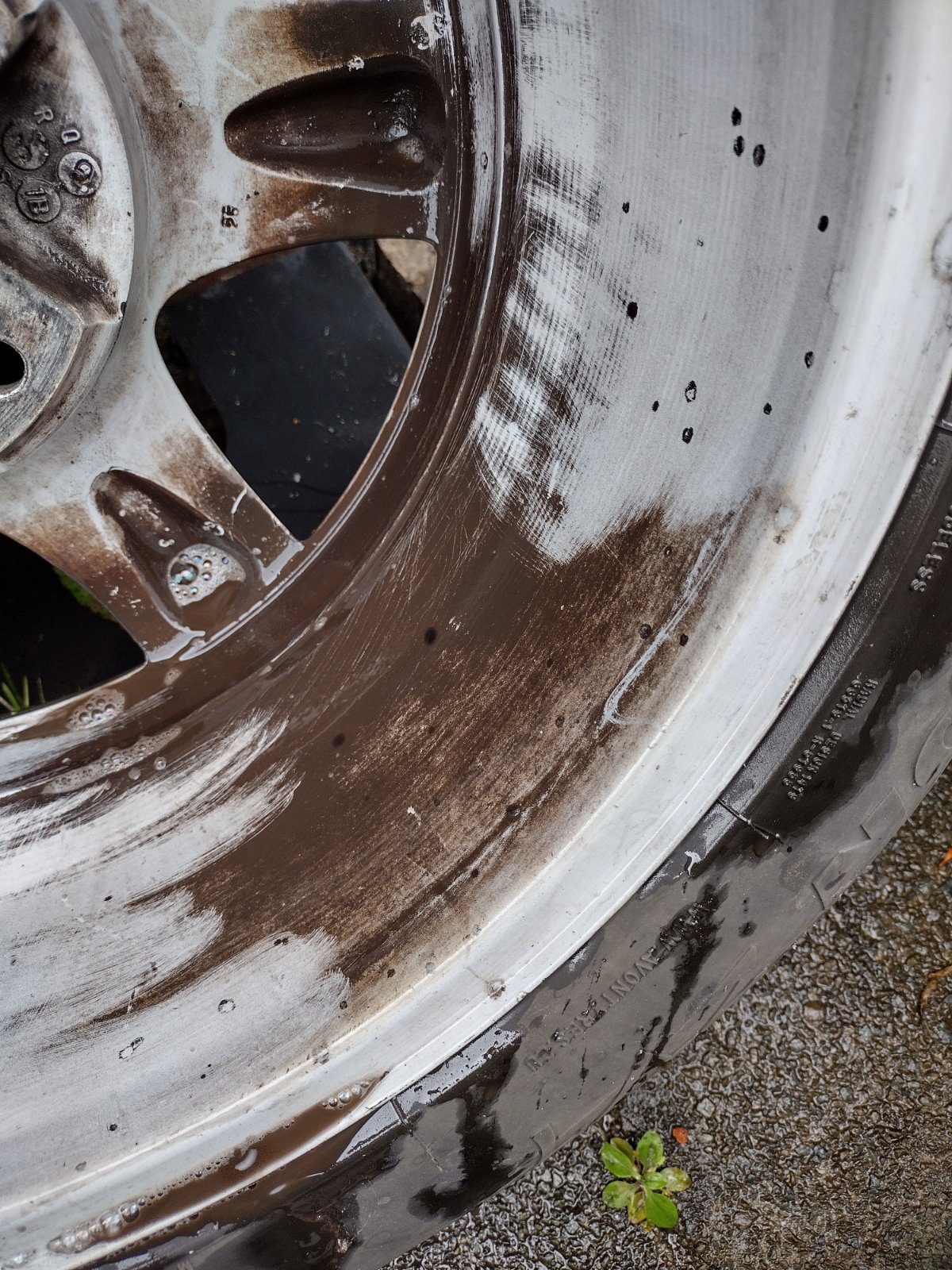

Before:
Wire wool, old sock warm water and bit of washing up liquid. Yes none of these advisable for a delicate paint finish but yet to find anything else as effective!
During
After:
Not perfect but ran out enthusiasm and thought about to be rained off! Wire wool, old sock warm water and bit of washing up liquid. Yes none of these advisable for a delicate paint finish but yet to find anything else as effective!
- Posts: 16262
- x 6851
Nice work Matt, as a point of interest I use the K2 alloy cleaner on heavily soiled wheels, spray on leave until whole wheel gone purple and jetwash off. Worked fine on the backs of my last C5!!

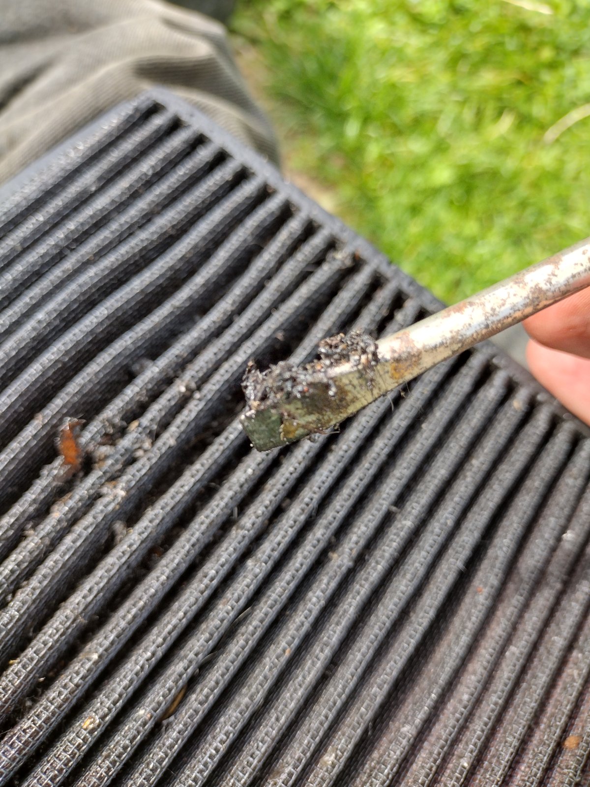

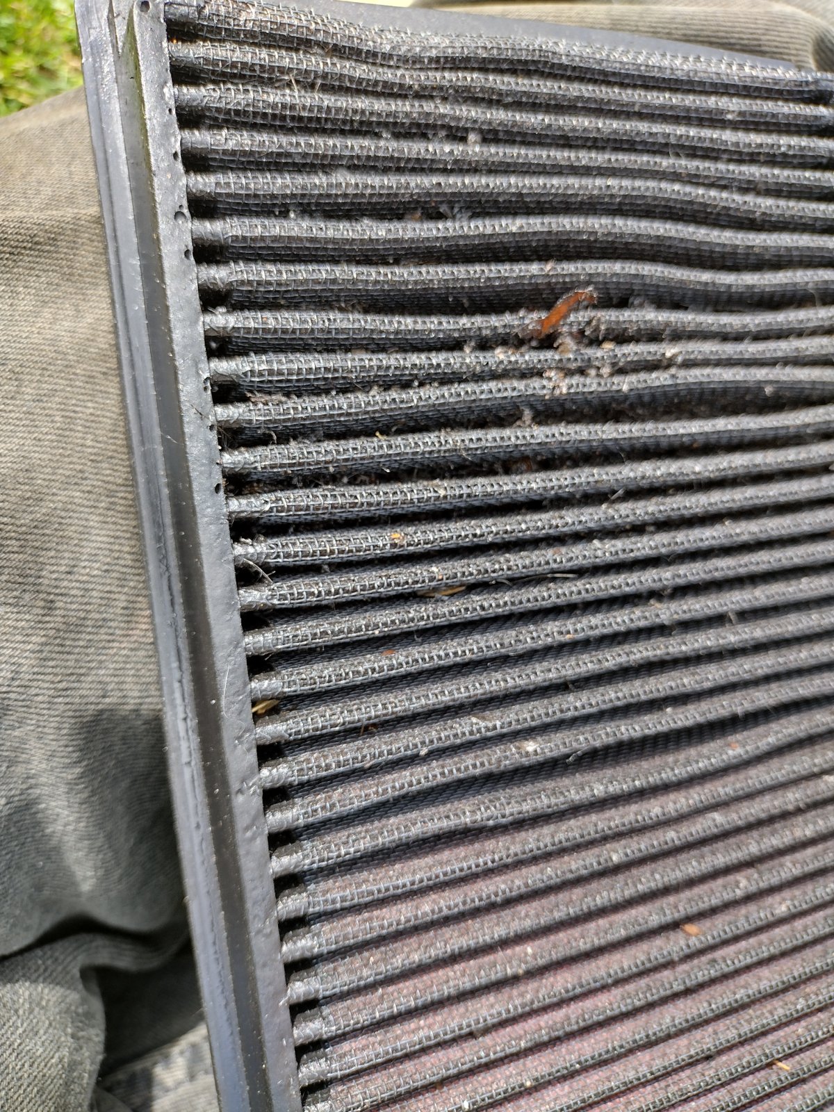

Just a reminder, K&N lifetime filter= does need a clean! Yuk!
