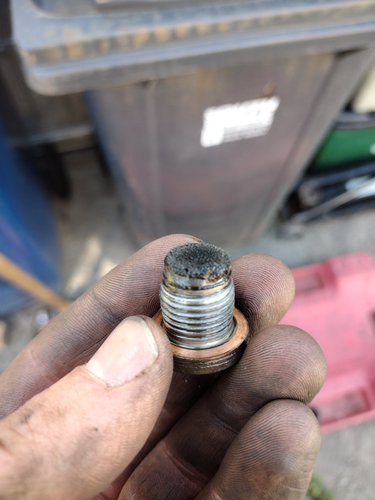

Those drain plugs sometimes have a slight 'D' section Matt, which does make a standard square a poor fit... Again a bit of grinding works wonders... That was an excellent bit of work to grind a perfectly accurate hexagon on the square :cool: I'm well impressed :D

I've used this adapter lots of times and normally it's a pretty good fit, perhaps as you say this plug perhaps is a little different. Should have actually paid attention to it's recess once removed, but here's it's "Hedgehog"
Magnetic 'hog
Magnetic 'hog

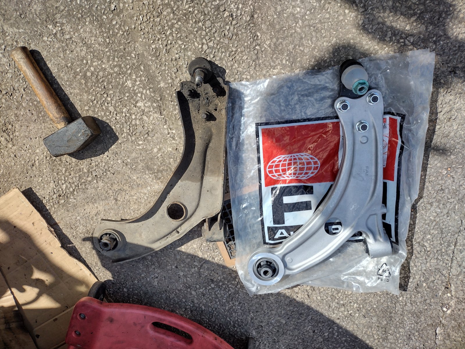

Wishbone replacement went ok, other than I did the rearmost bush's bolt last and it massively fights you to get the bolt aligned with the subframe!! Will do that one first on the other side.
Rusty old, alloy new

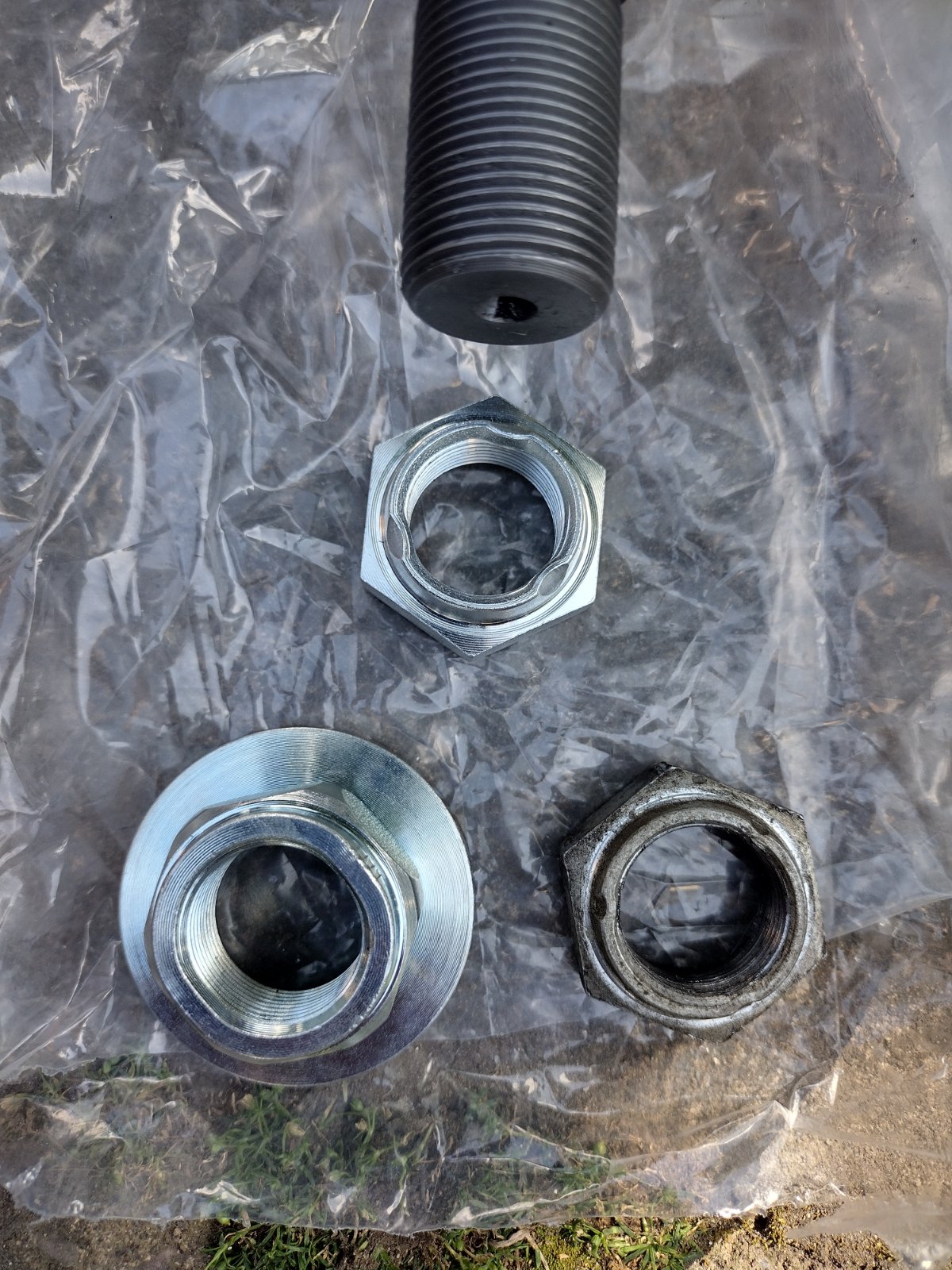

Interestingly, the new SKF driveshaft for passenger side has a nut which matches that taken off.
Not so much interesting, more "annoyingly" the other new driveshaft, also SKF, doesn't include a new nut.
I've decided to get my eBay driveshaft nuts on the go instead - again "self locking" but with huge integral free spinning washer.
Nuts, nuts glorious nuts!

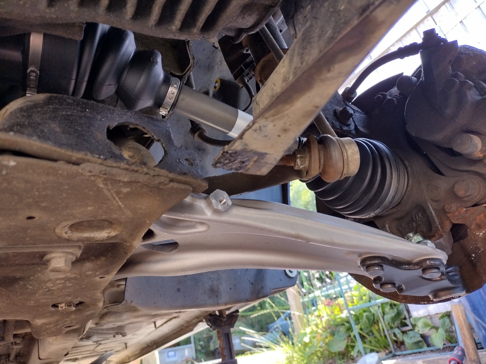

Final image, the finished side:
New 'shaft and new 'bone

Good work Matt :D 20 litres of gearbox oil will see you good for years now! And scoring it at a good price too - result! I nearly fainted at the cost of it when I bought my last couple of litres of Total BV when I changed Bluebell's :shock:
