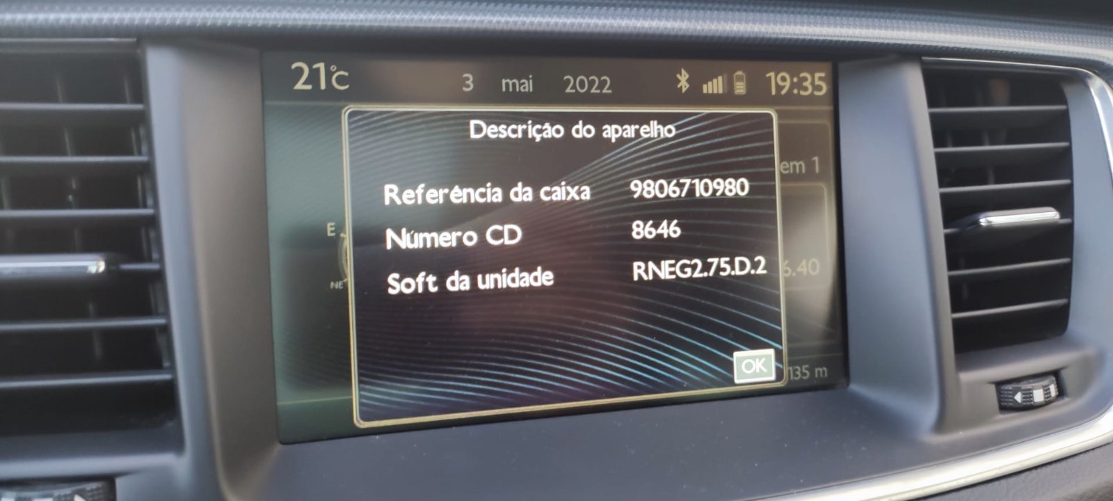

I just recently bough an Peugeot 508 fropm 2014, and I have noticed that the gps maps are from 2013/2014 and I think my firmware is outdate, can someone help me out on what I have so i can search for updates?
This is the version i have
Thanks in advance

You have the RT6 System.
Here is the official site for Peugeot map updates:
https://peugeot.navigation.com/home/en_ ... otEMEA/GBP
You have firmware 2.75. The latest and last firmware is V2.86. This may need some calibrations applying or reconfiguration after updating to 2.86, although my information for the 508 and your current version of firmware (2.75) suggests that you should be able to update it without going to the dealer for reconfiguration.
However, to be on the safe side, I would suggest you take a backup copy of the user data files from your current system, so that if it does lose settings, you have the means to restore them.
Read the Mirascripts Part A of the linked topic below for information on how to copy the user data files over.
The part on restoring the files (only if needed) follows towards the end of the guide Mirascripts Part B.
This is the guide on replacing the internal MicroSD card, ignore all that apart from the Mirascripts sections.
How to Replace the Internal MicroSD Card - RT6
