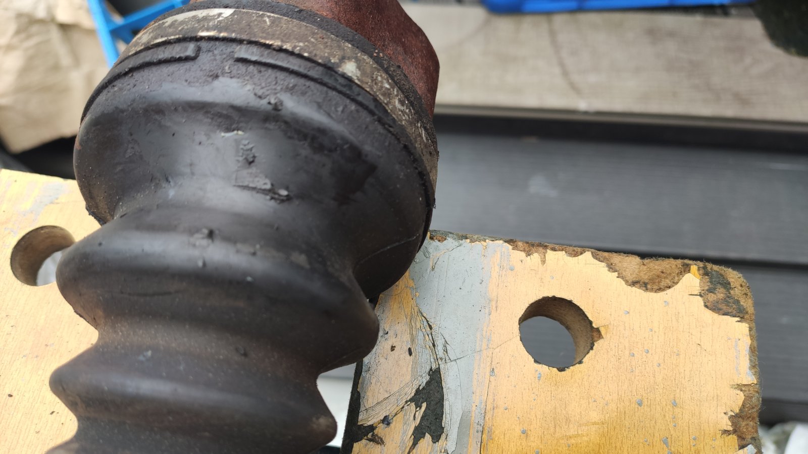

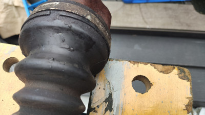

My gopher ( next door neighbour's son) has been dispatched under the car and has come back with lots of pictures and has been pushing, pulling and levering the bits I can no longer reach. Upshot is that up inside the undertray was dried and crusty grease from what appears to be the nsf inner CV boot area. Closer inspection shows a nick on the very inner edge of the boot so I have ordered a replacement drive shaft as I suspect the inner tripod joint is dry and now wearing. I was going to repack the front shaft joints but I have decided to fit a replacement shaft. Once it is fitted I will report back. Plus any interesting photos of the tripod joint - any wear will be minimal but a worn inner joint can cause vibration. We will see.

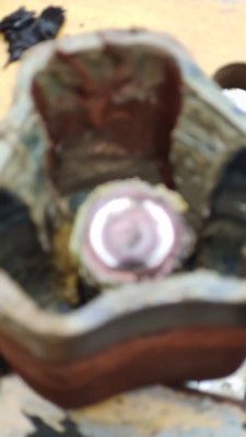

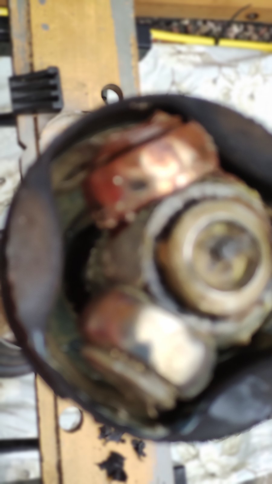

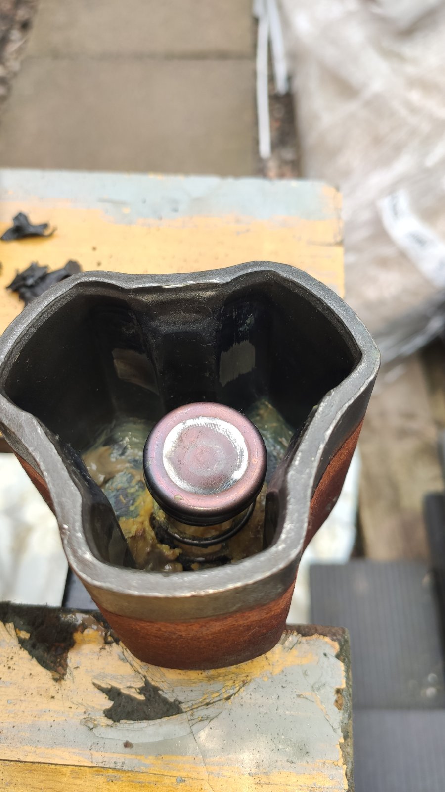

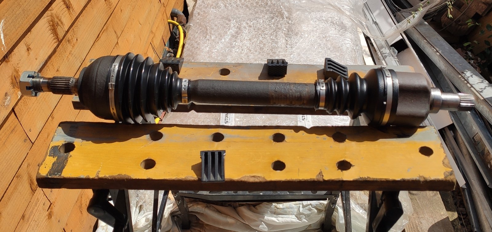

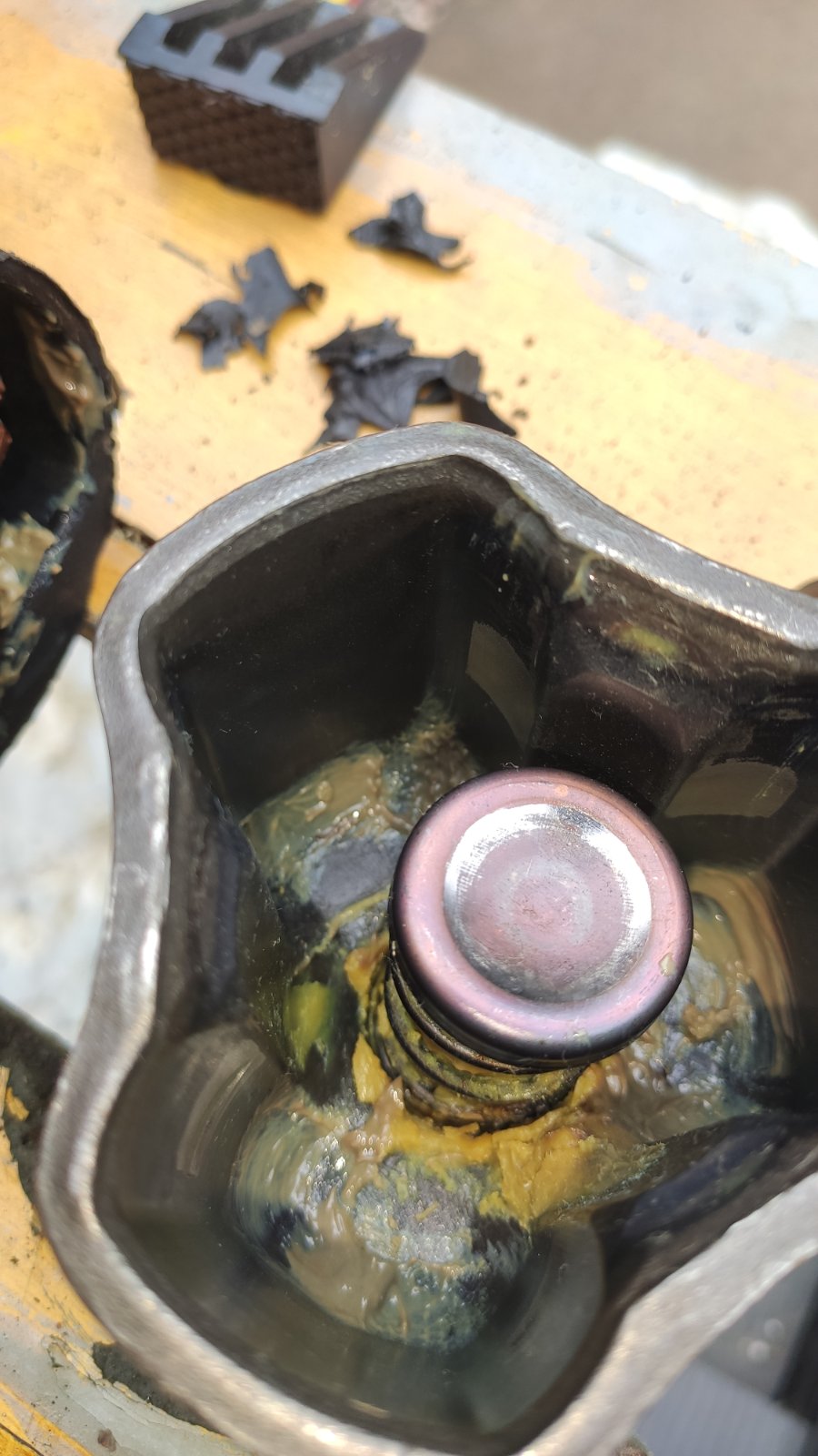

After a fair period now I finally have some pics to put up of the worn drive shaft inner tripod joint. I acquired a low mileage driveshaft from an identical model to ours and stripped it down and refurbed it at a fraction of the exchange price from Peugeot - the prices for shafts are in another blog on this subject elsewhere.
As Peugeot driveshafts for this model have staked on tripod spider wheel carriers and not circlips, I decided it was better in the long run to to have a shaft ready to put in so the car did not sit idle while the parts were sourced. Plus, I couldn't have done the crawling about myself anyway. I am ok when I am standing at a bench or a ramp.
The garage who has been looking after our cars would not change the driveshaft for us so that set us off on a quest to find a reliable garage that would do the job for us and that threw up an unexpected issue/explanation. The original shaft had a blob of silicone sealer over the cut in the inner CV boot! I don't know exactly where or when this happened but it explains how the joint ended up dry. Silicone sealer does not stick to rubber and the grease just centrifuged out.
Anyway, pictures. the refurbed shaft I prepared earlier.
The old shaft The small nick that caused all the problems.

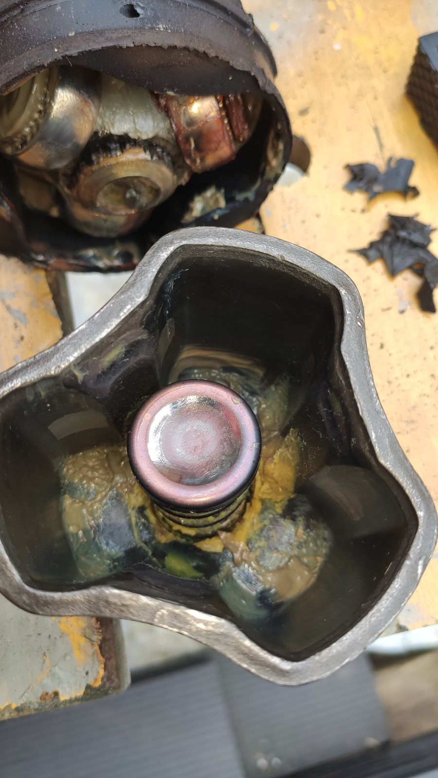

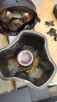

The shaft as dismantled showing the lack of grease

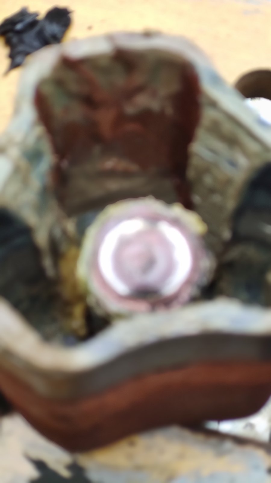

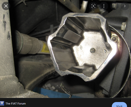

What a tripod shaft should look like on taking apart What a tripod sleeve wear pattern should look like What the wear actually looked like No wonder I felt a severe vibration!
PS the car is running perfectly now with no vibrations!
