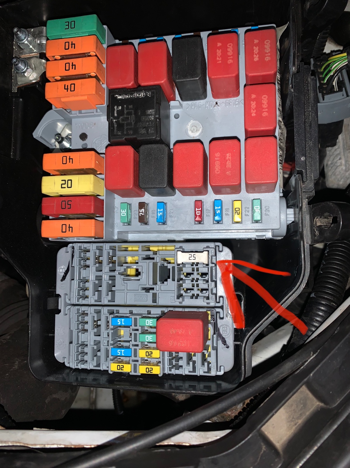

Hi thanks for the welcome. So I've narrowed the problem down to a fuse that keeps blowing but I'm struggling to find out what the fuse is for. Does anyone have any idea of what this is for or have an up to date fuse diagram for a 66 plate citroen relay please. Photo attached. Thank you.

Is it a "new" style (Jumper/Relay III) or the older mkII?

Yes it is a 2016 relay.

Sorry, i thought 66 plate meant 2006
I'm not used to the UK registration system..
Sadly i do not have Sedre/wiring diagrams for such new cars.

Ford Puma engine or PSA engine?
