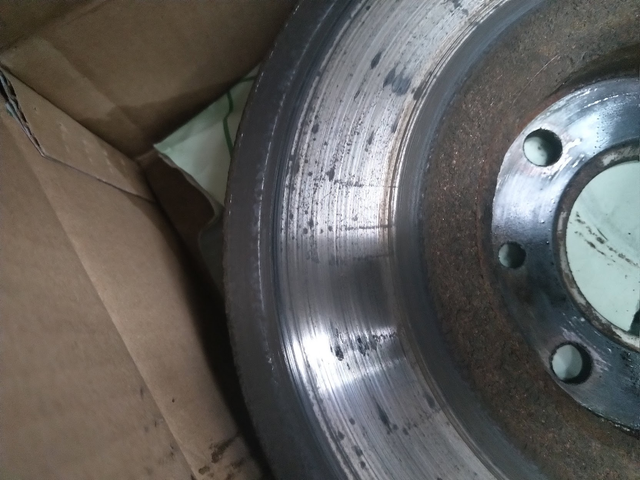

Anyways, my VTS has had a service done in 2016 at the dealer. That was done by the previous owner, brakes on all four corners and the timing belt + water pump. That was done 30 thousand miles ago, five and a half years. It was all good until I decided to replace the front brake discs and pads because I had a steering wheel wobble under braking. It turned out that the discs were the culprit, but I've also seen that the discs weren't a particularly quality item. They were quite rusty and inner braking surface wasn't being used whole, there were rust stripes on the outer and inner edge. Something not present now.
On brake pads was written "Eurorepar" which makes me believe that the timing belt is also Eurorepar. And led by the experiences with the brakes, I really have no faith in Eurorepar parts quality.

Etching on discs, has the car been standing idle for sometime during lockdown ?

Car is driven usually once a week if the weather's nice, around the countryside. This is what one of the discs looked like, side facing towards the engine bay.
