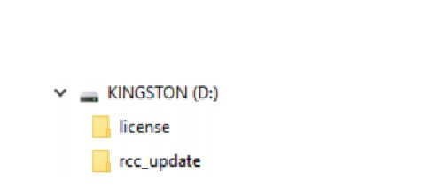

OK I will do that - So I unpack these and add them to the USB stick like I did last time

I see this file does not have a licence file - will I need that or does it not matter ?

No, as long as the car is running, the on-board WiFi will verify the update and authorise it via it's own connection.
