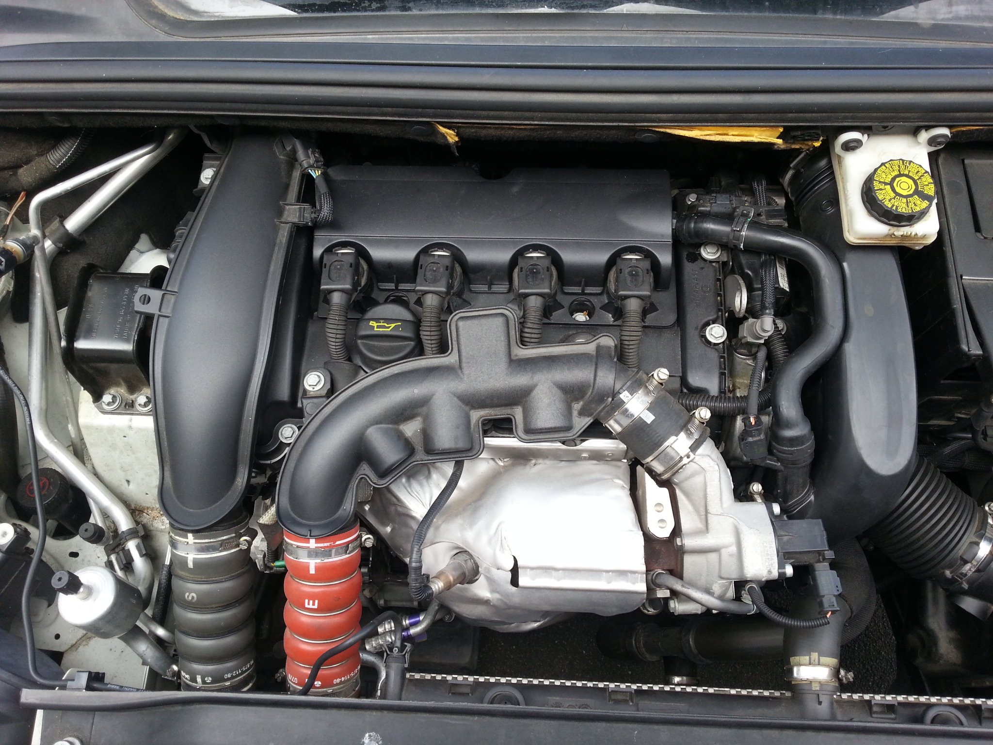

Your issue with hot air in the cabin could be due to a fault with the heater flap control motors (which is fairly common on PSA vehicles of that age), or it could be that the Air Conditioning refrigeration system is not operating and not cooling the air.
If you look under the bonnet on the (UK) drivers side near the radiator you will see some aluminium pipes and an aluminium cylinder (bottom left of this picture)
That cylinder should be quite cold to touch with the engine running and the A/C turned on. If it is not cold, then some more diagnostics are probably required.
