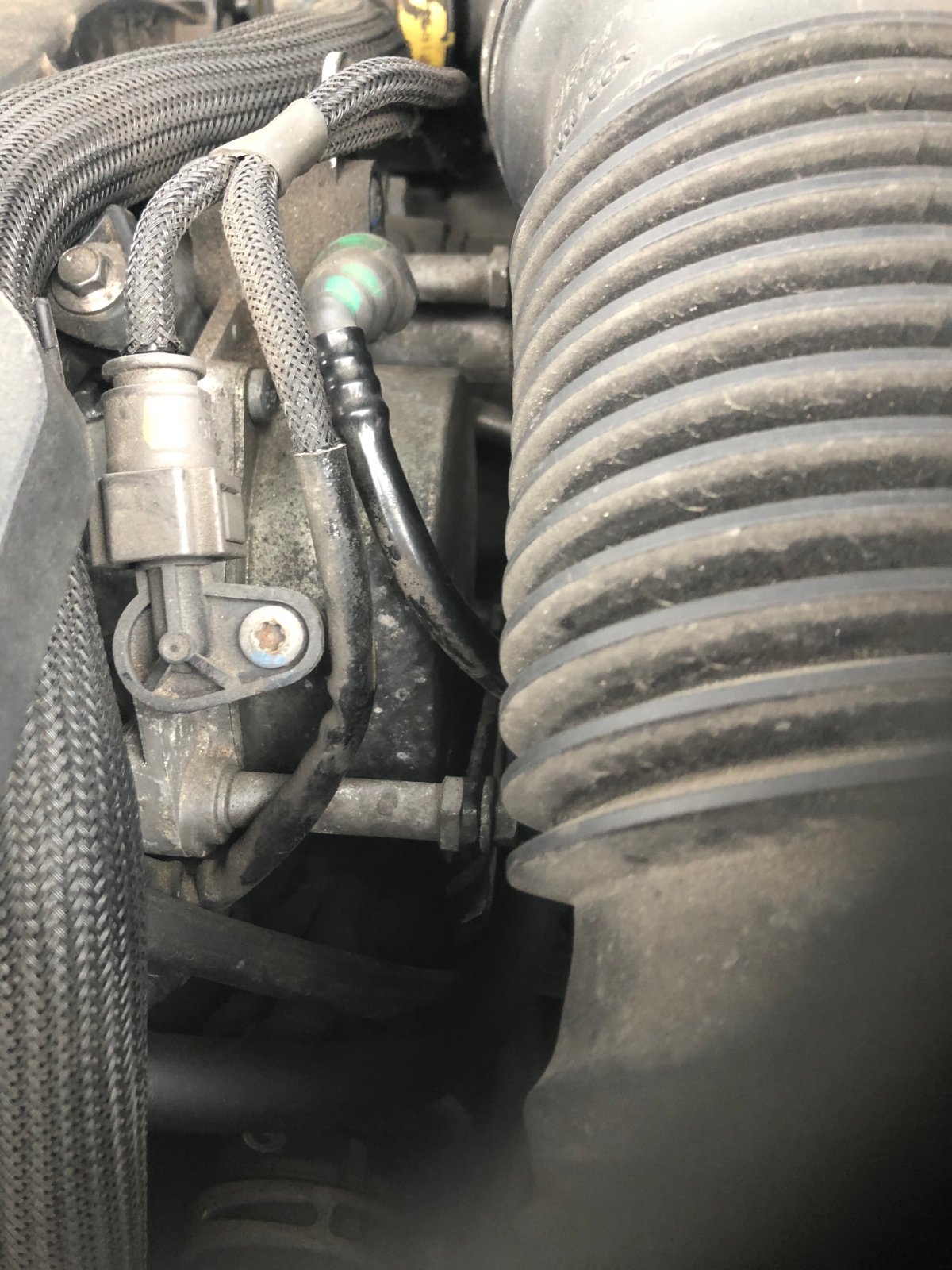

Unidentified hose with a screw in it...surely not factory standard

I think Kenny is right ... Well I hope, it's a breather , the nipple had this hose on it but it baffles me why the put a bolt in it.
Trying to put the engine back as it should be so I can tackle the vibrations I get.
After removing the egr blanking plate I'm wondering what else was changed, hence the question on the hose with a bolt

Do let us know when you've all done your Hercule Poirot number - I'd like to know what that bolt in the pipe is for - as it does look a bit of a Carlos Fandango bodge to me.

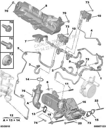

I believe the vacuum hoses for the EGR solenoid have been removed which will need replacing.
I can't see these pipes on your brake vaccum pump
Item 1 in the picture.
Kenny

Finally the pipe with the bolt again I have no idea what is/was for.

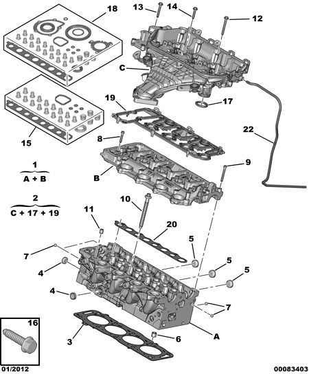

FOUND IT !!
Its called the evacuation pipe, 850 mm long , which is much longer than mine, but I guess there is no need to close that.
I'm not sure if you all use CATCAR.INFO , but is surely has all the diagrams and identification for all cars
Thanks for the help , much appreciated

No, we use the official PSA parts - and we do have this diagram, but it has not been at all obvious what the pipe is or where it was going to, which makes identification difficult remotely on a Forum.
Additionally, that pipe is not mentioned anywhere that I can find so far - so quite obscure, but as long as you're happy!

Yes, that is the plastic pipe which fits onto the cylinder head but my concern is the pipe with the bolt in it.
Where does this come from and where did it go previously or has it been added to another pipe.
