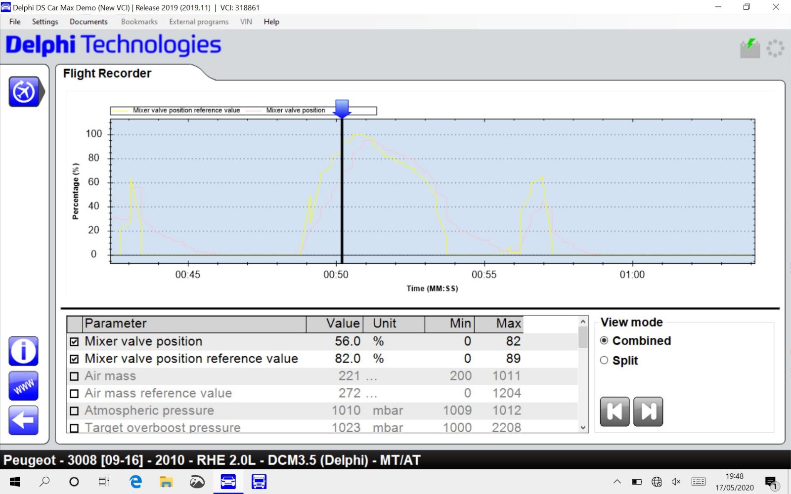

I mangaged to borrow a diagnostics kit from work and scanned the car and saw:
P2125
- Air mixer. Drift on the initializations of one of the two stops
- Intermittent
This code has since dissapeared after a clear.
I ran what's called Flight recorder, whereby you preselect parameters to record and just drive, I picked:
  • Mixer valve position
  • Mixer valve position reference value
Appologies for the colors!
I do not know these cars that well, so I do not know if this is a normal trace for the actual mixer valve position, but to me it appears slow.
