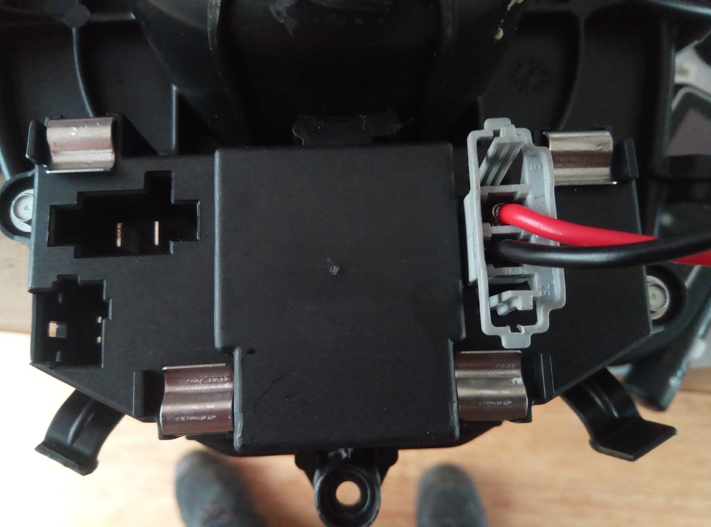

was told by repair centre needed a new fan blower its dead on all speeds plug in new one (£185) no differance at all totally dead - i have 12volts at it on the two thicjk incoming wires but no fan running at all - if i disconnect the fan from the speed control module and put 12 volt direct to fan it runs so for some reason the speed control box not allowing anything through it
questions are
1 how do you test the speed contol box (IS it actually possible for home mechanic)
2 how does the right hand control assembly come out the right hand corner of the dash i can slightly move the top but not much else
I have on the control panel lights on the fan icon that vary as buttons pressed
3 is there anything to put on the two tiny connection to bypass the dash controls etc

It's more likely that you needed a Bower Motor Control Module and not the the Fan. The resistance units inside the modules fail over time. Normally when they start to go it's full speed or nothing.
However, as they are also designed to start the fan off slowly and then increase the power gradually, it sometimes isn't enough to get the fan going - especially as with age, the bearings can start to seize with moisture getting in, making them difficult to free.
If you have managed to get the blower motor itself going directly, then your issue may well be the faulty speed module - this is a common failure across most of the range.
