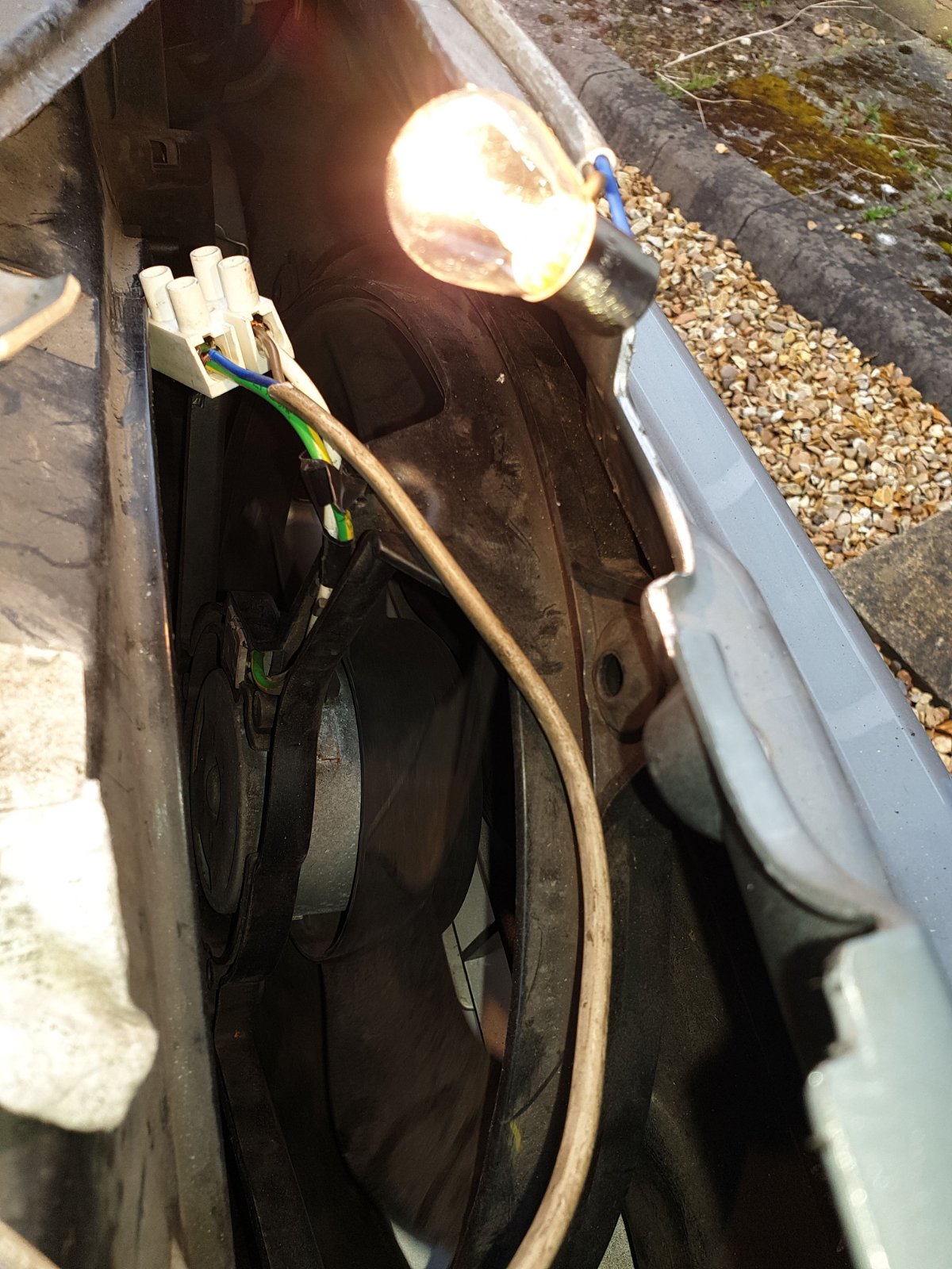

xantia_v6 - Connecting a bulb to the block connector sounds a very good test, wish I had thought of that before I re-fitted the fan. I may give it try and will let you know the result.
admiral51 - I did not remove the plug as it appeared to be fixed and I did not want to force it in case I damaged it.

Its too cold and windy to work on the car today. I did start the engine and press the A/C which again made all the right sounds accept the fan did not move, so I pushed the fan blades which made it spin on its own. Turning off the A/C and the fan stopped. I will remove the fan and connect a bulb to the block connector and see what happens, but when its a bit warmer. I will also take a look at the condition of the fan brushes etc. Although its very low mileage and generally in very good condition, the car is probably only worth £500 even with a full MOT, so its not worth spending hundreds at a garage.

Some of these fans are, I discover, anything up to 500W! At 13v, that's 38amp .
I think yours might be 400W.
Yes, try the small lamp (which should always remain on, even if fan doesn't start when powered up).
It will reduce in brightness a tad when the fan kicks in.
If it goes out, is in any way intermittent, or massively dims, that signifies a bad contact on the supply side (either your temporary supply, or the relays etc.).

I just connected a 12v car bulb to the fan block connector and with the engine running I switched on the A/C. The bulb lit but as before the fan made not effort to turn unless I gave it a gentle push. I checked the voltage across the block connector with multi-tester and got a reading of 14v with the bulb illuminated. Interestingly when I switched off the A/C the fan increased speed quite a bit before slowing down and stopping, something it has not done before. There is no play or roughness in the bearings so I'm still not sure if the fan is weak or its something else, but I need to make a decision soon.

Sticking brushes so not enough power to get up and go once started its ok or not enough power at the plug ?
It may just be my weird logic but is there a plug on the fan itself that plugs into the wires "plug", would make sense as you can change the fans and not interfere with the wiring loom ?
- white exec
Re: Radiator Fan NOT Working Xsara Picasso 1.8sx 2003
Agree. It points to either a bad fan connector (assuming that is a connector), or bad motor brushes.
Next step is to remove and if necessary open up the fan motor.

The symptoms indicate that the motor brushes are sticking in the bruch holders. It would be simple to fix IF you could get the motor apart without destroying it. That is a big if.

Mike, agree, there must be a connector somewhere that allows the fan itself to be removed.
Likely that flat widget on the fan itself.
That should be check out first, and then the fan dismantled if no joy.
Symptoms are a poor contact - either comnection or motor brushes.
