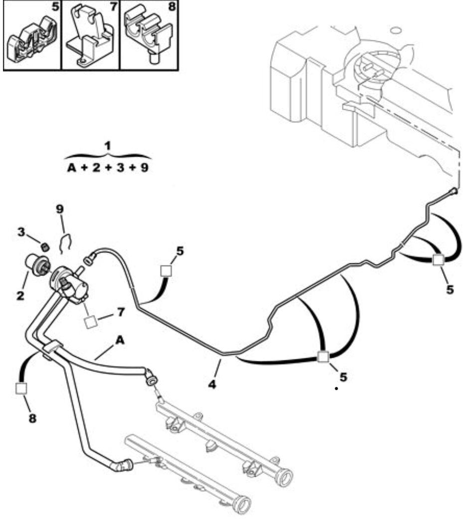

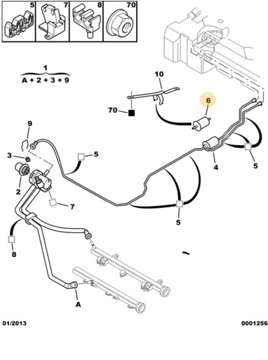

There was one fitted inline between the fuel tank and pipes, but only for countries designated with ‘dusty’ atmospheres. For those with ‘normal’ atmospheres there isn’t one shown.
Without FilterWith Filter (Dusty Atmospheres)
Item (6) on the second diagram shows the filter where fitted.
