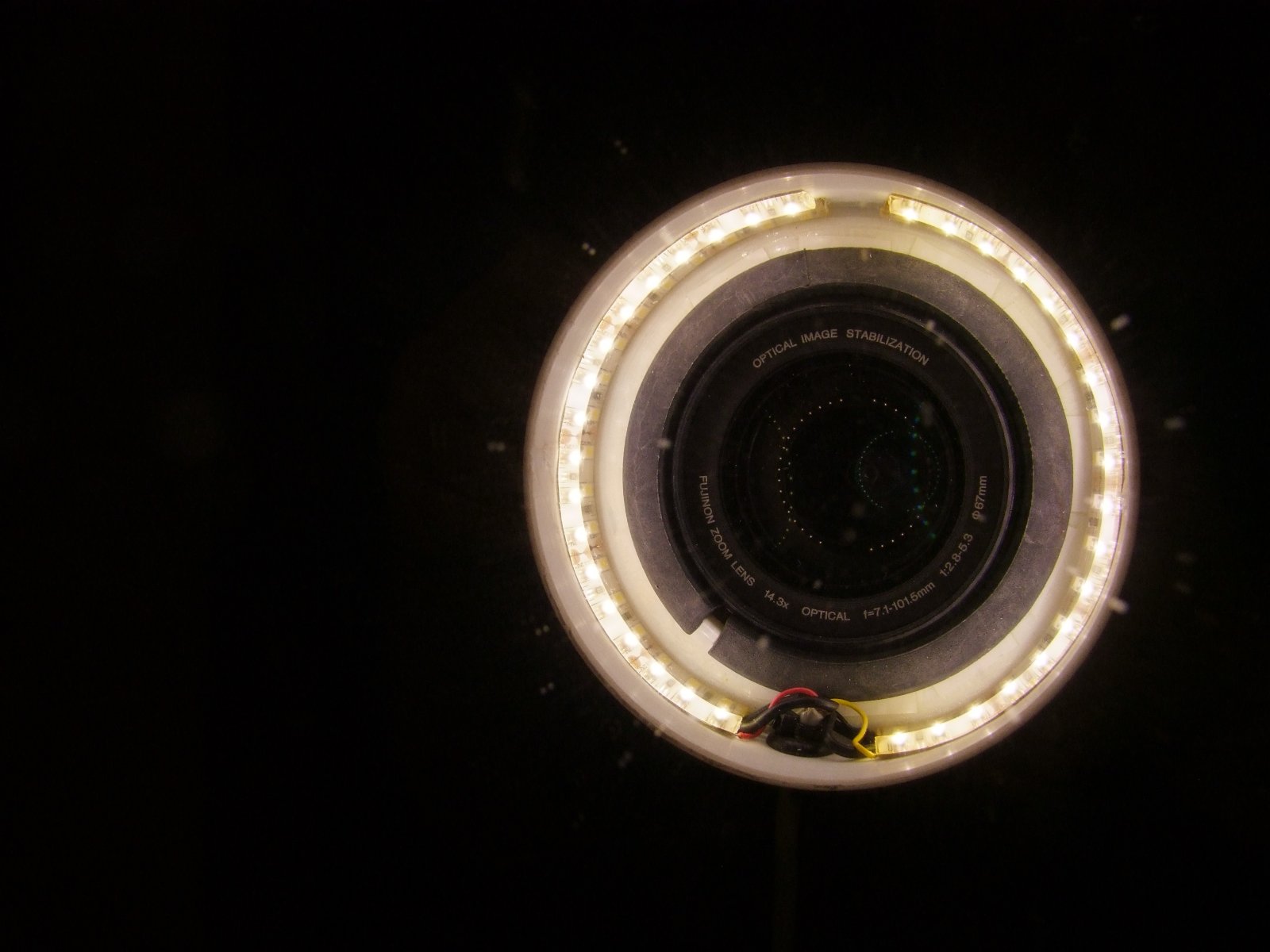

Sometime last year I decided to do something about the difficulty with taking very close-up (macro) photos, where my camera kept casting a shadow when only a couple of cm away from the subject - usually a small widget, and often for this forum, like this one...
sphere damper
sphere damper

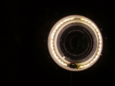

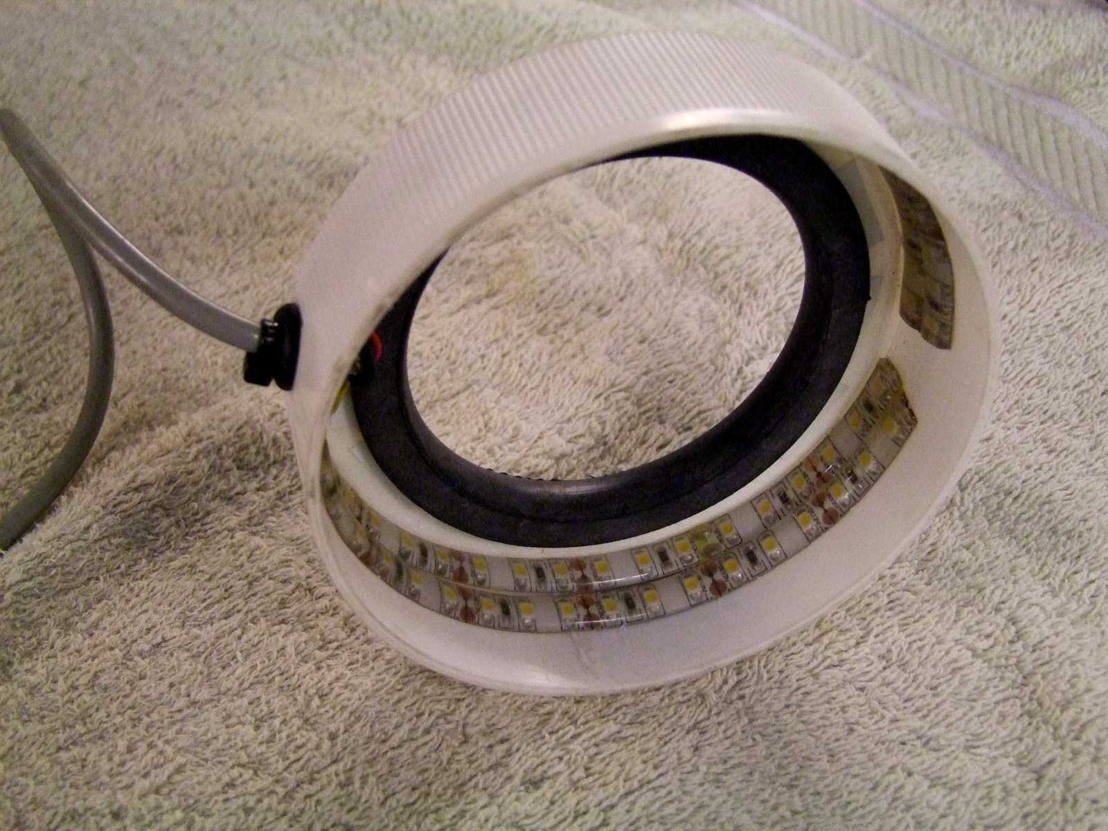

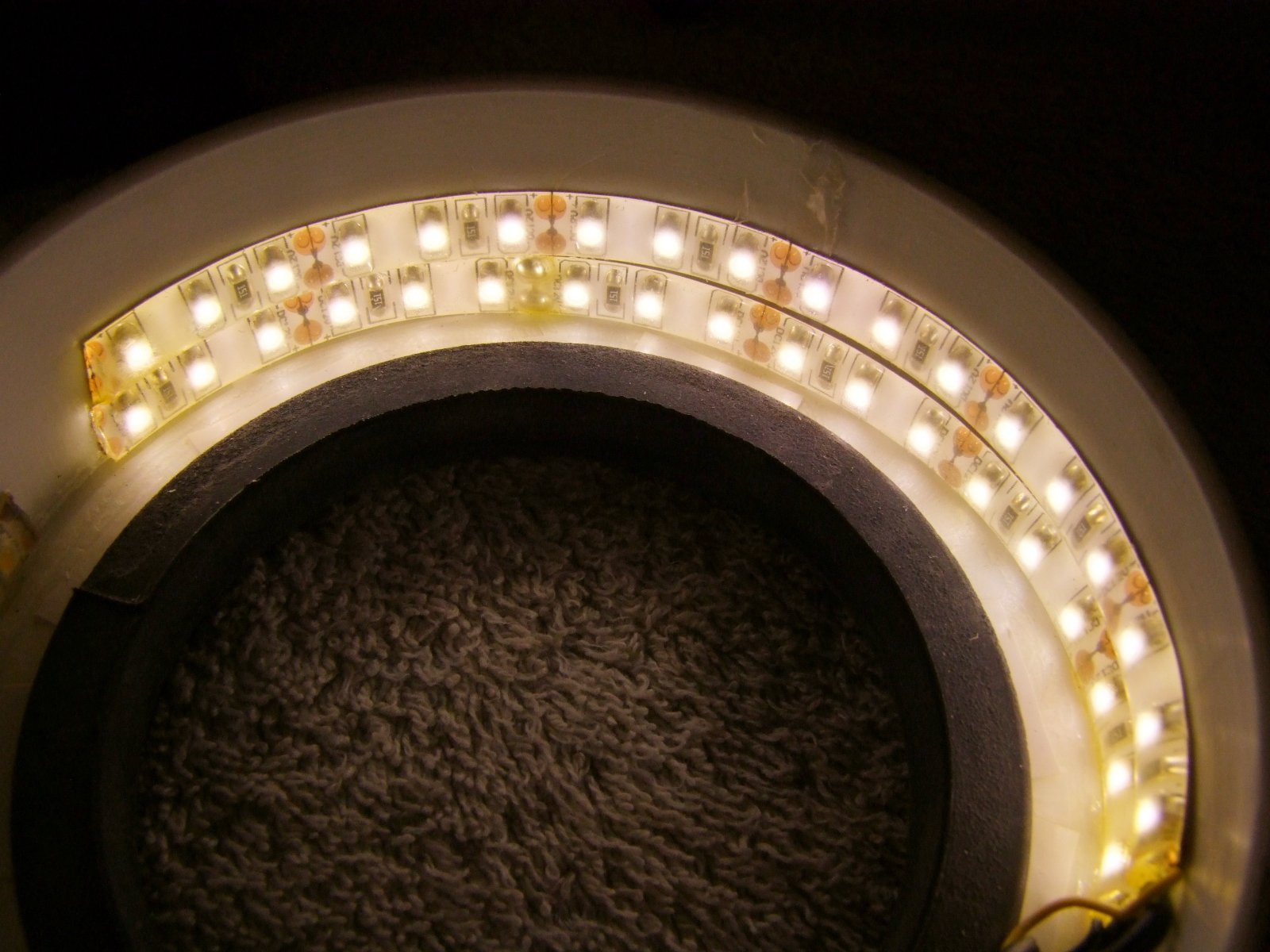

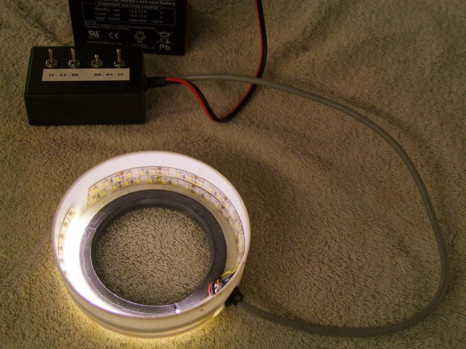

Having watched plenty of Silent Witness and been impressed with Nicky's ring flash, I knocked this up from a large plastic container top, some 12v warm-white LED strip, a few switches and a battery...
A piece of soft grommet edging was used to make it a push-fit on to the Fuji FinePix's 73mm lens front.
The switching simply allows a choice of lighting levels and shadow (left-right) options.
