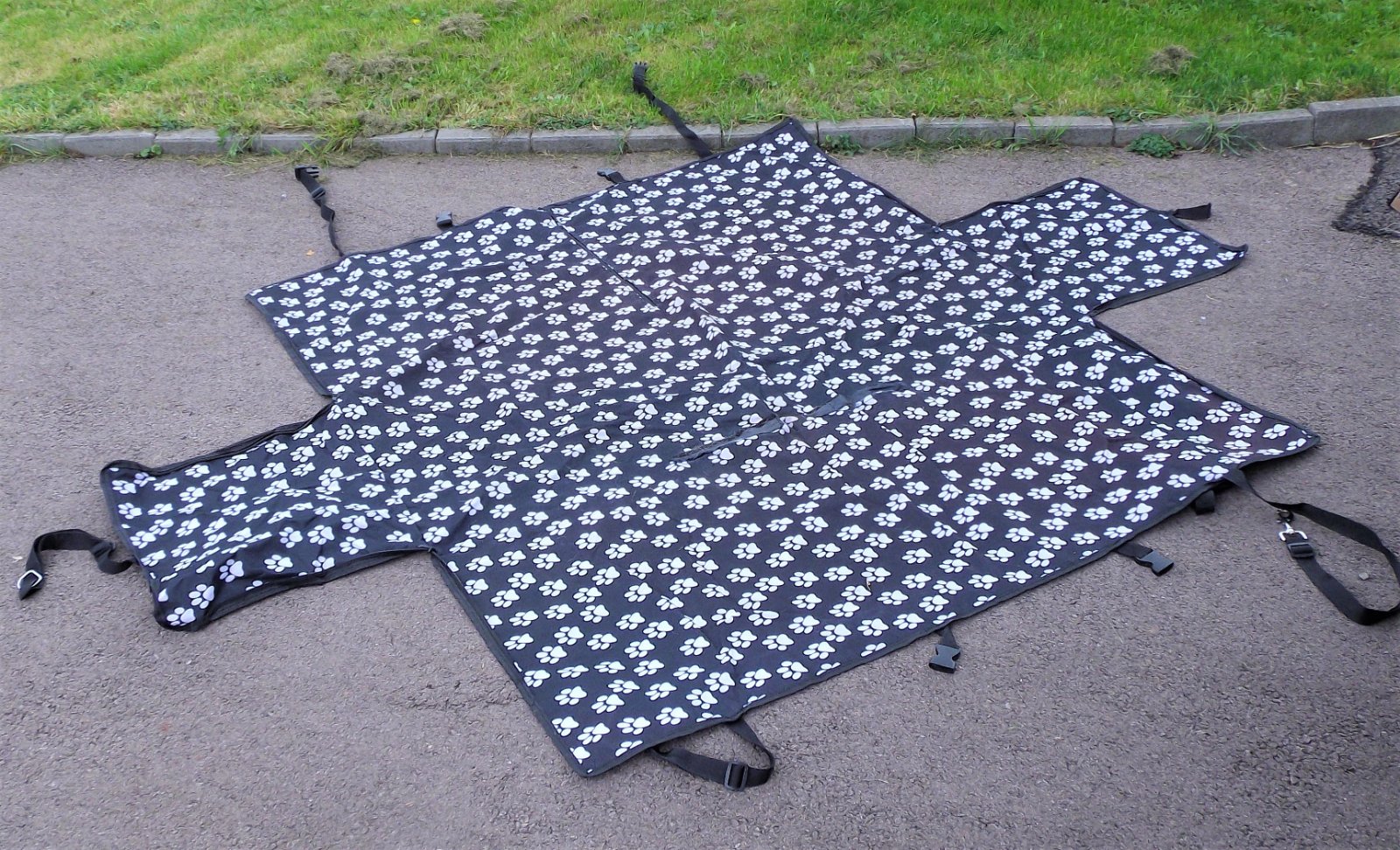

So in addition to the charge cable and tools this is screwed up in the boot, what is it?

it's a dog mat/box liner thingy. it is supposed to keep the boot "clean"
let's hope the pooch was house trained

With those paw prints all over it I guess its a dog cover for the seats or the boot.

If you find any odd stains in the boot it is rubber glove and Dettol time. seriously.

Apart from dust and leaves the boot is clean thank goodness, tools unused and the tyre repair stuff unopened, just gave it a wash to remove all the dust that it's collected whilst going through the long insolvency and auction process.

Yes I figured it was some sort of pet mat.
