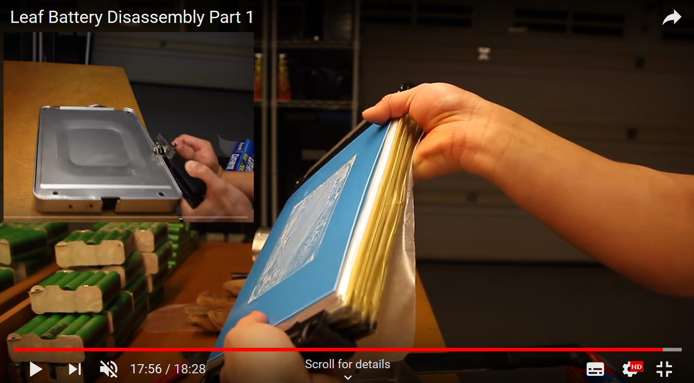

Thanks Steve, its about 10 years since the Nissan Leaf kicked off the "new generation" of Electric Cars with Lithium Ion Batteries. With plenty of 2011 cars still around, and still being used, and with many hitting over 100,000 miles, and very few spontaneously combusting, I think they churned out a pretty reliable and well engineered product. Advances have obviously taken place over that time in battery chemistry making newer offerings with greater energy density, larger capacity packs, and in battery management systems.
After watching a similar video I was surprised at what was inside the "sardine tins" as posted in my first post on the battteries thread. The cylindrical "normal-looking" familiar battery was plumped for by Tesla, and they have persisted with that approach although use of BYD "Blade" batteries has been speculated on for some versions of TESLA cars and possibly the much trailed "Model 2" $25,000 TESLA.

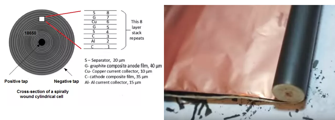

NewcastleFalcon wrote: 29 Dec 2019, 13:54 Watched a video about the nissan leaf battery pack being disassembled, and was surprised to see what was actually inside of the 48 "sardine can" modules, when the youtuber sliced one open with a can opener...literally![]()
I half expected to see a collection of "little" conventional looking batteries inside the tin but no.....this
Looks like a bunch of envelopes inside plastic pockets. There are 4 separate "cells" in the bundle.
Now inside the steel tube of a Panasonic 18650 Cell widely used in TESLA battery packs there is a curled up matrix of layers bundled up inside a small tube, rather than being laid out in a large sheet within a sardine tin.

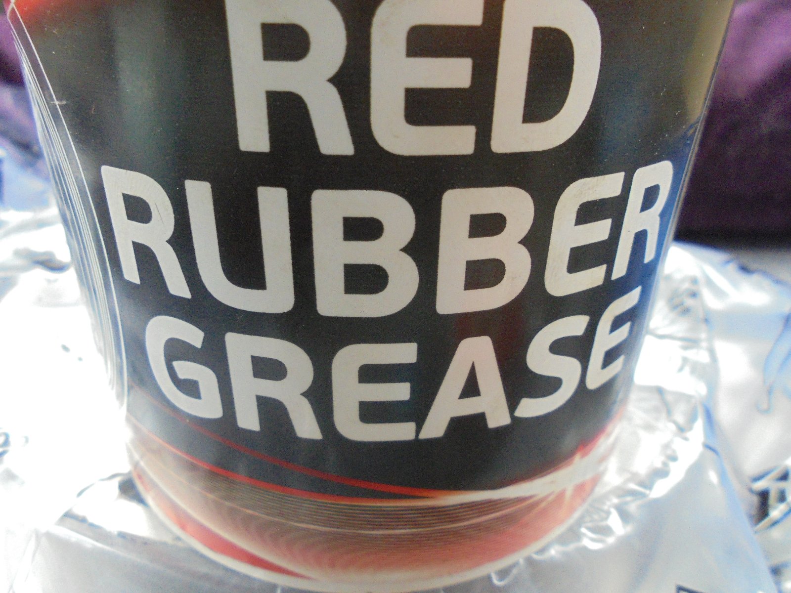

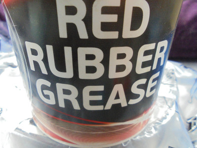

Today I have taken the first steps to being a Red Rubber Grease tycoon.
With a quick cost benefit analysis, a big tin in the hand for just over £10 from the Agricultural engineers was a better deal than spending at least £6 in petrol consumed, and probably 1.5 hours, going to the nearest factor who would have something in stock and paying another £5 for a little tube, or a few sachets.
When I said thats a big tin, the guy at the agricultural engineers said..."What you really want is a bit from our tin".
Couldn't do it, far too cheeky
Always good to cultivate a decent relationship, and over the years their Aladdin's cave of stock has saved me a fortune.
