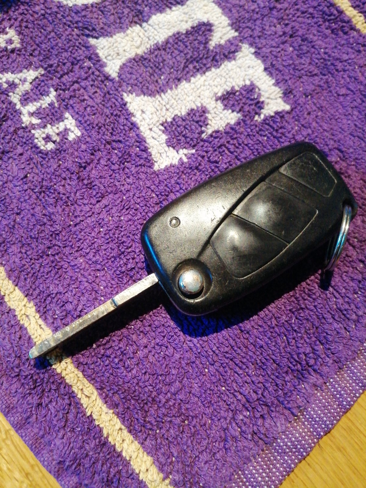

Ok so to explain - these vans are basically FIATs! So they have different audio and immobiliser setups to standard PSA vehicles.
When the ignition is switched on, the engine management ECU sends the fixed code to the immobiliser unit (Electronic ECU Box).
The immobiliser unit sends an electrical signal to the aerial.
The transponder coil (ring around ignition I linked to in a previous picture) sends its code, via the electromagnetic field, to the key transponder (chip in the key).
The key transponder responds by sending its identifier to the immobiliser unit via the aerial.
The immobiliser unit sends its fixed code to the engine ECU.
The engine ECU checks the immobiliser unit’s fixed code and authorises starting of the engine.
The immobiliser LED extinguishes.
On some fobs the transponder chip is inside the fob electronics - if you have just a flat key, the transponder will be on the plastic holder somewhere. But the point is once the transponder chips in the keys have been coded, they cannot be reprogrammed for use with another vehicle. So you have to keep the same key that contains the transponder to use with your vehicle's immobiliser unit.

I think I'm right in what the guy told me the other day that he can just change the blade. So my thinking is, new ignition barrel, new keys. Get new blade cut for this key, happy days??? Then back to the original issue.

Yep, if you keep your fobs and just replace the blade you will be fine - but as I said before be very careful of the transponder coil which sits around the barrel.
