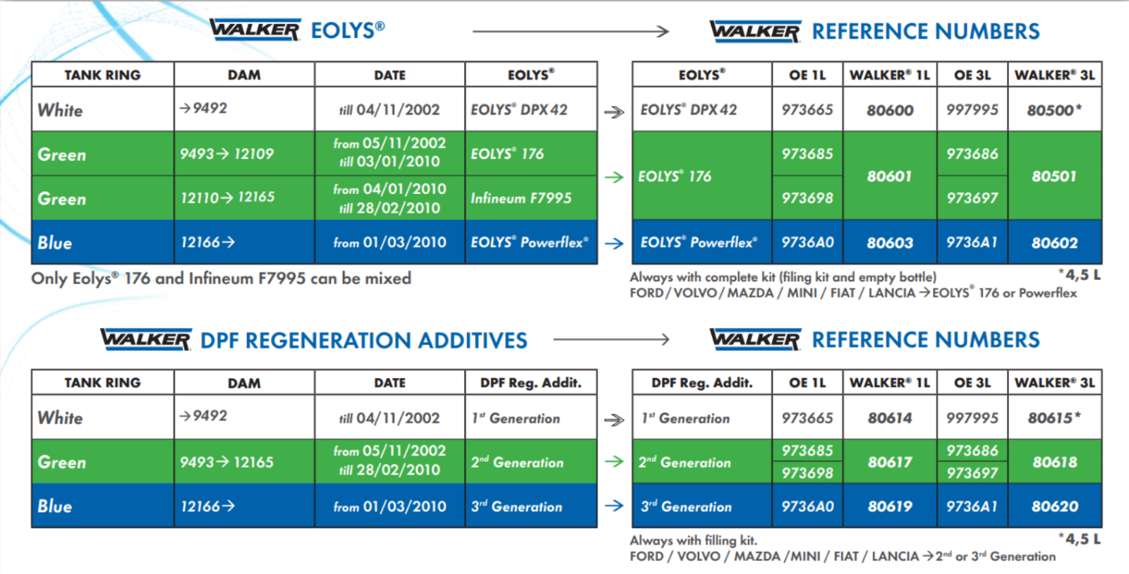

cornesoutafrica wrote: 22 Dec 2019, 21:00 Hi Marc.
A question. The correct Eolys fluid. If I remember there correctly. There are a few different versions? What type do I need to get?
Hi Corne. Your build date is 11097 and your have a Euro 4 engine, so you need Eolys 176 or Infineum F7995.
You should have a green click fit connector.

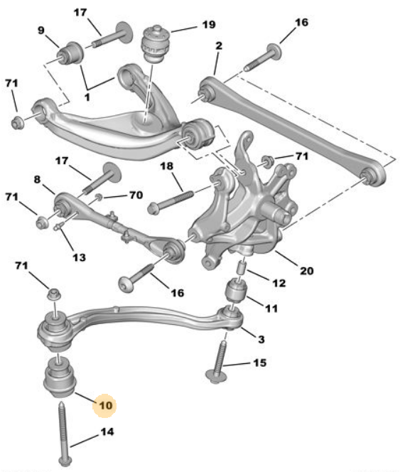

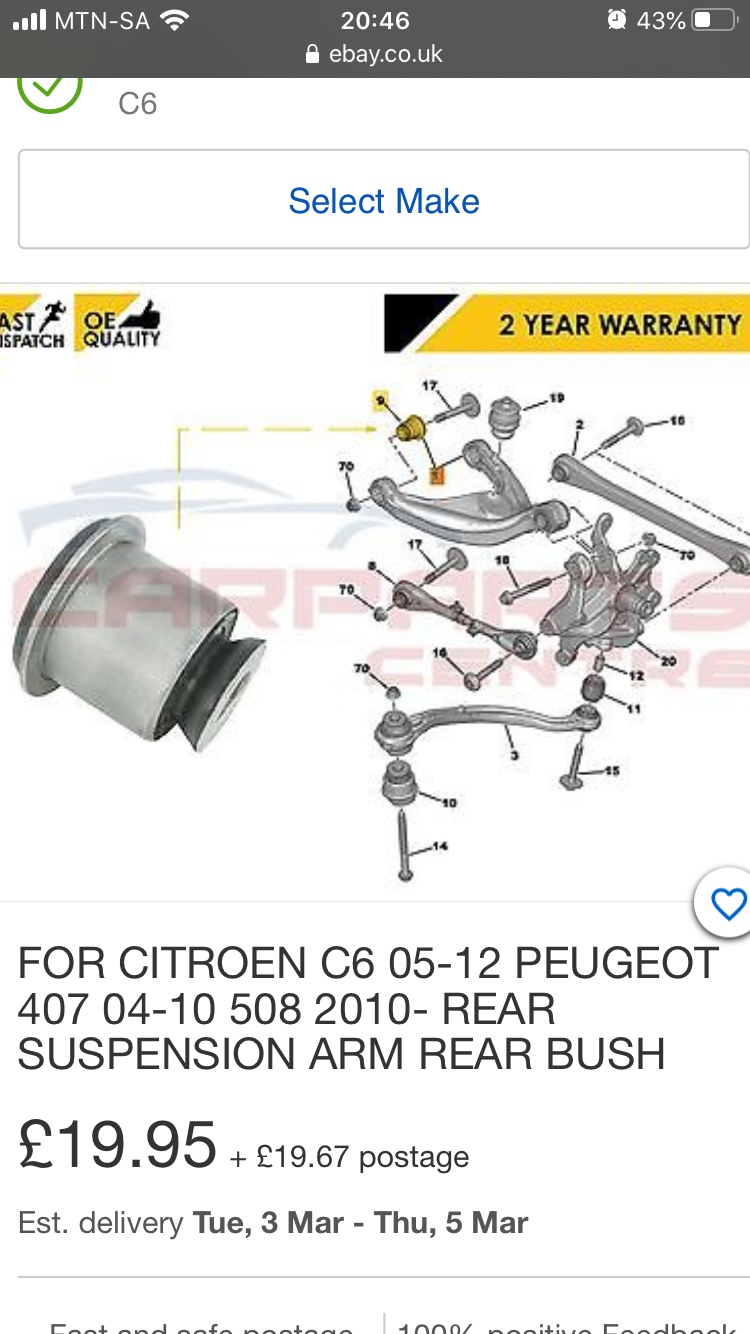

Seems like I have to do some more maintenance as per usual. I noticed that the rear suspension bushes need some attention. I am unsure if the arm is called the rear lower control arm but in the picture it is number 10 and 11 I need the rubber bushes for. What is the correct name for them? .
Im trying to look for the bushes on fleabay but it’s been difficult to get.
Posts: 42019
x 6918
Re: The first Citroen C6 in South Africa aka ‘Eloise’
Hi Corne. Both are called Rear Suspension Flexible Joints ( :-D ) funnily enough.
(10) Part number: 9801049980 (note the original part number was 5131C4, but since superseded)
(11) Part Number: 5131C3
