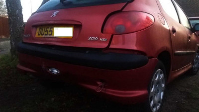

indeed yes, and this one 'd be all the lovelier if some [bleep] hadn't shunted it yesterday!!
Two owners from new, living in the same little Close, then step-daughter gets it, does only 400miles in it and now its a write off. I'm going to investigate the practicality of having it for myself, in particular with regard to Insurance; as its too good an opportunity to miss, even if it is a bit small....
...if all goes horribly wrong with the 405, it'd be an excellent little stop-gap, including to get me to to the South of France to find another one.
Damage is limited to the Boot Floor and possibly the Bumper (no creasing to the rear wings or roof) so could well be an easy fix; and it'd be a damn shame for such a mint motor to meet the Crusher, it really was in outstanding nick.
Anyone interested, if I choose not to have it (ie if insurance cost is prohibitive), put your hands up.... further info will be made available if relevant.
Other party's Insurers (Gold Star for E-Sure) have at least acted swiftly and daughter already has a '19' plate hire C3 to run about in for now (a sea of plastic, much of it cheap & nasty looking... and a tappety sounding engine despite only 9k on the clock - surely its not supposed to sound like that, I must be mistaken...)

Ouch, what is it with 206's getting rear ended lately? damn shame, but at least the other driver stopped and insurance are stepping in for you. If you do get the chance to buy it back give me a shout if you need any rear end parts, obviously the parts car bumper is already spoken for but the only other bits I'm taking from the bodywork are outer quarter panel/lamp recess and inner arch supports I think. (the parts car is China Blue, '04 plate).

Ouch, similar angle to the 206 wheel before I pulled it out from under to move the car! What's the betting that RAC van met it's fate on a motorway hard shoulder trying to help someone, thanks to someone either asleep or on the phone?

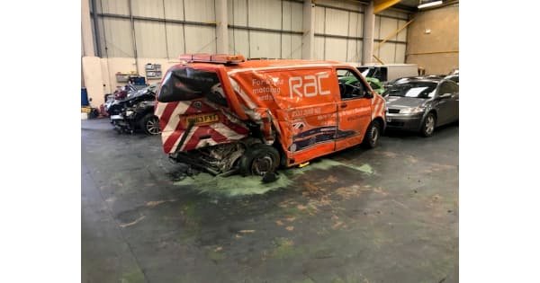

The RAC van features on the TV motorway programme, the driver said he'd parked it behind the broken down vehicle two car length back with the wheels facing off so that if it got bumped it would steer off the road
It was hit so hard that it flew in the air and landed on its side.
Can't remember which show I was watching but it was only a few days ago.

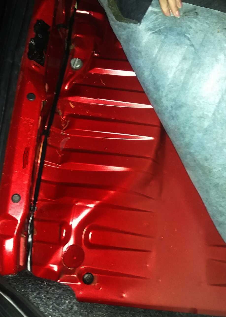

Its not actually been written off as yet, but photos have gone to the other party's Insurers and no doubt it soon will be. I'm keen to have it for myself while I do the engine swap on my 405, coz as much as I'm hoping it'll only be a few days, I'm also aware how these things have a bad habit of 'growing' Any thoughts whether to attempt to belt out the damage with a big hammer & drift, or to cut out the damaged boot floor and weld in new? I'm inclined towards the potentially quicker Hammer method if its likely to be reasonably effective...

Short version is I'd want to repair that properly with new panels if I were thinking of it's long-term future as a tidy nicely cared for car, you could likely bash/pull it out to where the tailgate would shut, & fix the foglamp and still pass an MoT with not much in the way of repairs but if you could stand forking out for another 206 as your stopgap (with short MoT and rust/rear axle issues looming as that kills prices) then you would have all the parts needed ready and waiting once you'd got the 405 reliable once more & could end up with a very tidy, cheap to run and super reliable spare car for not much money at all.
Of course this is just from looking at the photos & maybe it looks worse than it is. Considering that a repaired write-off would be hit in the resale value a "proper" repair might actually be a silly idea if you can bash it vaguely into shape and have the hatch close/seal ok. Just be sure the "chassis" legs aren't kinked at all since that may be a safety/MoT issue & I notice the towing eye has had a whack, fortunately avoided on ours.
Sorry I've not been much help have I lol, my instinct would be try to make it right and have a nice car but not sure if there's any real-world point in having a mint boot floor?

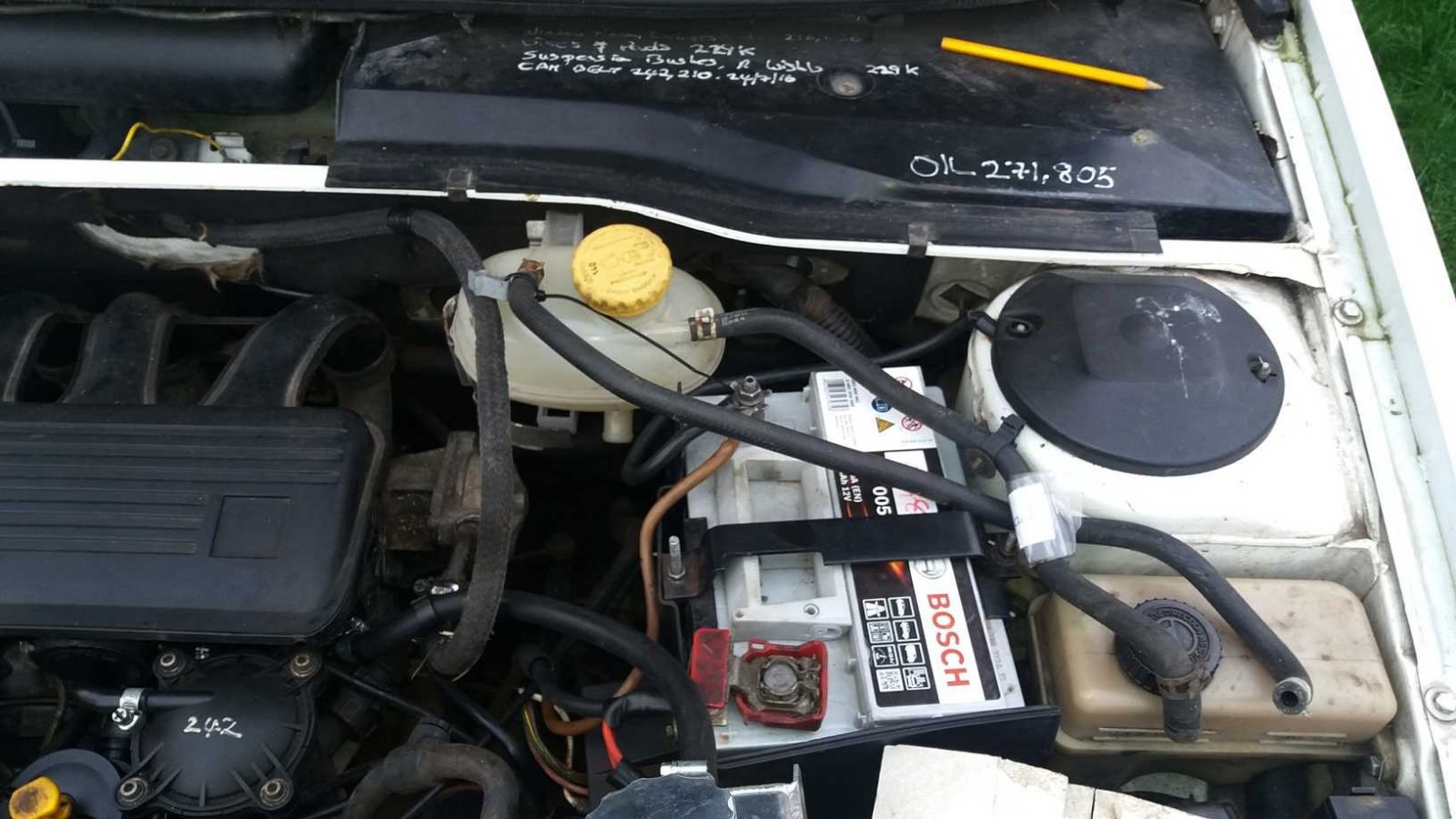

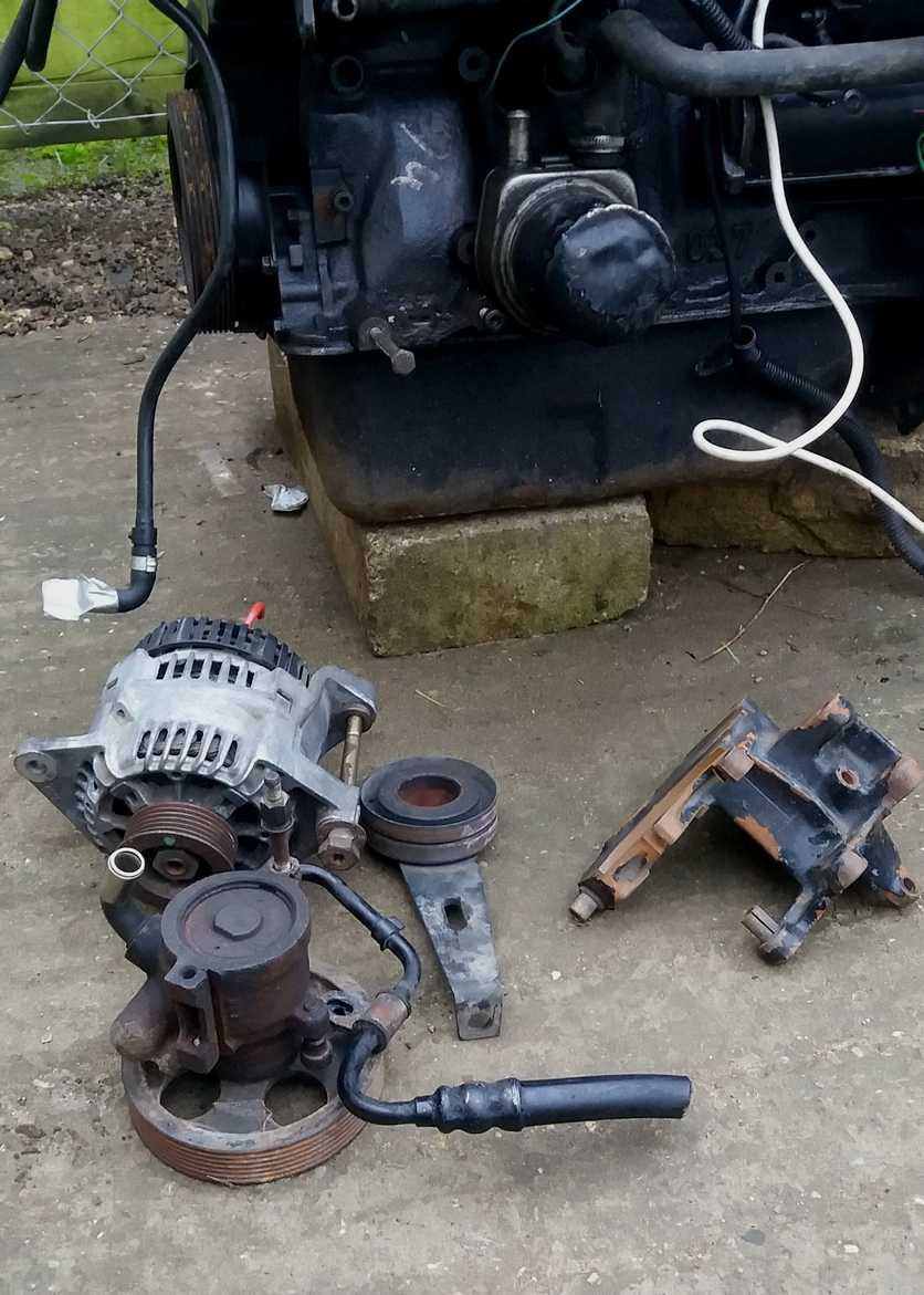

Getting Back on Topic....
some progress with the engine
PAS Pump and Alternator fitted with suitable Cast Iron mount (which could really do with a coat of paint), Aux Belt and Lollipop. These might come off yet, but I wanted primarily to ensure that I had small parts such as fixings 'readily to hand' when it comes to final fitting.
PAS Pump has a replacement 'feed' pipe as this will be lower down in the engine bay than it was previously with the AC & PAS set up
Also fitted is wiring for
Glowies
Stop Solenoid
Starter Solenoid Its not yet got a Fuel supply, but hopefully with a feed from a Gallon can and priming; it'll fire up.... I'll probably give it additional support from the Hoist too. It appears from turning it on the Starter that its inclined to 'fall forward' (ie onto the alternator, rather than onto the Inlet Manifold) hence the placement of the two bottle jacks.
...oops, only one at the time the pic was taken, there's a second under the Bell-Housing.

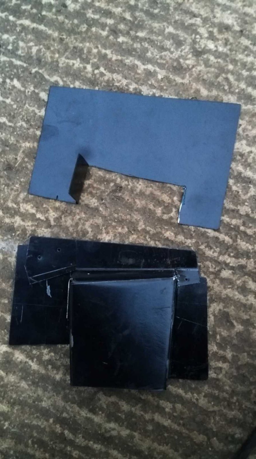

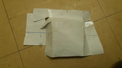

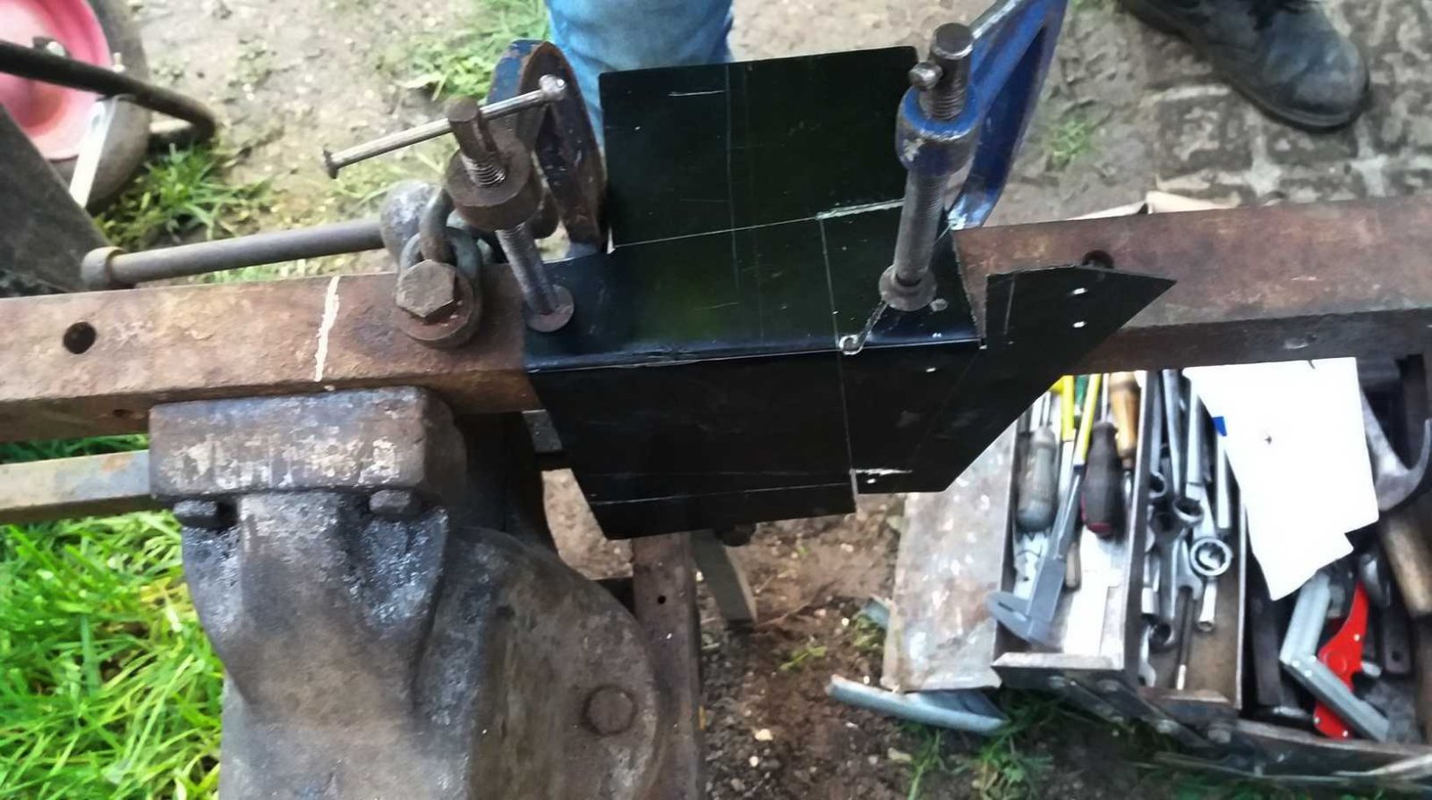

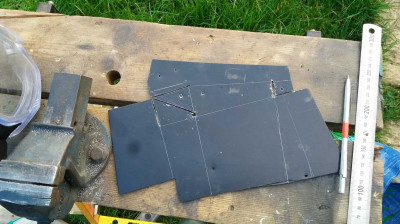

Meanwhile, I've also been making bracketry for the Corsa Header Tank, the 'main' one will go behind the Vauxhall Bracket (not shown). The 'extra' flat-ish bit is intended so that I can temporarily 'hang it off the top of the Bulkhead' a bit like you would with a Picture Hook
Its still 'madness' here with Daughter's car search having re-commenced. The 206SW owner kindly let me out of the deal without penalty when the MOT it was agreed it'd be sold with showed up Advisories regarding 'Exhaust Gas Fumes from an Injector' and play in the Steering Rack Inner Tie Rods...
...there were some trifling 'Fails' too of no great consequence, that he was happy to sort.
but I wasn't really sure how about how serious fix the leaking Injector issue could be. Something I'd read about 'Coal' setting rock hard when an Injector leaks seemed potentially very worrying and I could do without an awkward Inner Tie Rod job in a year's time, both sides of the Rack.
...so the search is back on. And there's not much out there. A Nissan Micra 1.5DCi is possibly going to be viewed soon. Anyone know what the Nissan 1.5 Diesel is like, in terms of common issues / reliability?
