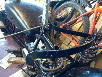

Then I moved on to the saddle front mount. Dug out a few bits, and lashed this up. I'll cut down the supports, and then the 8mm bar, will need to get some nuts to spread out the supports. Then I need to decide which way up to fit the springs (you will note they are opposite ways up!).

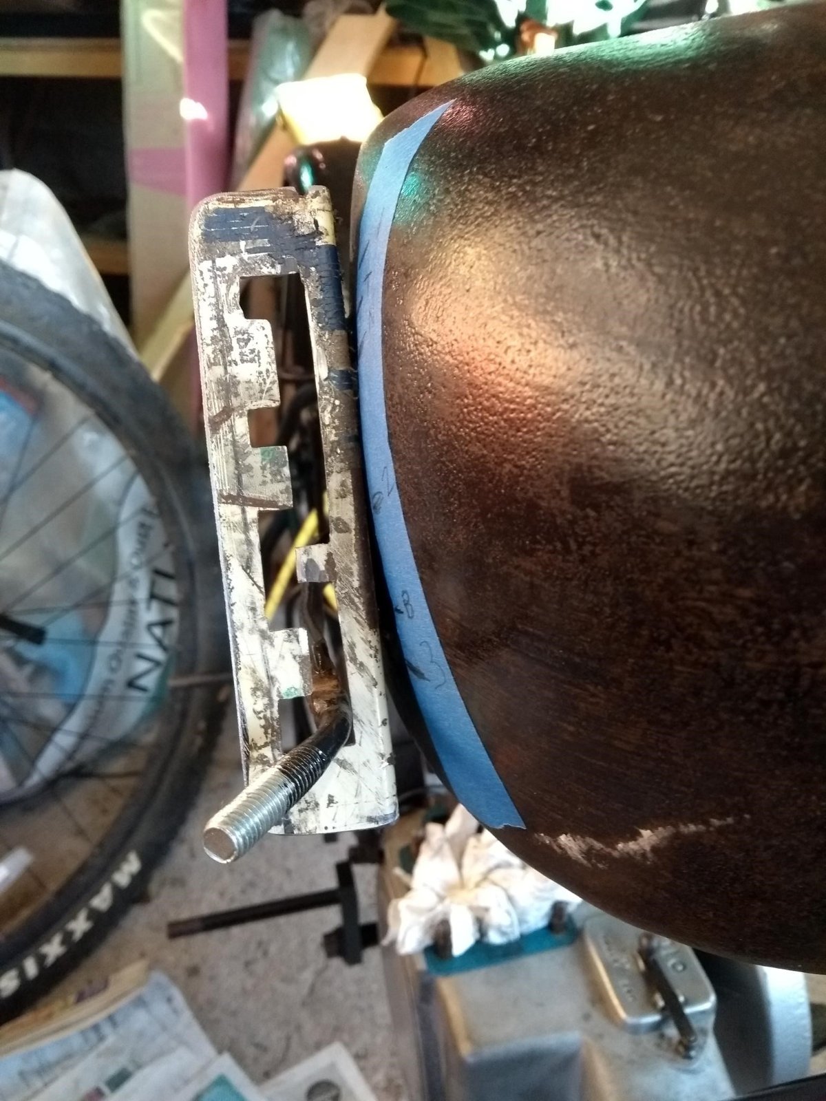

Next moved on to the gear change gate. Found a piece of old shelf bracket which was close to the right size. Mocked it up with some cardboard - pretty easy to feel where the gears are, and then I marked the positions on the blue tape on the tank.
Moved it onto the steel and roughed it out with the pillar drill
Then after some effort with the files...
Wasn't really in the right place first time, and I couldn't get top - then realised I had done it with the adjuster on the gearchange (the bottom of the vertical link is threaded into the clevis pin) right at end. So I slotted the holes on the back for tank mounts, then adjusted the link to the centre, and it seems to be not far off now. I need to sort out the pivot, but I can do this when it comes back.

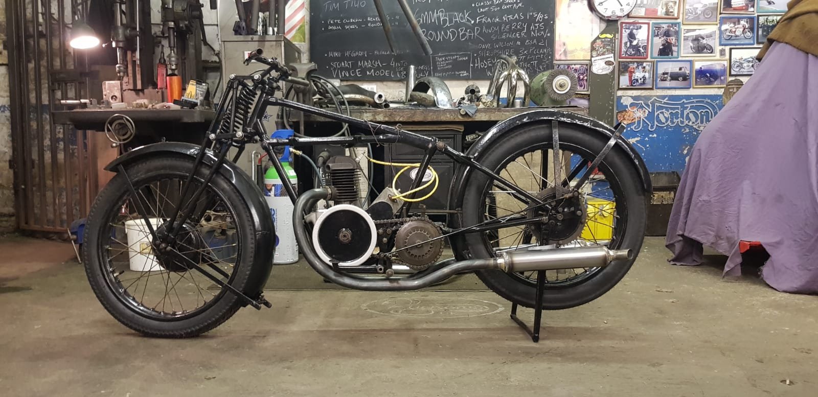

Progress on the exhausts
- Donor 2020
- Posts: 1031
- Joined: 12 Jan 2015, 17:08
- x 134
Re: RichardW's Velocette rebuild
They look really good, how's the engine going? PS Love the Norton plaque, I worked there as a kid in Shenstone
