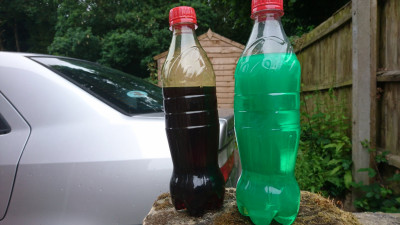

Just as a side note i will post pics of the LHM that was taken out of the tank and i am not joking when i say that i have removed cleaner engine oil from a car.

Can you guess which is fresh LHM and what i took out of my Xantia

The bottle on the left looks almost as bad as the transmission fluid that came out of Mandrakes' previous Xantia V6!

Hell Razor5543 wrote: ↑02 Jun 2019, 17:38 The bottle on the left looks almost as bad as the transmission fluid that came out of Mandrakes' previous Xantia V6!
I promise hand on heart the one on the left came out of the LHM tank, dreading to see how bad the stuff is that comes from bleeding the brakes, that will not have gone through the filters
Re: Once Again I Own A Xantia
That looks more like cola and washing up liquid.

Don't leave that stuff lying around in those bottles, kids have been known to take a swig and come to some real harm.

They are locked in the shed taken out for the pictures and put straight back
