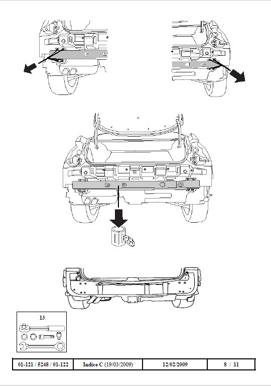

Seven years ago a Witter towbar was fitted to my C5. I got a fitter to do the job on my drive so I was with him all the time. The only part that was removed was the bumper. Certainly no steel bar.

You can just about reach in behind the bumper with a screwdriver and lever down the clips which then allows you to pull the bumper out easily. They're not easy to get at, and it's easy to break them off. I think Citroen must have a special tool - you need something like a screwdriver with a curved blade on the side.

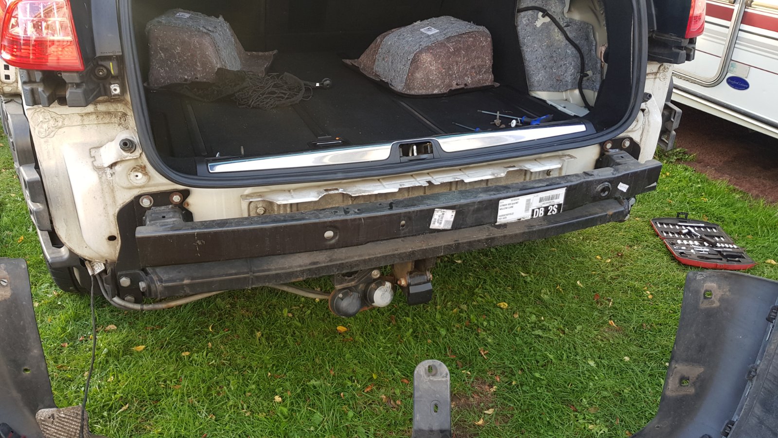

This is mine.
Re: C5 x7 tourer rear bumper removal
Update: I have had the bumper off tonight. Came off easily following the instructions. Thank you to everyone that helped. (So far)!]

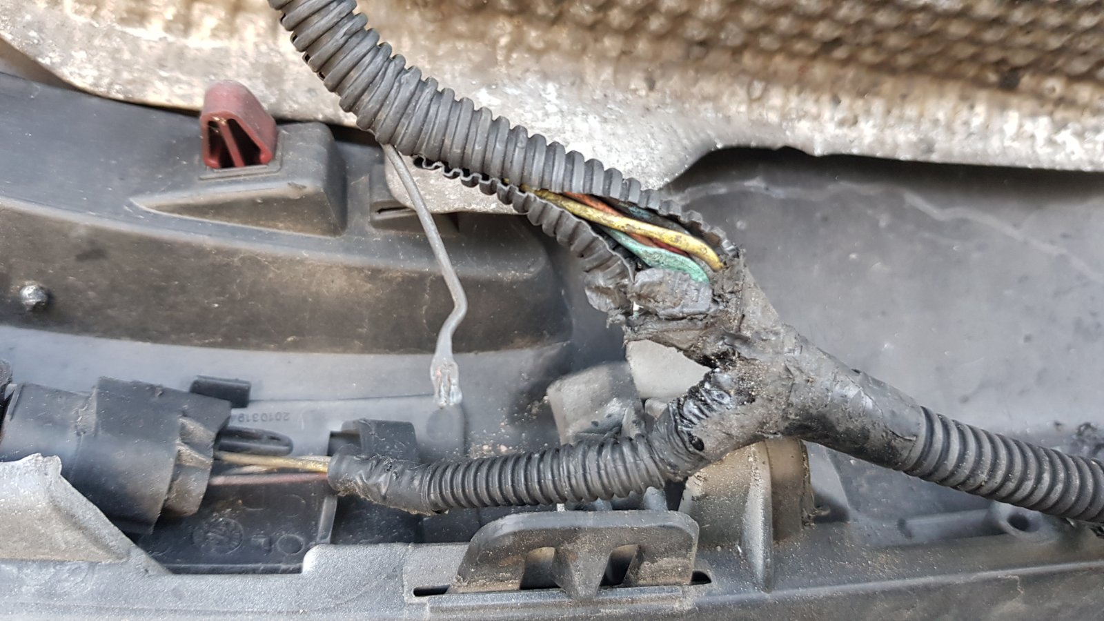

Good news is, My parking sensors are now working. Found a damaged sensor and the loom had been trapped cutting the wires. 20mins with the soldering iron and replacement sensor.. Job done.
